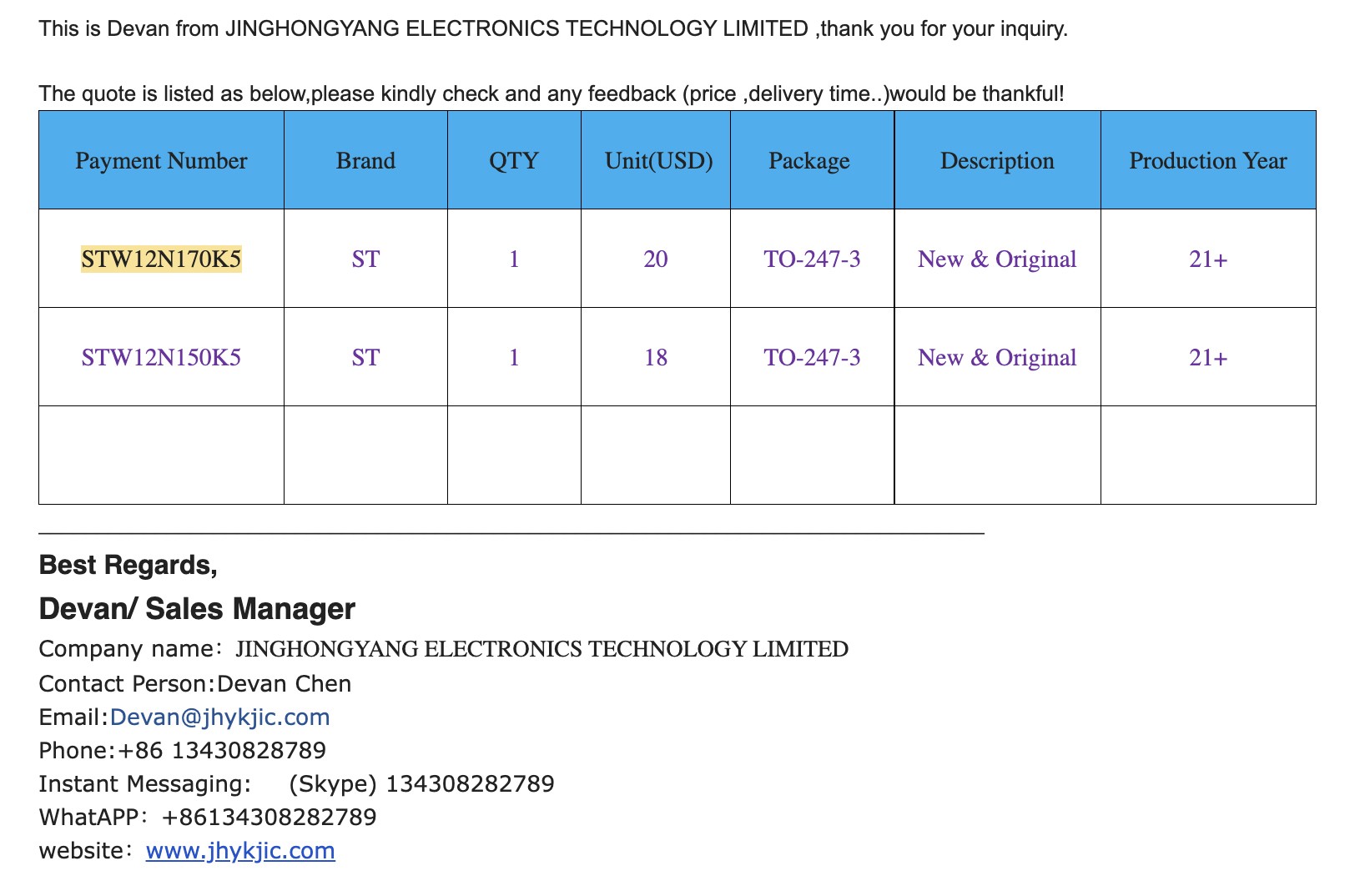

              • #22
                Hi Julian,
                I ordered the 1800V diodes from the Aliexpress link you posted, thanks: I figured for the money they cost there I shouldn't doubt and just buy them.
                I did a RFQ for the 1800V diodes and the 1700V & 1500V mosfets at jhykjic.com (from proper manufacturers). I'll see what they come back with. Jinftry could supply the 1500V mosfets, but not the 1700V versions. If jhykjic.com can't either, I'll just go for the1500V versions.

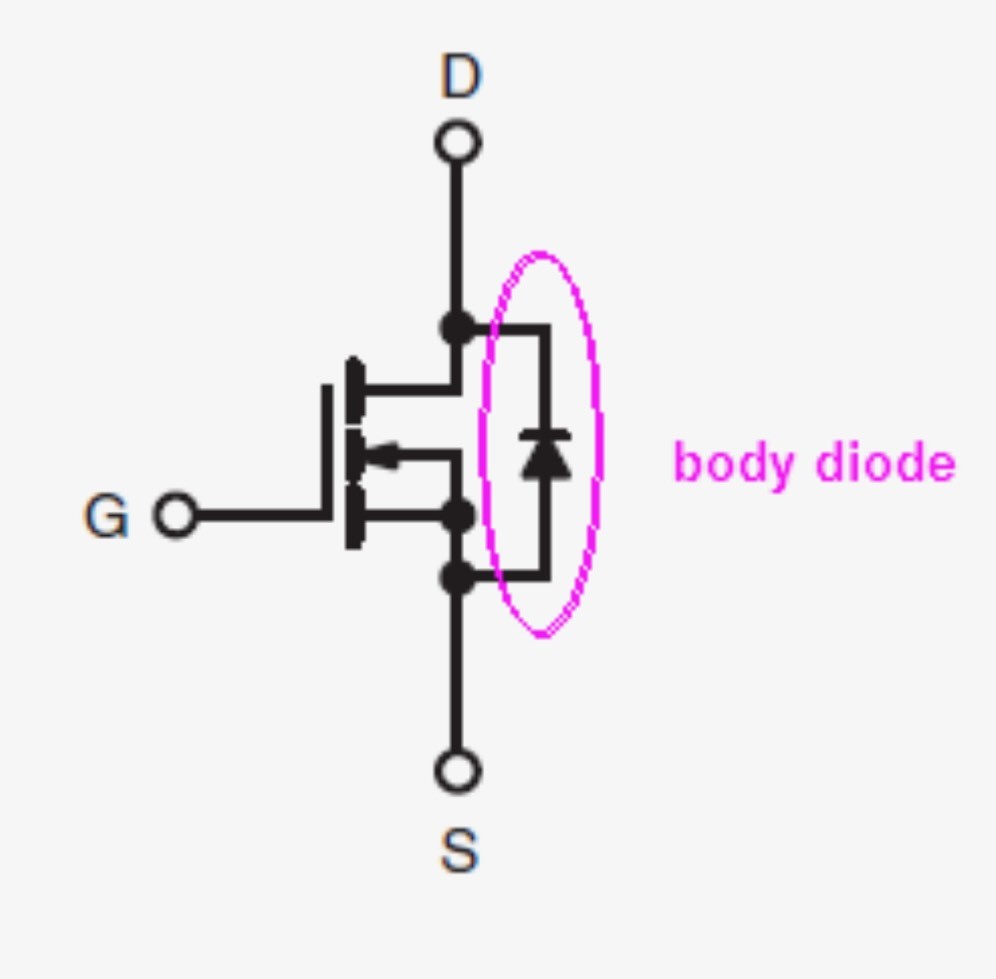

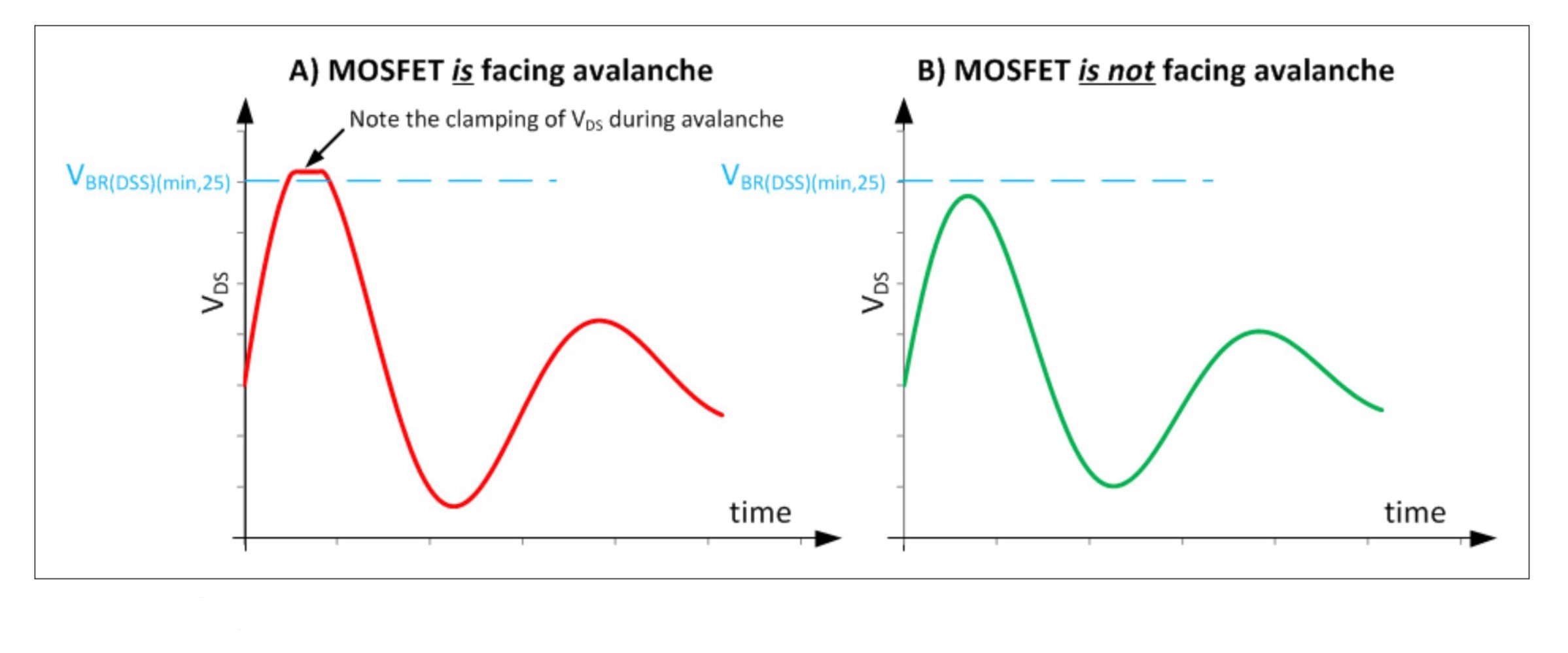

                  • #24
                    Hi Rodolphe,
                    I’m not an electrical engineer but my understanding on this is that all MOSFETs have an internal, also called body or parasitic diode, by virtue of the PN junctions that are part of their innate structure. This is shown within the symbol for the FET on the right hand side (see pic).
                    The role of the body diode is to allow a current path to ground during the period between switching on and off to release the charge collecting at the junction and is particularly relevant when switching inductive loads. However, they have a slow response time that can cause a significant build-up of charge at the junction and with associated problems, depending on the circuit you have and the application.
                    Adding an external fast recovery diode, thereby shunting the body diode in parallel, will release that charge more effectively than the indigenous body diode and usually prevent the body diode from ever having to switch on.
                    For regular power switching, where you don’t want the flyback pulses appearing at the Drain and causing problems (EMI etc) then often another diode is used to discharge the ‘damaging’ pulse and which the body diode can’t do since it's being reversed biased.
                    Alternatively, many of these active devices have an 'avalanche rating' whereby over a certain voltage they break down to discharge the pulse to ground, This is shown in the other graphic. This latter feature is the limiting factor in the peak flyback pulse voltage as I have mentioned elsewhere.
                    Of course, we do want this pulse so we don’t add an additional, above-mentioned diode across the inductor to discharge it to the battery (as is shown in this video: https://youtu.be/6YOctFtOuwY). Please note that this video does not make reference to the spike that results from the coil switch-on but focuses on the one at switch-off.
                    You might reasonably ask why we don’t do that as the pulse will still arrive at the battery. I believe the key answer here is that shunting the coils with a diode would prevent the spike voltage from building up to the 1-2kV that we do see and want and instead clamp it at a low value, along with a small amount of current. This is a very different result from delivering a high potential pulse directly to the battery terminal which is what we need to elicit the ‘phenomenon’ at the interface of the pulse and the electrochemistry.
                    So instead we let the voltage spike exist as a pure voltage potential delivered to the battery terminal instead of using an additional diode across the coil, as shown in the video, which would inevitably change the type, quality and magnitude of the pulse arriving at the battery.
                    However, we are still limited by the FETs avalanche rating and, if the FET we use didn’t have such a rating, then it would be easily damaged by the very pulses we seek to use.
                    So to summarise, an external FRED, Schottky or another type, is added to support the discharge of the pulse energy generated during the FET on duration and which would otherwise build up as charge at the Drain-Source PN junction. This is due to the slow response of the body diode, which is not optimised for this role, and is not there from a deliberate design choice but on account of the way the device is constructed.
                    I hope that gives you some clarity.
                    Jules
                    PS. I'm busy writing the assembly manual and so will be limiting my responses on here for the next month or so.
                    Click image for larger version  Name:	body diode.jpeg Views:	0 Size:	39.6 KB ID:	73886

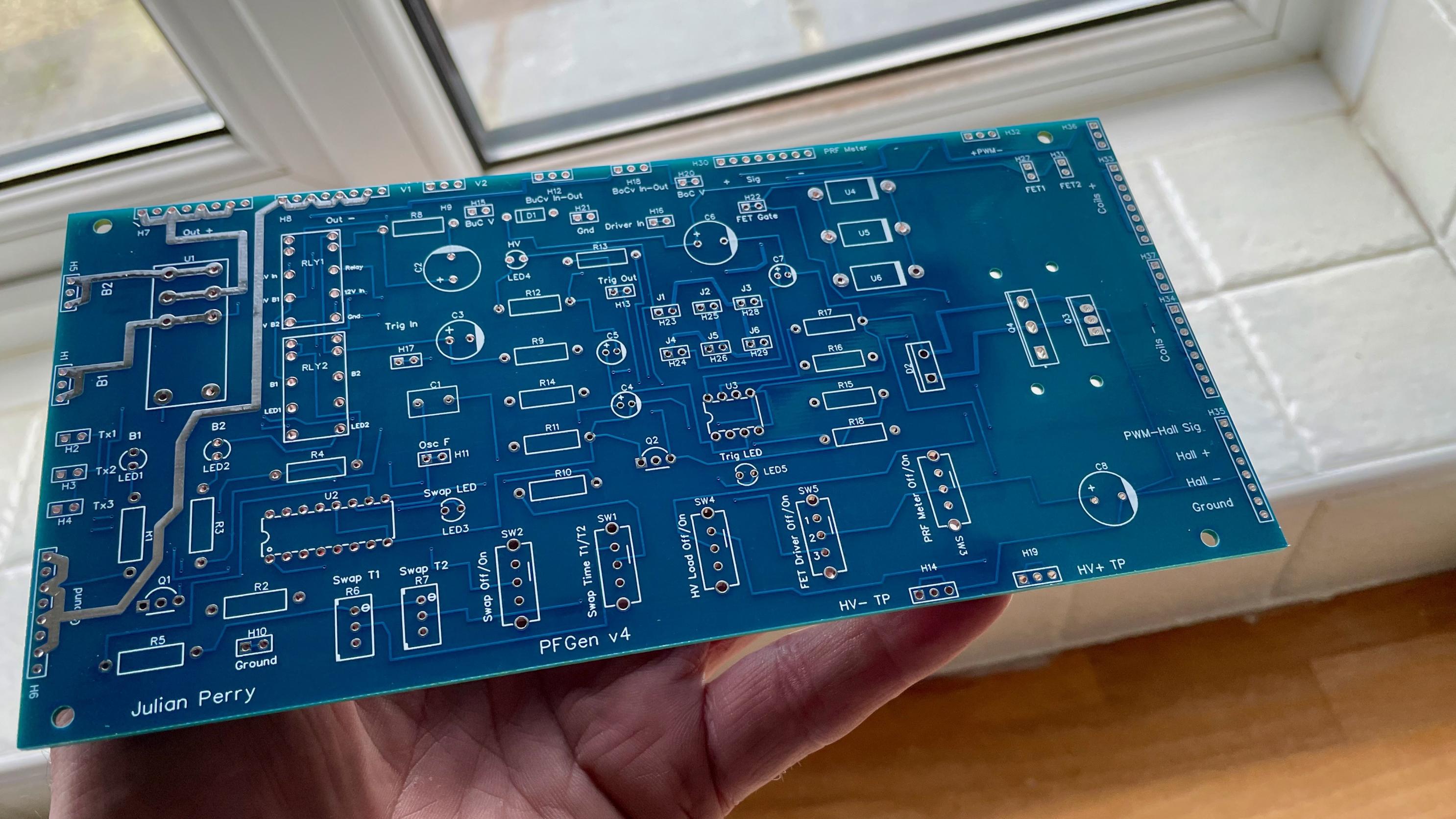

                      • #26
                        But the following thought crossed my mind:
                        By grounding this ‘switching-on-pulse’, we are wasting it… could the circuit not be constructed that we catch this pulse too? Since it is in the reverse direction, I guess we would need a capacitor for it first and when voltage has risen high enough, dump it to the battery -> so a cap dump circuit after all . But only to catch the switch on spike.
                        ​​​​​​The answer to your question is addressed by the doc ' Report - Cap Dump Circuit' in the docs folder.
                        The new PCB v4 has arrived and the test/check build will start in the next week
                        Click image for larger version  Name:	IMG_5309.jpeg Views:	0 Size:	493.0 KB ID:	73895
                        'Consciousness came First'

                          PCB looks very nice Julian! Curious to hear how it performs.

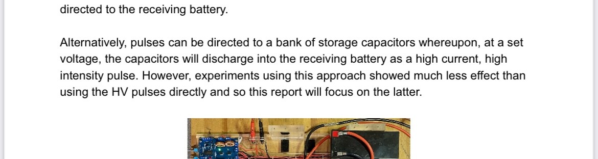

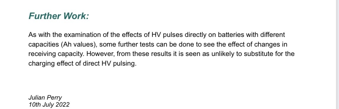

                            • #29
                              I have attached grabs from two docs in the folder indicating that delivering cap dump type pulses to the battery did very little and would required another circuit. The contribution to CoP from such would not be noticed next to that from direct HV pulsing. It would be like adding 1 to 20 and wondering if having 21 is worth the extra effort and expense.
                              Some of these chips are hard to come by. If I find other suppliers I will post them, especially if they are cheaper to deliver. AliExpress etc can be good for many things but I haven’t found any of the 150/170k5 IGBTs on there so far.

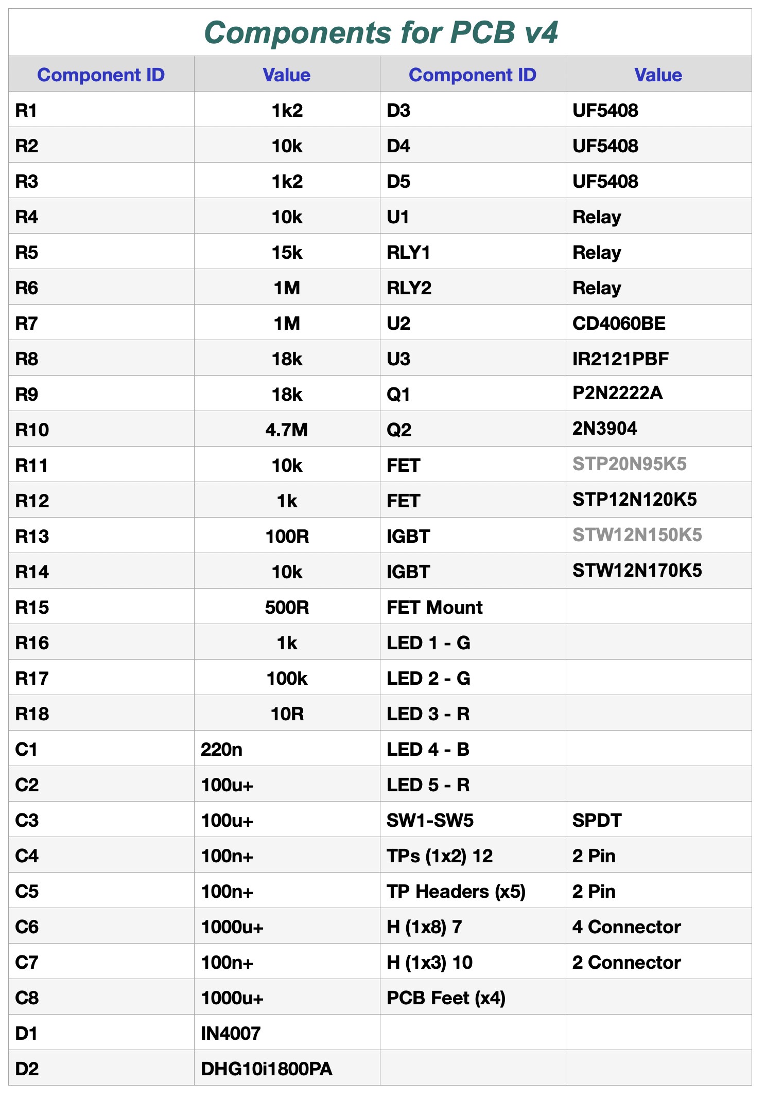

                                While I’m posting here is the components list for the new v4 PCB.
                                Click image for larger version  Name:	Components for PCB.jpg Views:	0 Size:	357.7 KB ID:	73909
