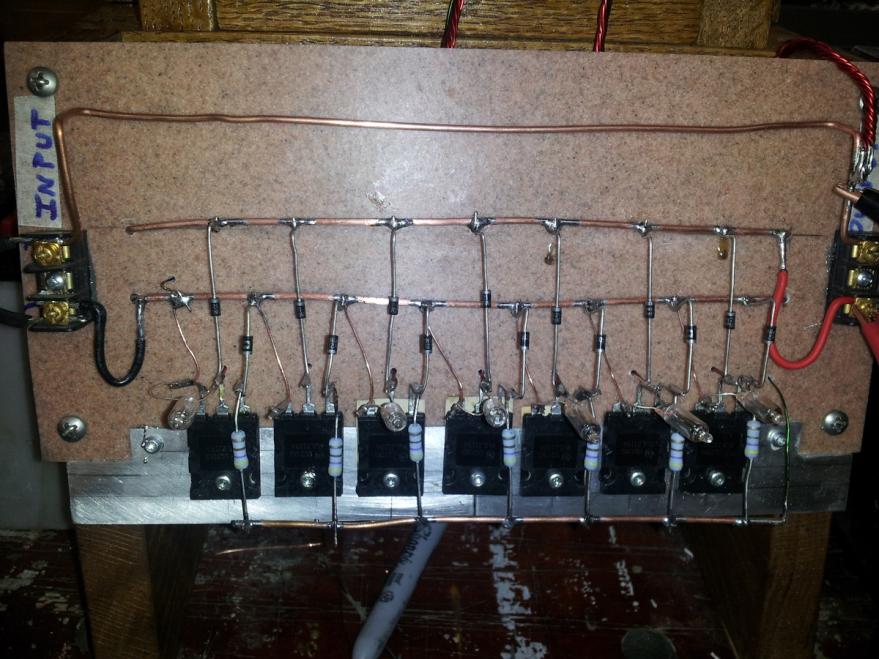

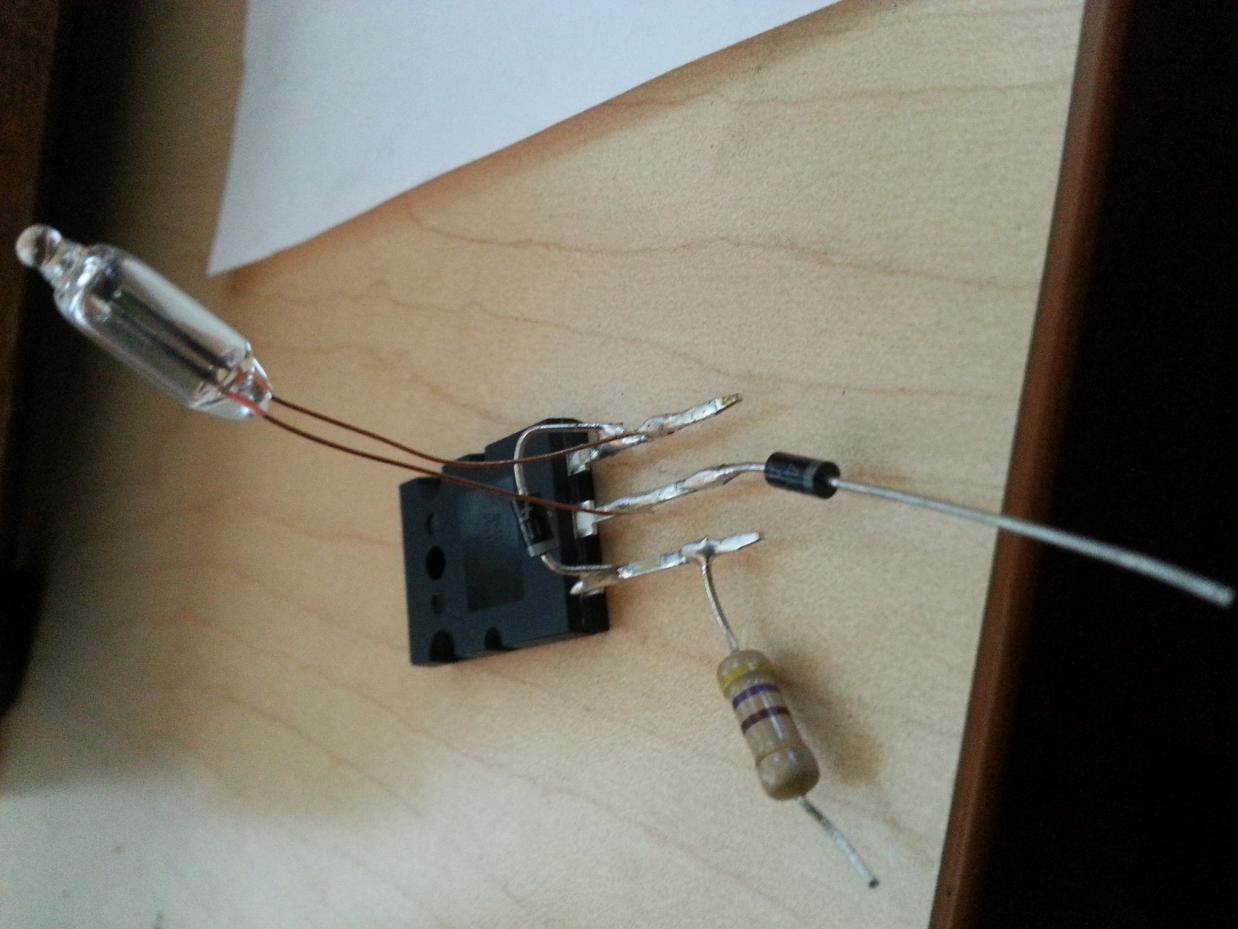

              Hi gang! Better late then never! I have a lot of catching up to do. Today I built my first SG. I built it with the help of Johns Book #1. I did it exactly like he said. Cause he says "build it just like this". So I did. or at least as close as I could. I have a close up of the circuit so you can see what I did.
              got it all hooked up, and spun the wheel the wrong way. Of course it dident run. then it dawned on me, so I spun it the other way. YeeHaw! she took right off! so to "test" the circuit, I pulled the pos off the charge battery. thats where it went wrong
              the 2nd light from the right blinked a couple of times and went out. None of the others came on. I hooked it right back up and it still ran, but slower. so I did a finger temp test on the transistors. 2 on the left were HOT! the others were cold. everything is per spec as far as I can see. So i did some testing, I have no idea how to test BJT's but the values seem consistent except the 2nd one from the left. I put in new diode, no change, new resistor, no change. removed the neon bulb, no change.
              eplanation of the picture:
              "top of the coil" comes in on the right with the trigger wire coming in through the hole, connected to the resistors. Bottom of the coil connected to the transistors, with the trigger wire coming in thru the hole on the left, connected to the?collector? the pin on the left when upside down
              The rest is visible as far as how its assembled.
              So what went wrong?
              I have got a few days to reflect, as I have to wait on Mouser to ship me new transistors
              Any help would be appreciated

                shadow44, double check your transistor.. it seem it burn away,don't ever release charging battery while SG running, it would end up burn all of your transistor..or weaken it

                  Shadow44,
                  The thing you are doing wrong I think is that if I look at the picture, all your collectors are connected through the cooling plate, you should isolate them ore use separate plates for each transistor.
                  And of course never ever run without a charge battery, better to short the output then to run it open.
                  The collector of the transistors is on the middle pin but also on the plate at the back of the transistor, maybe not everyone knows this.
                  Good luck, It looks good,
                  Karel

                    yes it would appear that way. They are actually unsupported hangin in mid-air. The resistors have sufficient strength to just hold it out about .5 inch above the transistors.

                          Shadow, you can use the ohms test on your meter. Measure between collector and emitter. If you get 0 ohms your transistor is blown.
                          • #28
                            Shadow44,
                            The reason why there is only one neon going on is that all your collectors are connected by the screws on your cooling pate.
                            The neon with the lowest voltage will light up and consume the radiant. If you disconnect that neon the next one in voltage will come on
                            I think, don't try because you never want your neon's on.
                            You can test a transistor with an ordinary ohm meter and measure the resistance between the base and collector and between the base
                            and emittor the should be around the same value in one direction and not giving a reading the other direction.
                            And the wheel should be running in both directions!
                            Karel
                            • #29
                              Yep. dead short on all of them. I dident pull them out yet, they are still soldered in. I'll take them out in a bit and double check. I was hopeing to find a good one and get it running on just 1 circuit till the new ones get here...
                              Thanks for your help.

                                Shadow44,
                                Karel
                                Well your partially correct. there actually is an insulator. (used ones) under each trans. but I checked the resistance and all of the collectors have connection to the heat sink. I have new ones ordered, just had not got them yet and was impatient. so how hot should they get if I just let them "free air" cool? would they get too hot in a few minutes just to test it?
