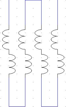

            Thanks RS,
            This 23AWG Generator coil is a mutilstranded twisted coil in the below configuration.
            All testing was done with this coil in different configurations.
            Core pointed Vertically over the North Magnet
Name:	Coil config.JPG

            • #96
              Originally posted by Deuis View Post
              Thanks RS,
              [ATTACH=CONFIG]6984[/ATTACH]

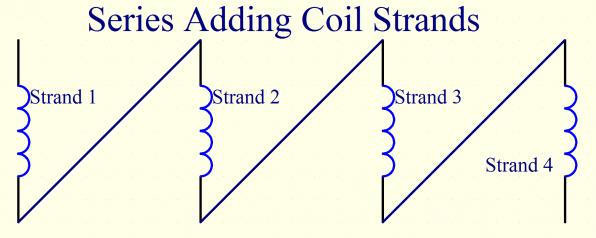

                    Deuis,
                    This is a series adding coil strands, what your Sch show's, is not series adding..... All though you may have your coil hooked up like this, and only the Sch is wrong.....

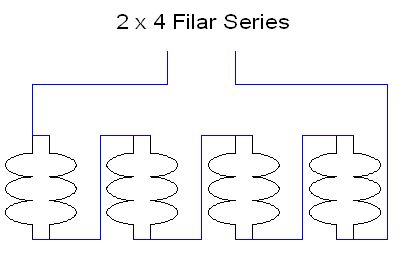

                    • Schematic was wrong.
                      Its dual coils in series.
Name:	2 x 4 filar series.JPG
                      Cant spend it when your dead.
                      • OK, you are showing 8 strands with 2 strands in parallel on each coil, and 4 coils in series, is that correct...?
                        And if so, you should make the 2 strand coils hooked up as series connected strands as well as connecting the individual coils in series... and then you need to put that output into a cap pulser, and or do the Konehead Ring the Ring trick to boost the genny energy collection into the cap pulser.......

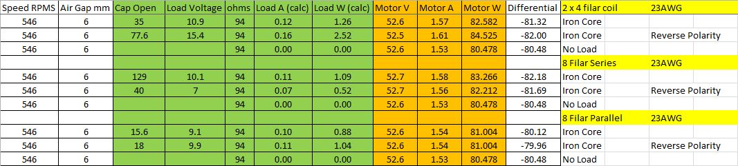

                        • Yes its an 8 Strand coil with pairs of strands in parallel.
                          These pairs are in series.
                          Early days yet, but yes thats the plan.
                          Heres a chart of this coil in the 3 different combinations.
