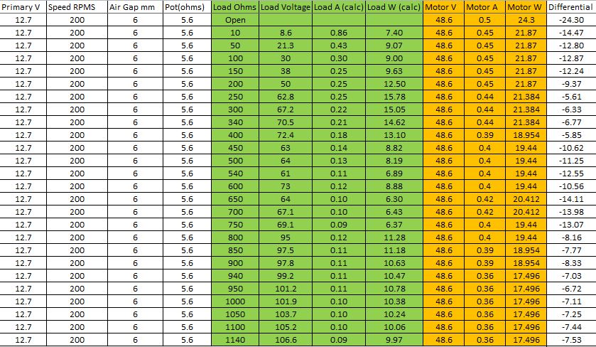

      Heres some more data.
      I tried to keep the wheel at 200rpms as best I could then varied the secondary load.

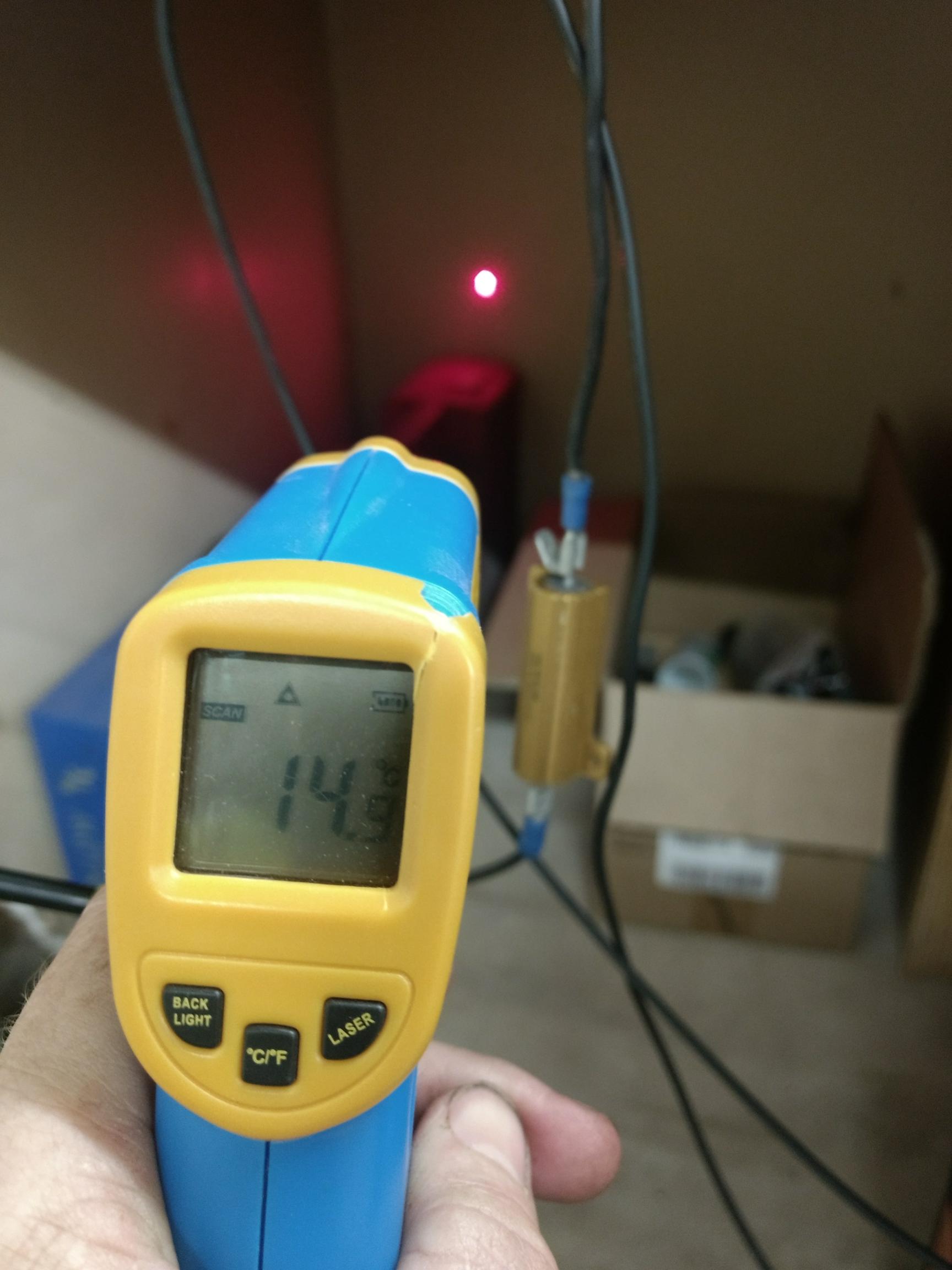

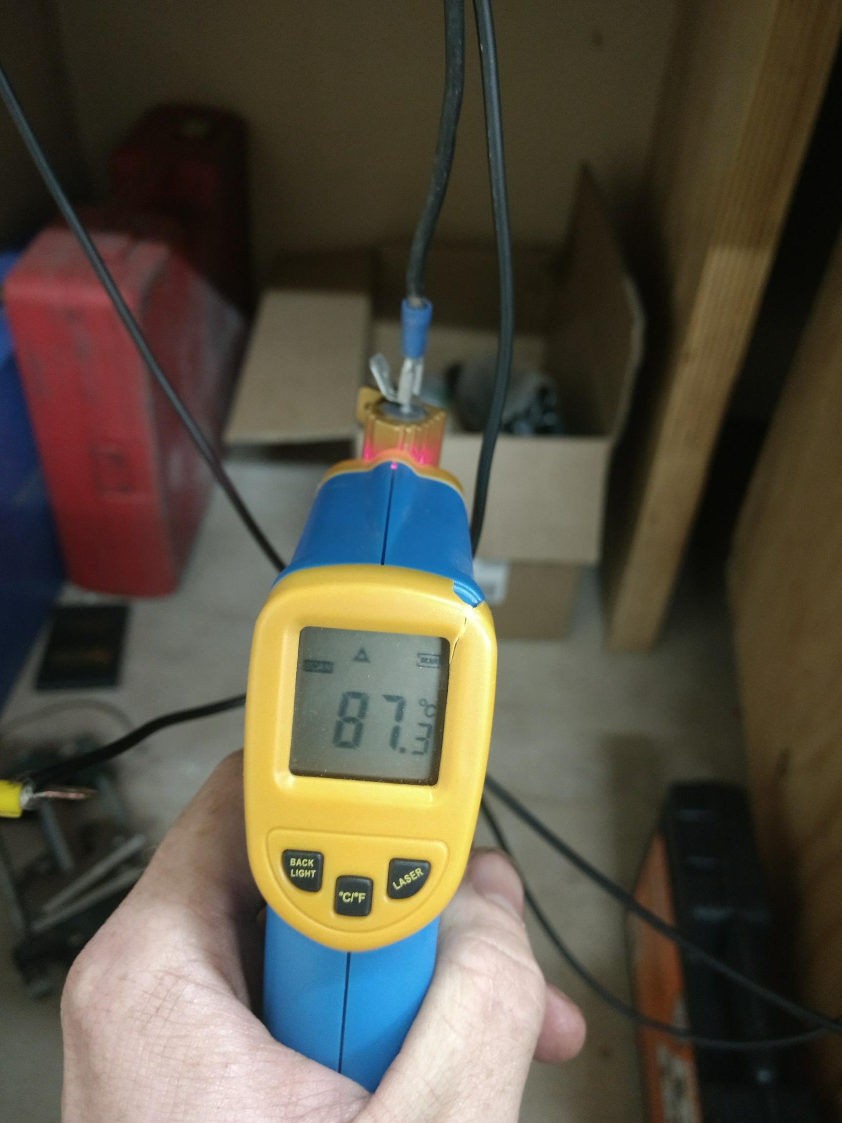

      The resistor in the picture is 600ohms, 50W.
      Thats a 73degree differential, Im assuming that is roughly 50W of heat output.
      Ive been looking for some heat specs for this resistor but cant find any.
      Ohms law tells me 73 volts across 600ohms = 8.88W
      I dont think 8.8W is pushing a 50W resistor 73degrees higher than ambient.

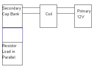

          I have put a resistor across the capacitor bank on the secondary output to simulate a load and drain off excess voltage.
          That resistor is toasty even at 600ohms.

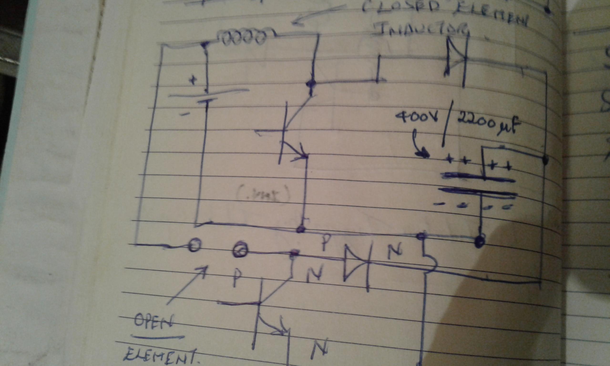

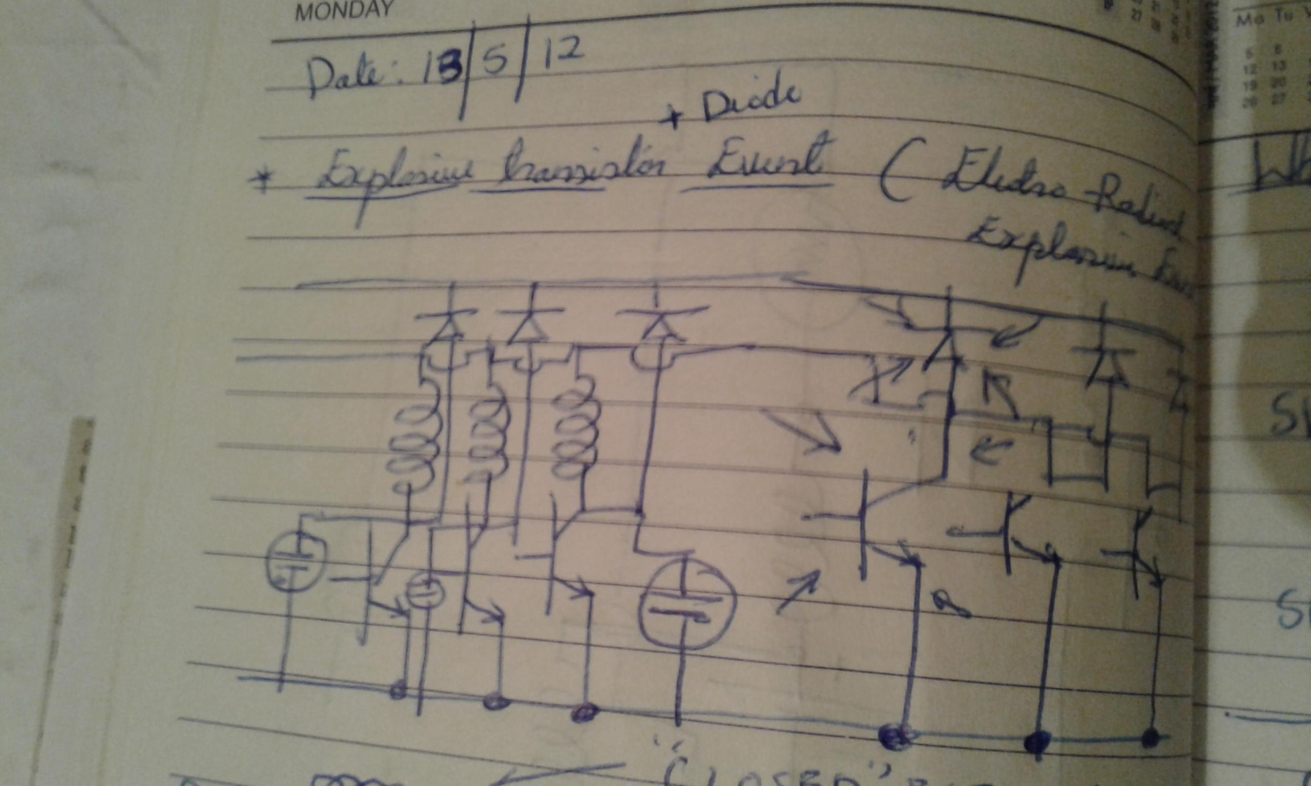

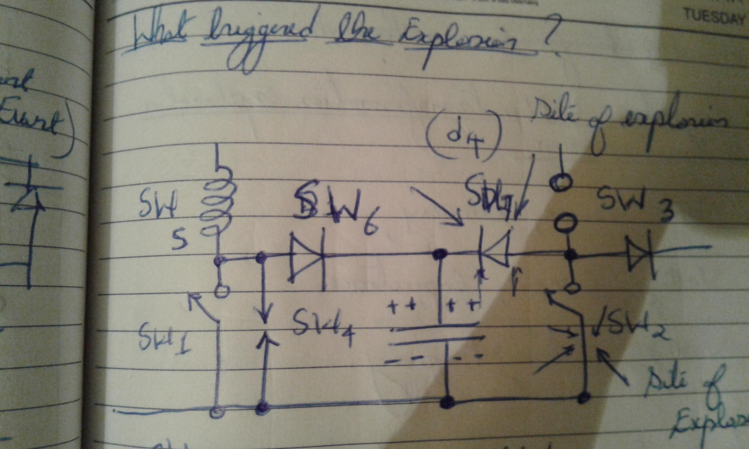

                  Another experiment to try...this one is explosive!!! Keep the same set up as you have shown..everything exact no changing anything..okay.?
                  Let a Charge build in the Capacitor alone
                  (let me know the UF of the capacitor),
                  ideal you may have 500V capacitor @ 2200uF . and then suddenly switch the discharge it through the resistor. (when the SSG is still running)
                  I guess you will see smithereens of it!!!!
                  while it should have safely bled off the juice.. one of the members here (I don't recollect his name) had reported a similar situation when he accidentally left the SSG running and the Capacitor kept building charge to a dangerously high level and when he discharged it through the resistor it exploded!!
                  In my case (around 2012) when I was running 3 transistor multi-strand SSG coil charging a Capacitor (Generator mode), now, when it was still in the running state, it exploded one of the transistors and its diode as well! upon investigating I found the Juice still present in Capacitor after the event.
                  and yes thanks for reporting the phenomena..its worth the matter.

                    Another experiment to try...this one is explosive!!! Keep the same set up as you have shown it..every thing exact no changing anything..okay.?
                    ideal you may have 500V capacitor @ 2200uF . and the suddenly switch the discharge it through the resistor.
                    where actually it should have safely bled off the juice.. one of the members here (I don't recollect his name) had reported a similar situation.

                        Thanks for the input...wondering!!! I have never heard or seen an Electrolytic Capacitor of 900V/2200uf !!! are you saying that's the manufacturer's spec on it? would certainly be interested to have one handy.
                        the ones I have are 450V/2200uf Electrolytic (ALCON make) used in the accidental explosion I described in my previous post. I see a whole lot of experiments where one can at will have either an Explosive force or heat(excess) but not both at the same time.
                        take utmost care when you fill that capacitor..results can be catastrophic without warning!!!! and you never know which component you will see flying across the room.
                        did you have look at the schematic I posted?
                        I wanted to recreate that condition to explode on purpose
