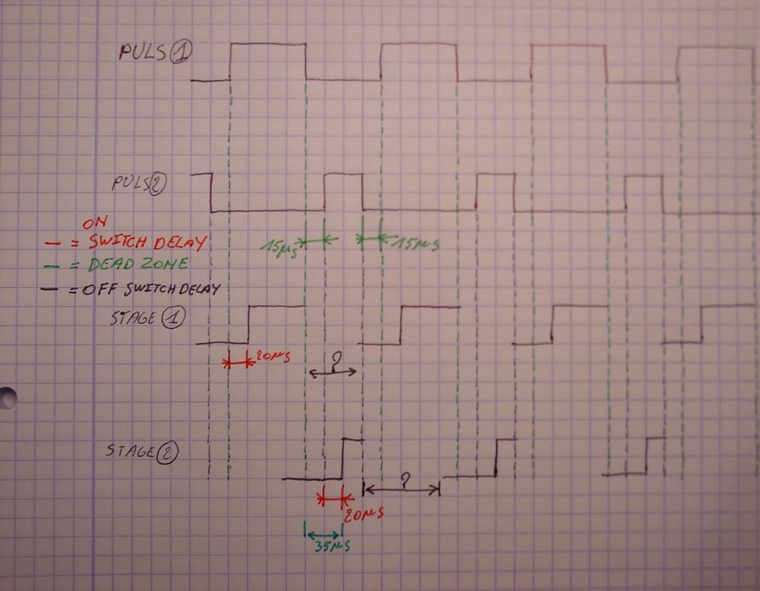

      • Hi all,
        When I whas studying the pulses out of the sg to the opto's I noticed that the puls for stage 2 is in between the puls off stage 1. So if the target is 50/50 duty, it would mean that we have to influence both sides (edges) of puls 2 or am I wrong?
        I'm going to build a measurement setup to see what the switching delays look like but with one source (one ground) so I can measure it better. The 20 micro seconds are now measurements without grounding on one channel so a lot of noise is influencing the measurements.

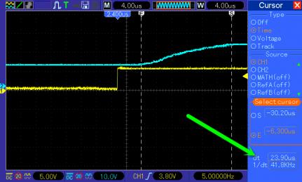

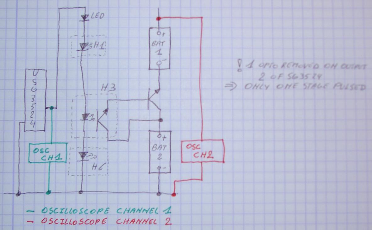

        • Hello all,
          Just did some measurements on the pulses with no load attached to circuit and interruped the pulsing of stage 2 by removing an opto out of that stage.
          The batteries used are 4 x (8 x 1.2V Ni-mh)
          The measurements or done as follow:

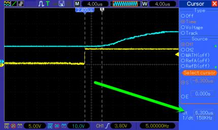

          The results for the on delay part:

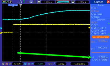

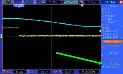

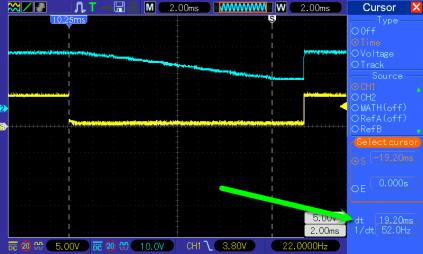

          The results for the off delay part:

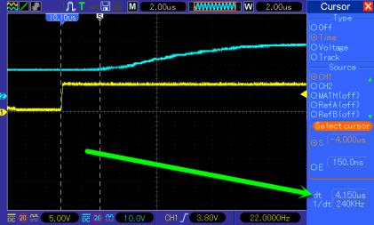

          • The measurements off stage 2:
            On delay stage 2 part 1
            On delay stage 2 part 2

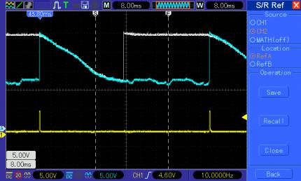

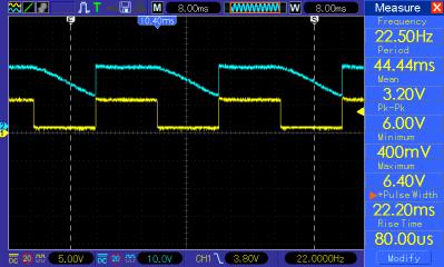

            Total overview off puls stage 2:
            Now running the circuit at 22.5Hz with no load and see what happens

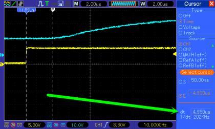

              • @ Thorsten,
                The values of the resistors 2 x 330 ohm on circuit drawing are changed to the 680 ohm like shown on pcb layout on the dvd.
                All other resistors and components have the values as on dvd.

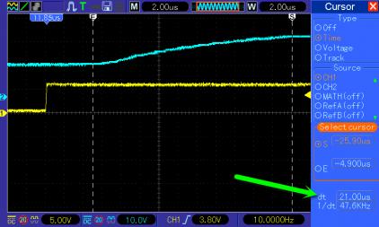

                I did the same measurements on my setup with 12V 7Ah batteries to see what differences came up.

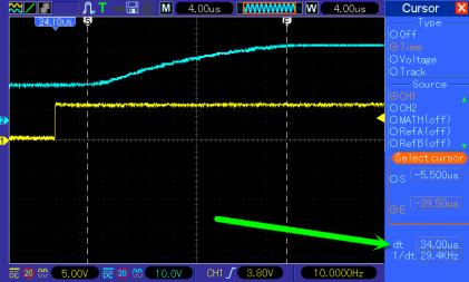

                On delay Stage 1:
ID:	46864Click image for larger version

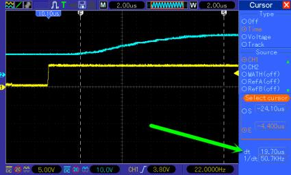

                Stage 2 On delay:
ID:	46867Click image for larger version

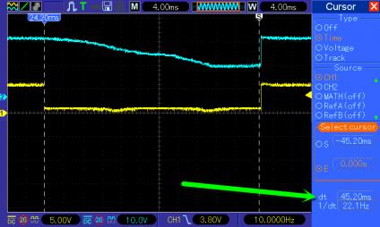

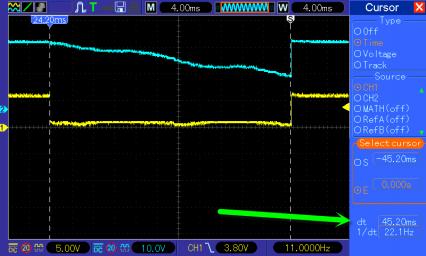

                • Stage 2 off delay:

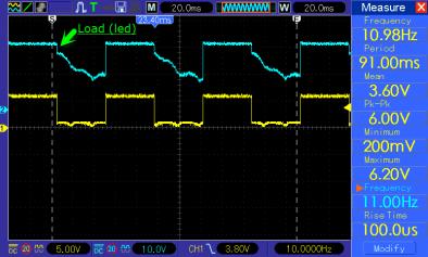

                  I also measured the influence of a load to the switching times, but this has no influence, only the voltage has a small drop.
                  The load whas a led with diode in series attached to - bat 2 and - bat 4 (the normal TS load points)
                  At the moment I still have no charging but I know something more about the delay times.
                  Summerised:
                  _____________Stage1 on part 1___Stage1 on part 2___ Stage1 off_____Stage2 on part 1___Stage2 on part 2___Stage 2 off delay
                  10.3V setup___6.3 micro sec _____23.9 micro sec______20.55 milliSec___4.150 micro sec ___19.7 micro sec_____19.2 milli sec
                  12V setup ____5.6 micro sec _____34 micro sec________45.2 milli sec___4.95 micro sec_____21 micro sec______45.2 milli sec

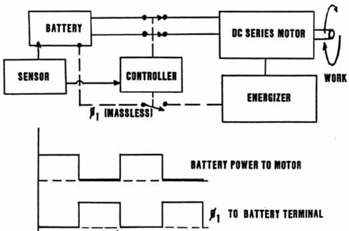

                          • Hi Guys,
                            I am not sure what you guys are doing in your switching but I wanted to try and clear things up a little. In the image below there are two different on and off times, one for the motor and one for the energizer. These two seperate DC pulse waveforms can be explained as both providing a positve 50/50 duty cycle... That is exactly what we are looking for in the Tesla Switch, what you take from side "A" you must put back into side "A" from side"B" and vice versa... it has to be 50/50 or it will not work properly. Now you have only to choose the length of time you want any side to be on for. Each side could be on for 1 minute, 10 minutes, 60 times per second or whatever you choose, it is still a 50/50 duty cycle as long as you do it equally to each side. This is called retroflection.
                            Image taken from.. http://www.icehouse.net/john1/index11.html
                            Any comments welcome.
                            -Dave Wing

                              I studied the pulses to see where differences where with the 50/50 duty.
                              Because it's not clear how great the working zone is in milli or micro seconds between charging and no charging, I wanted to find out how the switching looks like after the optos and transistors because off the delays caused by all the components. Now I know where and how much the delays are, I can try to make them more accurate to the 50/50 duty on the final switching and not direct on the outputs of the SG3524. Because if we talk about resonance in- or outside the battery I think the working zone is very small as is always the case with resonance so far I know (I'm not an expert). It could be that it's totally unnecessary to go into the micro second range for a working TS, but I have no charging with the delays I've measured, so I thaught that the only way is more accurate switching.
                              • An extra clarification:
                                I measured for example that when a puls is given it takes 5 micro seconds before the transistor output starts to react. Therefore I whas thinking to have a puls on the SG3524 not exactly 50/50 accounting for the 5 micro seconds but at the end after the transistors end with an exact 50/50 duty.
                                And this also for the off delay's.
                                I hope you understand what I mean.
