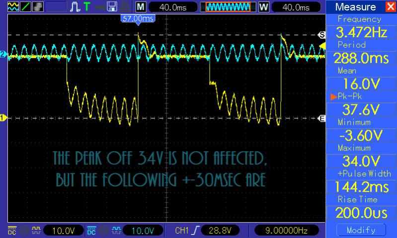

              Hi all,
              I've build the tesla switch and did some measurements with the oscilloscope and when I measure from the minus off bat 2 to the + off bat 3 or from the - bat 4 and + bat 1 I get a steady peak of 34V (used 4 gel batterys 12V, 7Ah) and then approximatly 30mSec the signal is influenced by the 50hz (grid freqeuncy) polution and then it's flattened until the puls goes down. In attachement the blue signal is 50hz polution measured with wire hanging on channel 2 of scope. I also noticed a small fase shift between the influenced part off the puls and the polution measurement and on the polution signal I get a peak everytime the pulse goes high.
              Could it be that the current starts to flow the moment the signal is flattened? Are is 30ms way to long?
              I want to mention I have only basic knowledge off electronics and like all other people here on the forum want to learn about the Bedini Tesla switch, so if the measurement done is completly wrong please forgive me.
