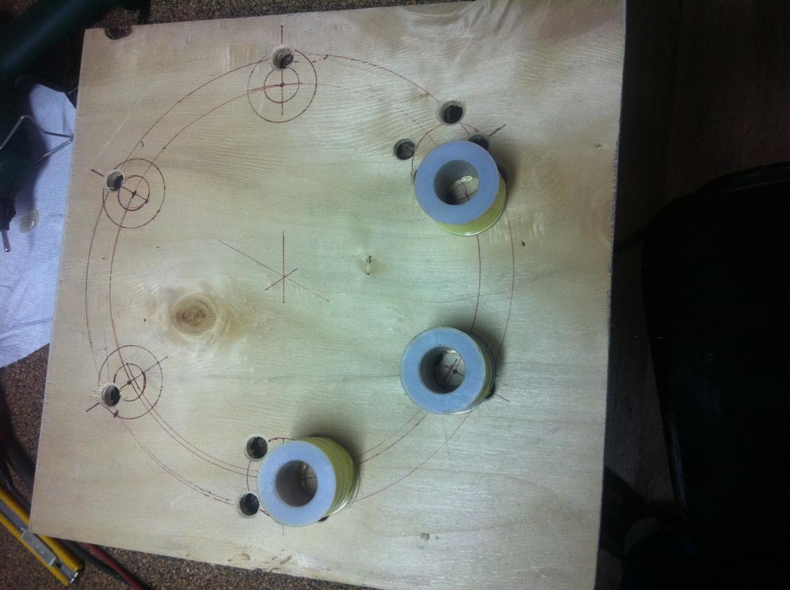

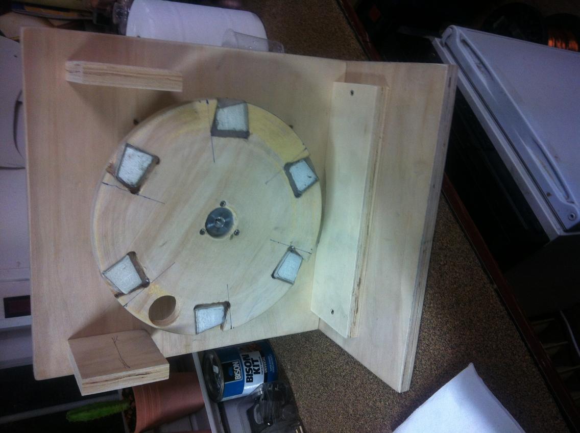

      Windings are trifilar (but for this first setup only 2 of the windings were connected in series). Every single of the 3 windings on each spool is 24mH (1000 turns 0.27mm)
      Connected in series it gives ~98mH. With the third "control" winding shortened it gives ~8mH (~12 times less! Eager to try the variable parameter switching. Thank you erfinder! )

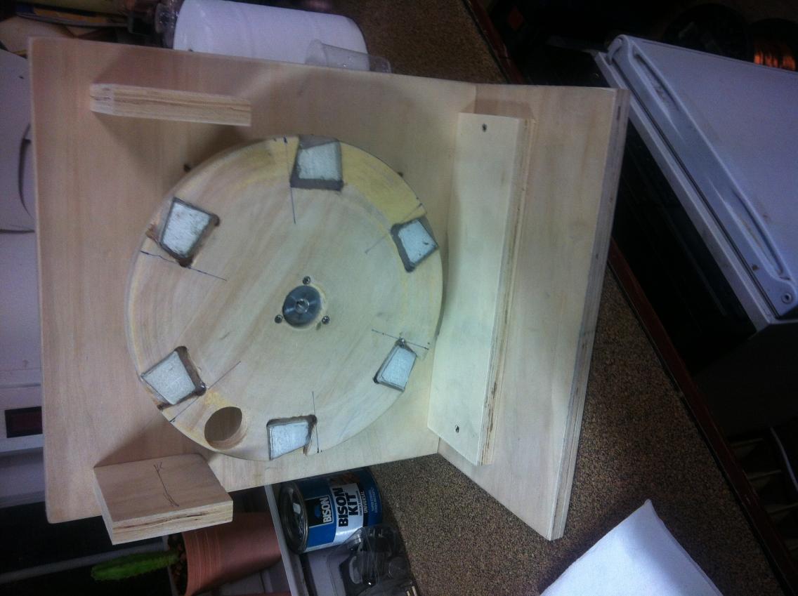

      The rotating disk was ply-wooden, suspended on ply-wooden console with mounted on the other side Honeywell DC motor. Intention was to use it at this stage as bearing, and for testing the balance of the system, by spinning the DC motor.
      Despite it looks ugly, it was well balanced, as i'we spun it up to 6000 RPM and there wasn't significant vibration.
      Only 3 spools were placed in order to make the first test, as outer 2 were placed shifted in order to be relatively phase-shifted from the inner spool (as in the drawing).

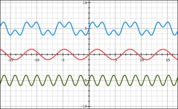

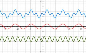

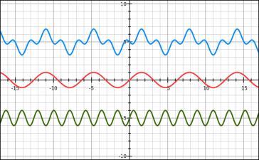

      When the disk was spun, the following wave was generated.
      Which i see it as following combination (sin(x)+sin(3x) > 1st plus 3rd harmonic):
      I've tried also inverted middle winding, and it resulted in the following wave (sin(x)-sin(3x) > 1st minus 3rd harmonic):
      I've expected to see thou sin(x) +/- cos(2x+pi) > 1st and 2nd harmonic, orthogonal shifted...
      As a whole the waves were not good sines... give it inaccurate radial passing and shape of the magnets (even thou they're extremely strong) ... the spool probably does not wrap the magnet entirely... (magnets have trapezoid shape and bigger surface than the inner circular area of the spool and thus resulting in inaccurate sines and phase shift...)
      I'm going to use smaller but circular magnets to see whether the sines will be more in shape ... and will try different connections and dispositions...

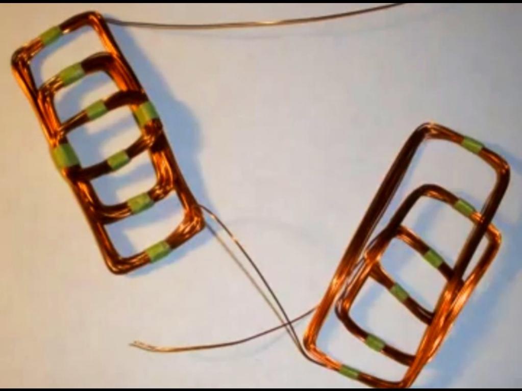

      • Is this Geomerty of the coil serving the same purpose on JB website with a central sphere rortor type of window motor..??
        • Originally posted by guyzzemf View Post
          the video i did is not good but this is . dad hav did this with his out runner/witch has a core .i just took the windings off a A motor and formed them into a c shape so i could as much of the windings around magnets . dad hav prime mover was a dremel tool
          the trigger is in with the A MOTOR/ Window motor windings .the prime mover was a std. ssg
          i never thought that the front end would be a place to tap now that i see dad hav @ erfinders video again i do. it was long ago
          the circuit is a std, ssg front end closed [i know now caped and tap for recovery ] i think i was at 3=4 k at base
          this video is old and not setup same but change one thing it is
          [ATTACH=CONFIG]3362[/ATTACH]
          this video is what i copied
          https://www.youtube.com/watch?v=nlO8UDsc-Fc
          Is this Geometry of the coil serving the same purpose as the one in on JB website with a central sphere rotor type of window motor..??
            Faraday88
            no i don't think so i just wanted as much of the windings on south side as the north tried to be like a shakeup flashlight that fired a trane
            since there is no battery the trigger needs as much as it can get by inductance so it fires harder [if i remember right] the prime mover needs to run on as little as possible [a 1/2 wave] its been a wile

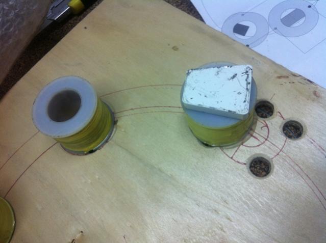

              I still have difficulties, particularly with the geometry of the coils and/or the distance between the poles

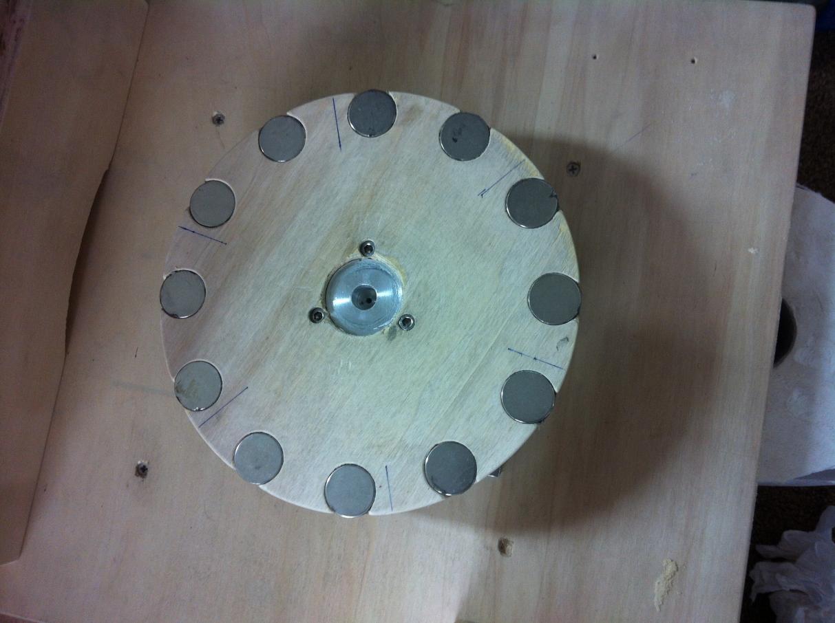

              As I've mentioned, suspected that uneven sine waves, were due to a shape of magnets and distance btw the poles... and tried last night the following rotor topology:
Name:	rotor 12 25 ply.jpg
              i.e. 12 mangents, alternating poles and distance between each magnets exactly the diameter of the magnet...
              But the 2*f or f/2 didn't show up .... tried few different coils, besides these (trapezoid magnets were from previous set-up, not used now):
              Tried with doubled diameter in one direction, twisted, c-shaped, surrounding 1, 1.5, 2 poles, between the and slanted to the poles, etc.... there was 3rd harmonic, but could't observe the 2nd...
              I think, that the distance btw the poles was too short compared to the size of the windings...
              Some hint or suggestion...
