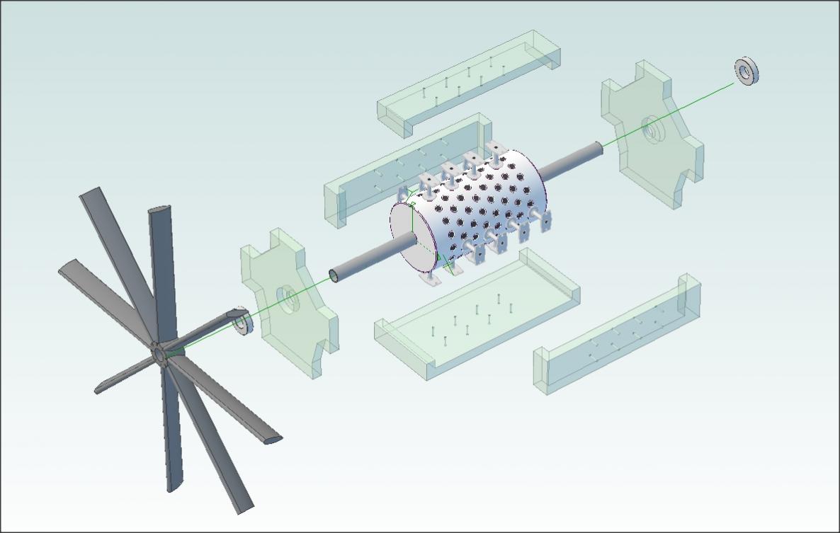

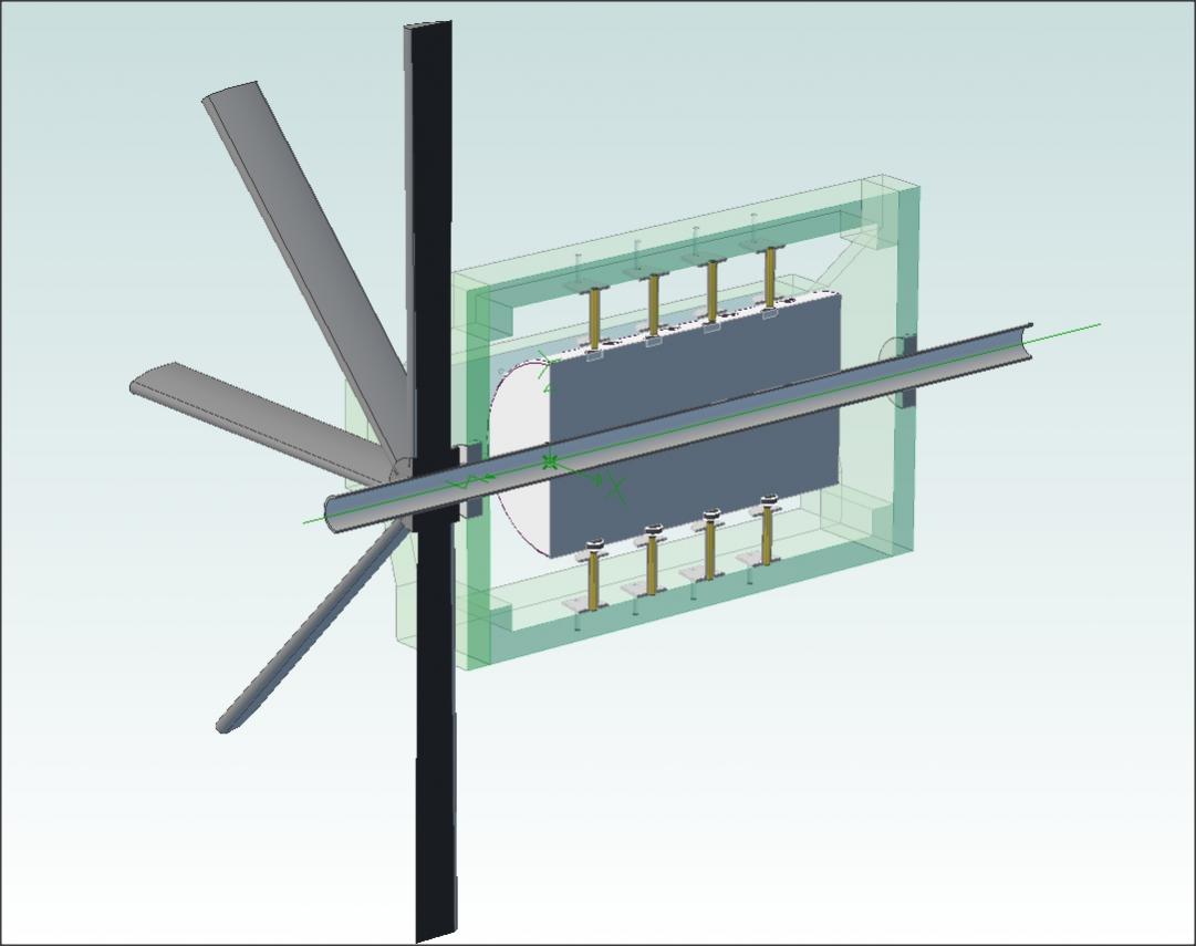

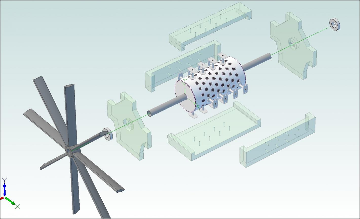

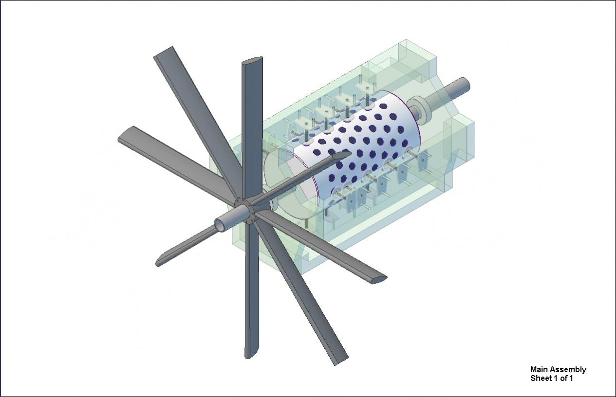

    Hello All,
    After watching John Bedini's DVD #25, I have designed a multiple "Trigger" coil assembly which will be mounted to a 15-20 foot pole. The "Power" coils, the associated electronics, and batteries will be at ground level. As a newbie, I would appreciate any and all comments as to the viability of this arrangement. The materials are as follows:
    1. The shaft is 316L stainless steel tubing 1.000 inch OD x .065 inch wall
    2. Low friction ceramic bearings are used.
    3. The rotor material is closed cell foam. There are 8 rows of magnets with 16 magnets on a 22.5 degree spacing. Alternate rows are offset 11.25 degrees from the previous row. The magnets are .500 inch dia x .188 thick. The entire assembly is covered with a shrink wrap material to retain the magnets.
    4. Sixteen small spools are used for the trigger coils. The coils are arranged with 4 coils on a 90 degree spacing.
    5. The end plates and cross braces are 3/4 Plexiglas or 3/4 MDF (Multiple Density Fiberboard)
    I have attached several drawings.
    Bill
    Hi Bill,
    Nice idea, but not sure why you have 16 "trigger" coils. You would only need one trigger coil to fire all of your power coils. In the DVD John was only using one of the windings on that coil under the bike wheel.
    Apologies if I'm missing something here.

                        Hello All,
                        I want to thank everyone for their comments. John, the reason I have 16 trigger coils in the design is that I envision having several rows of batteries being charged at the same time. I would be able to discharge a row or rows, based on power requirements. I initially plan on using 1 trigger coil and add additional coils as needed. Remember, I am a newbie at this and if this concept is not doable, please let me know. I live close enough to the Gulf of Mexico and we have wind almost all of the time, so the idea of a wind generator is appealing.
                        Again, thanks for all of the input,
                        Bill
                          the SG is not a generator, the magnets are for the trigger and the coils are transformers. they already build very efficient wind genny systems, using neo magnets and non cogging arrangements. you should get an off the shelf design and make it yourself. you will still need a primary and secondary battery for an SG system. there are hybrid ways of doing things, but I would encourage building a single coil to start experimenting first.
                            Hi Bill,
                            Like Tom said, you are better off getting a good quality wind genny and using that to charge your primary battery for your Bedini SG. If you're planning on charging multiple banks of batteries at the same time you could configure your SG for "branch currents", where you can take one bank out of the system when it's charged an replace it with a depleted bank without having to even stop the SG.
                            I would experiment on a small scale first if you're interested in this.
