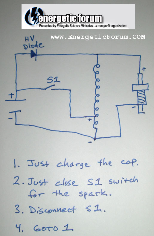

Then Peter came up with the 555 relay circuit to help me automate that connect to power > disconnect/isolate > connect to ignition coil > repeat. If you put a diode to the top of the ignition coil primary and you have a distributor cap, if the plasma even happens, you're going to get it not only at the plugs but between the rotor in the distributor cap and the terminals for each plug, which will wear then down quicker. That is another reason for just bypassing everything and putting the cap through diodes directly to the tops of the plugs.
The Datsun video answers your speculation. It shows you that the engine does not have to be running first in order to then switch on the plasma. You can start the car with plasma - otherwise, it's not as practical. I connect the diodes and then start the car right up in the video. What people are doing is running the engine with normal cap discharge ignition then switching on plasma simply to show the difference - not because it needs to be running first.Originally posted by theplummer View PostYes I've bought your ignition secrets package, as well as scoured all the other stuff available that isn't in the package. I see where there are experiments done with just attaching from the positive to the coil, through the diode, then to the coil wire and it worked there. That's what I've done, in the interest of expediency at the dyno, becuase I was only there as a courtesy guest for a friends valuable dyno time. I didn't want to eat up half his day trying to get my stuff working.

The experiments showing a diode from primary + to the top of the HV output of the coil is just for a bench test demo or for a single spark plug engine such as my Champion Generator video above. I was the first ever to do that proving you can use the cap for both the primary power source and the LV source to jump the gap.

The only other consideration is the direction the diode is pointing and that is determined by the polarity of the HV output from the coil.
