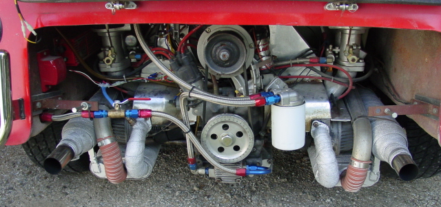

    Here's a picture of the engine it's installed on.

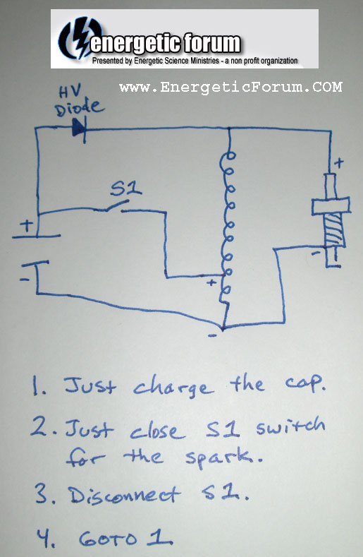

                    It does matter where you connect the diode. If you connect the diode from the coil to the top of a plug cable, any resistance in that line will eat up a lot of the potential from the capacitor. If you have too much resistance in the cable, you won't get any plasma at all. But if you connect it directly to the top of a plug, you eliminate all that resistance and wind up with as many joules as possible at the plug gap.
                    MSD's statement about solid core wires is because they are expecting the entire cap to be discharged into the primary because that is all they know. We're not doing that so it doesn't matter what they think.
                    Your belief that the whole cap has to discharge into the primary is not uncommon, but it is incorrect and this actually goes to the heart of my circuit, which is in the patent and is why my method of using the SAME CAPACITOR for BOTH the primary power source AND the low voltage high current source to jump the gap is the ONLY significant innovation in ignition history since the invention of the plasma jet ignition systems to begin with. It is also the most elegant in terms of being the simplest solution to create a plasma ignition since you do not need a separate cap charging circuit that charges a cap for the sole purpose of jumping the gap through a diode while still needing. You need a cap charging circuit for the plasma so the simplest solution is to purchase any off the shelf cdi or msd, add diodes and you're done. This obsoleted millions of dollars in patents filed by all the auto manufacturers, etc. over the last few decades who never understood that a single cap can be used for both.
                    If you connect the 400 volt cap to the primary and only let 1% of that capacitor discharge into the primary, you are STILL hitting the primary with 400 volts - just with less current. You do NOT need the entire capacitor to discharge in order for the primary to see 400 volts, it is automatically already there whether you use 1% of the cap or 100% of the cap - the extra capacitance will not add any more voltage than is already there, the extra capacitance will just add more current and more current is not necessary to make a spark - voltage is comes first and once it breaks down the gap resistance, then current will flow and it takes almost nothing to ionize that gap so that it is conductive enough to have a low voltage cap discharge over it.
                    As soon as the spark is made and the gap is ionized, 99% of whatever percentage of that cap will then discharge over the gap just fine. This is what makes my method unique - it flies in the face of what "everyone" thought was possible because countless people believe that the entire cap has to discharge to the primary including "experts" at NASA, JPL, Princeton, all the auto manufacturers and many plug manufacturers.
                    I did this on the bench with a MSD 6AL about 10 years ago just to test it then I gave it back to the person who loaned it to me. It doesn't matter the model because it works the same on every single one. The exception is if there is a wasted spark ignition that uses a coil pack where the primary and secondary are isolated from each other and half the pack has high voltage positive and the other side is high voltage negative. Everyone said I couldn't make my plasma method work on that too, but I did it and even did a whole presentation on this to prove it.
                    The only other consideration is the direction the diode is pointing and that is determined by the polarity of the HV output from the coil.
