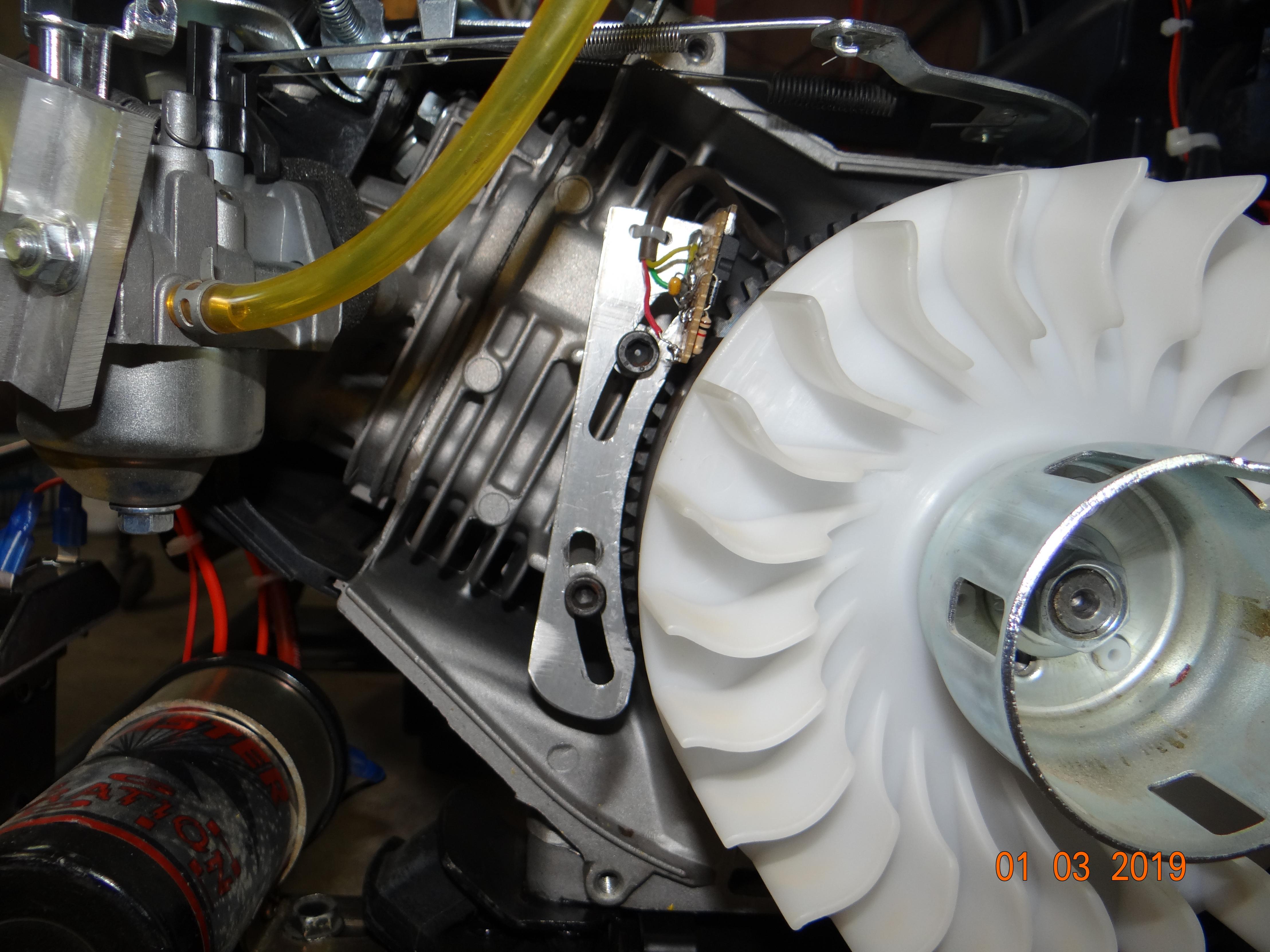

      Hi All,
      I just finished a replication of Aaron's 555 timer circuit driving a street-fire MSD module thru a MSD Blaster coil. Here's a video of it installed over a fogger unit while I was demonstrating it to my son and grandson (and exposing them to dangerous radiation - LOL ).
      The video starts out with a surface gap plug installed without fog and then with fog. Next comes a regular plug with conventional gap. It runs both with and without fog added. Then a little propane gas is added (both with the fog and without the fog), and finally I show my plasma lighter.
      We all lived thru the experiment and my son Bob took the video.
      I now have this plasma ignition unit installed on my 3550 watt gen set. I don't need the 555 timer for this as I am triggering with a hall switch next to the original flywheel magnet. Here's some photos of the set up. The last photo is a close up of the surface gap plug I'm using.
