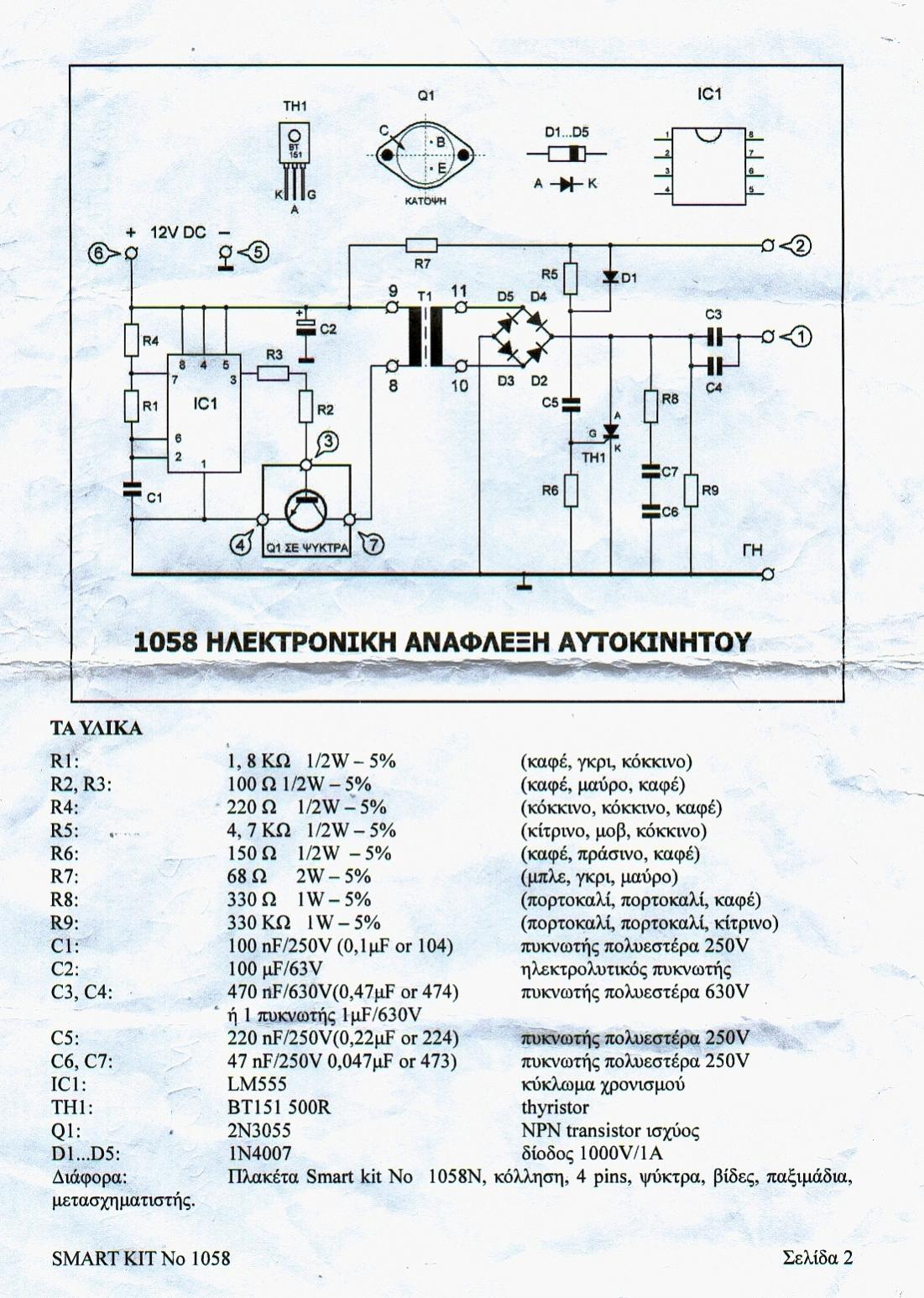

      I am using this, smart kit, unit:

          • Now I am in position to confirm it: the diodes 6A 1000v are slow and do not permit the plasma discharge above a middle rpm limit.

            • Originally posted by Richard
              If your Smart Kit ignition system is not potted in epoxy it would be very nice of you to post component values and any corrections to the circuit that they are showing on their website link, for example, they show the gate of the SCR going to the junction between a cap and resistor instead of the original ignition points.
              Details on the transformer is always useful in these ignition circuits since most of the time getting the transformer is more difficult than all the rest of the project.
              Thanx.
              Richard Gieser
              No, no epoxy.

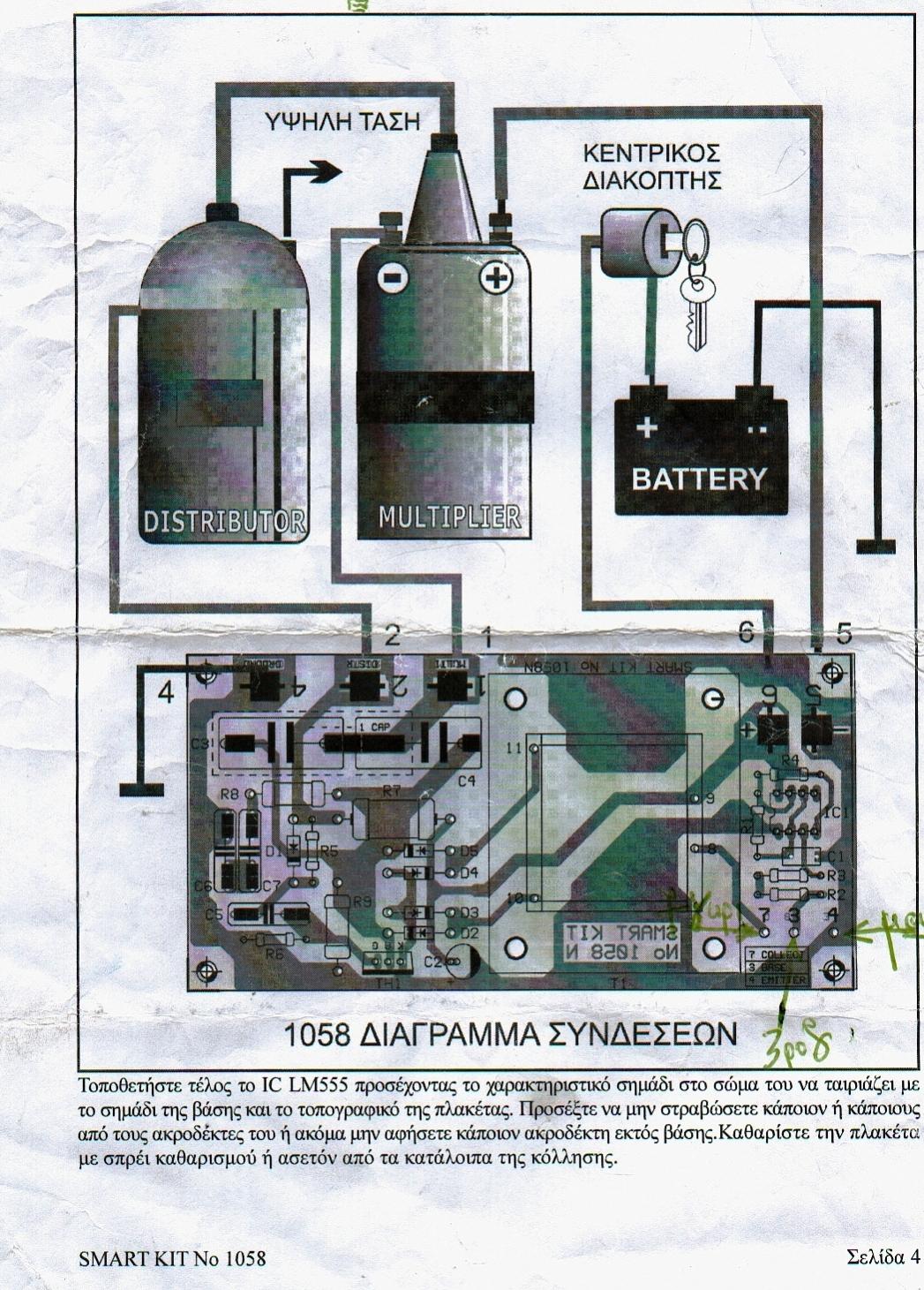

              I have these two documents only, (some words in Greek but it is coded in English. For any help please tell me):
Name:	smart kit 1.jpg
              (click on the image to enlarge)
Name:	smart kit 2.jpg

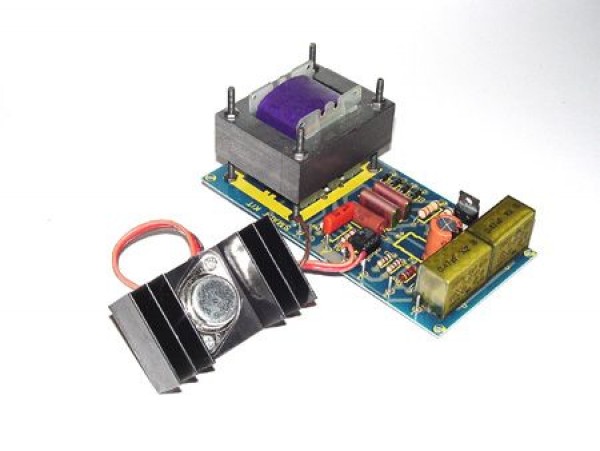

              Do you want a photo of mine? (A little bit differentiated than that of the brochure, I don't know why).
                Thank you, Hellenic.
                That shows the distributor points input on terminal 2 and all component values are listed except the transformer which appears to be running about 3377Hz based on the resistor and capacitor values on the 555.
                Newark.com has a 1,200v 15 amp (110 amp surge) diode rated 20ns for $5.56, and that's the best speed I see anywhere in that range of amps and current with a forward drop a bit on the high side at 4.04 volts. Part number: DSEP15-12CR
                The p600 I saw was rated 2.5 microseconds so the DSEP15-12CR is about 125 times faster (2,500ns/20ns=125). An depth search would likely produce some more ideal parameters such as lower forward voltage drop and lower cost.
