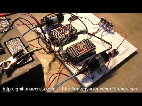

      Excellent presentation!!, What is need for a Dual system in specific..?
        Thanks, it is for an experimental gas engine that has 2 pistons. They're 180 degrees out of phase and need a spark that flip flops back and forth.
        This was the easiest and quickest way for me to do it.
        This is just a prototype for that engine.
        I'll have to miniaturize all of this so it works with 1 unit and draws way less energy.
        It really only has to discharge once per cycle and not 6-7 at low rpms. Nice to have that, but for this application, the power supply cannot be too big.
