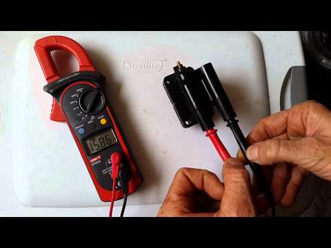

Two caps in series puts the total capacitance in 1/2. How many watts is your inverter?Originally posted by ThankyouBedini View PostHere are some sparks I made today.
As you can see from the video the hook up to the coil is reverse. This way works, but it is not making plasma alone. The plasma comes with the booster capasitor, 440 v 50 uf.
When I put two caps in series, it is not getting any better, so one is enough. If I crank up the voltage to much then the ignition coil makes internal sparks, and I get no plasma on the sparkplug. To be able to make the golfball size sparks I have heard about but never seen, I have a feeling that I need a HV+ coil. If anyone knows where to buy a HV+ coil please let me know. I am more than willing to buy secrets regarding HV+!
I can make HV+ by just hooking up the wires from the MDS 5520 the coil + to - and - to + (reverse). The results is just (weak) sparks! Then if I add the 6a10 diode string and point the diodes towards the spark gap I still just get (weak) sparks and no plasma.
If I hook up wires from the MDS 5520 to the coil + to+ and - to - (normal) and then add and point the diode string away from the spark gap, I get plasma.
I expected to see plasma when I reversed connected the coil and made HV+. The only way to get plasma that way is to add booster capacitors.
