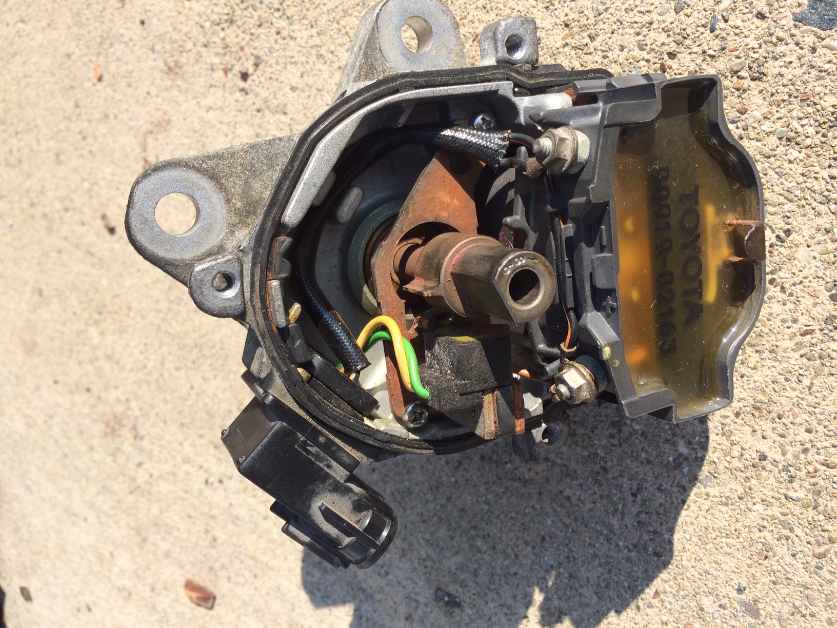

Originally posted by rokan
I currently have the 2 coil wires coming out of the distributor that I have connected to my MSD unit, again with the white wire connected to the - wire of the stock coil to get my engine to run at this time.
I assume you have the orange wire and black wire from the MSD unit connected to the Nology coil primary terminals, correct?
