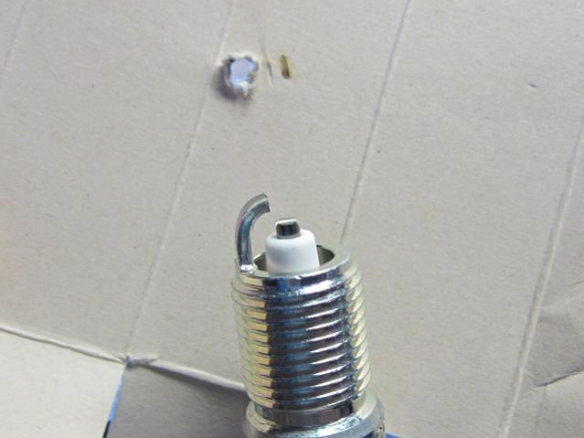

                        • Which sparkplug end is more efficient at gasoline ignition with plasma? A single ground point as a normal plug or a plug with the ground removed (circular fire pattern)? With the single ground there is a crisp snap. With it removed the snap is less crisp and spread out.
                          • plug ground geometry
                            The surface gap plugs work well.

                            If you want to use a ground strap, you can always cut it back so the full face of the HV electrode is exposed.

                              With regard to the plugs, I have done some testing on the bench before I move it to the RV. I have used a NGK BP5FS and a D8EA with strap and the other cut off , different heat ranges. Setup with an MSD 6A with MSD cables and 10 1N5408 diodes in series. Ok if you let this run on the bench for two hours at a high frequency, single discharge, the new spark plugs show severe eating of the positve electrode. This was with both plugs and I will make some picures for you. This test isd comparable with about 10hrs hours of driving.

                                The plugs have always been an issue - needs to be tungsten on both electrodes.
                                Some plugs last longer than others but can last a lot longer than 2 hours. One partner tested some that lasted a several thousand miles.
