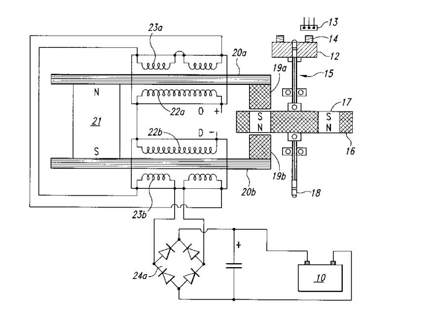

        On a different note I finally got a motor/gen setup to test some of the theories in the big machine that i plan to build someday. Funny thing is that I changed a few things around and realized i found (at least i think) a way to make a bipolar version of the bedini back/emf motor (second picture in the second post of this thread). What I did was took some laminates from a transformer and cut them to make two big E's at each end there will be magnets conecting the E's together while leaving a space in the middle for a rotating magnet. On paper...it becomes a bipolar version of the bedini gen. because the magnets would be placed to make a connected magnetic path ..one side north on top other south on top. so for example if the left side magnets have north on top then when the magnet in the middle (rotor) has south on top north on bottom the magnetic path in the left side would be exactly like the bedini motor with a power coil on each connecting member and a bifilar pickup coil over those. so once you pulse that coil the same way the bedini version does...the center magnet would then be aligned with north on top and south on bottom...so it would go to the right side because that outer magnet would be south on top. so if i wind each side the way JB did his then theoretically I would have a bipolar version. the only pictures i have so far are the cores with the power windings on and they are fuzzy sorry.Click image for larger version
ID:	47070Click image for larger version
Name:	bedini back-emf.jpg
        • #64
          Hi Bardly,
          What do you mean by a 'Rotating Magnet'...,in the centre the Magnet would 'Spin' in the way you have arranged your set up..wonder how would that make the set up work as a motor/ generator.since the shatft would interfere with the 'Rotating Magnet'...sorry 'Spining' at the centre. nice work any ways..keep going best of luck!

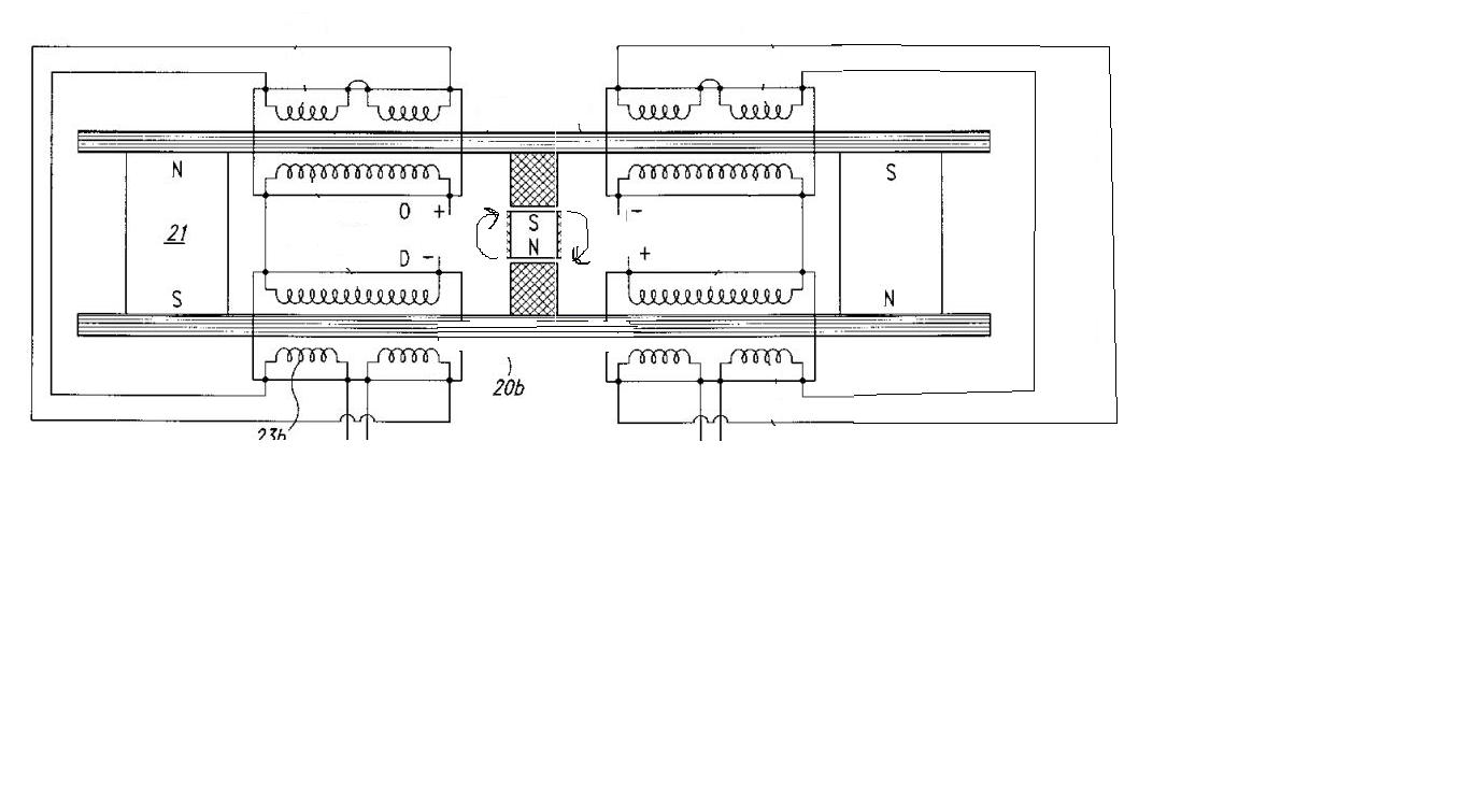

ID:	47073this is what I am doing. The "spinning" magnet will be the round one in the middle...since it is diametrically magnetized...when i eventually cut the center prongs on the cores to allow that magnet to fit between them, as it rotates it will align with the magnets in the cores alternately. Just as JB's back -emf patent he uses a stationary north on top south on bottom magnet with iron bars /coils that when a south on top north on bottom magnet aligns with the bars he then pulses one of the coils driving the rotor magnet away while generating in the other bifilar coils. in mine as soon as the coils are pulsed to send the magnet away instead of going away it would reverse around its axis so that it aligns with the opposite side of the devices magnet. Hope I explained that enough for you to see where i am trying to go. instead of a disc of magnets i am using one...instead of one stationary magnet to align with one alignment polarity I am using two stationary magnets that are opposite each other so that instead of it only aligning with one polarity n/s or s/n (in a disc) each one aligns with one of the posibilities of the center magnet so whether it is n/s or s/n it is aligned with a permanent magnet the same way as in the JB's patent mine just has another turned upside down and slaped on the other side.

Name:	bipolar back emf.jpg
ID:	47074 I made an edit to the bedini diagrams to show what i am doing. hope this helps.

                  Faraday,
                  not quite sure what you mean. the magnet is daimetrically magnetized so one rounded half is north and the other is south...not the flat end faces. so as in the picture, as is sits, one pole in the center of the core points to north and the other points to south on the magnet in the middle. so when i rotate it around its center ther would be an alternating polarity on the center prongs. you say that the magnet in the normal patent is meant to buck the rotor away but they would be attracted throught the bars to each other...so the motor action comes from the magnets aligning...as soon as they do the coil is pulsed in the opposite polarity causing a buck the boost (slam the flux backwards) in the cores causing the rotor to keep going while "generating" in the secondary coil when the buck happens collecting the radiant....in mine one side would do nothing if it is not the side with the aligned outer magnets (some posibilities in my head but i'll look into it later) ...also i am having a hard time understanding where the magnetism would take a twist?

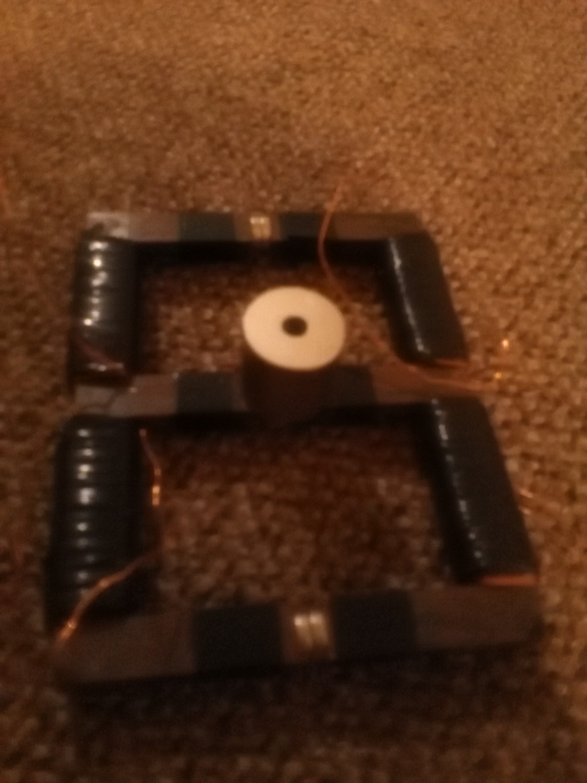

                            OK..I am hesitating to put the other coil on because i am affraid i do not have enough there as a drive coil. Each drive coil is 150 turns of some large wire 18...maybe 16 gauge. It was the primary wire on a large transformer so I do not know the exact gauge. Anyways two of the coils will be used in series on one side and the other two in series on the other...so it gives me 300 turns divided into two coils on each side for a drive coil. when i measure it it comes out to .4 ohms in series of course is .8 ohms...if i used 12 volts i would be pumping 15 amps! to drive this thing...but i plan on it being pulsed with a very small pulse at just the right moment so it wouldn't be continuous 15 amps but still thats allot. I was thinking maybe if i just ran it from 5 volts that would be around 6 amps but I am not sure if 5 volts would be enough to make it run. Its the current flow not voltage that makes the flux flow so ..I don't know! I don't have any money to get more wire and i think i took all my transformers apart already so i guess i am stuck for a minute.

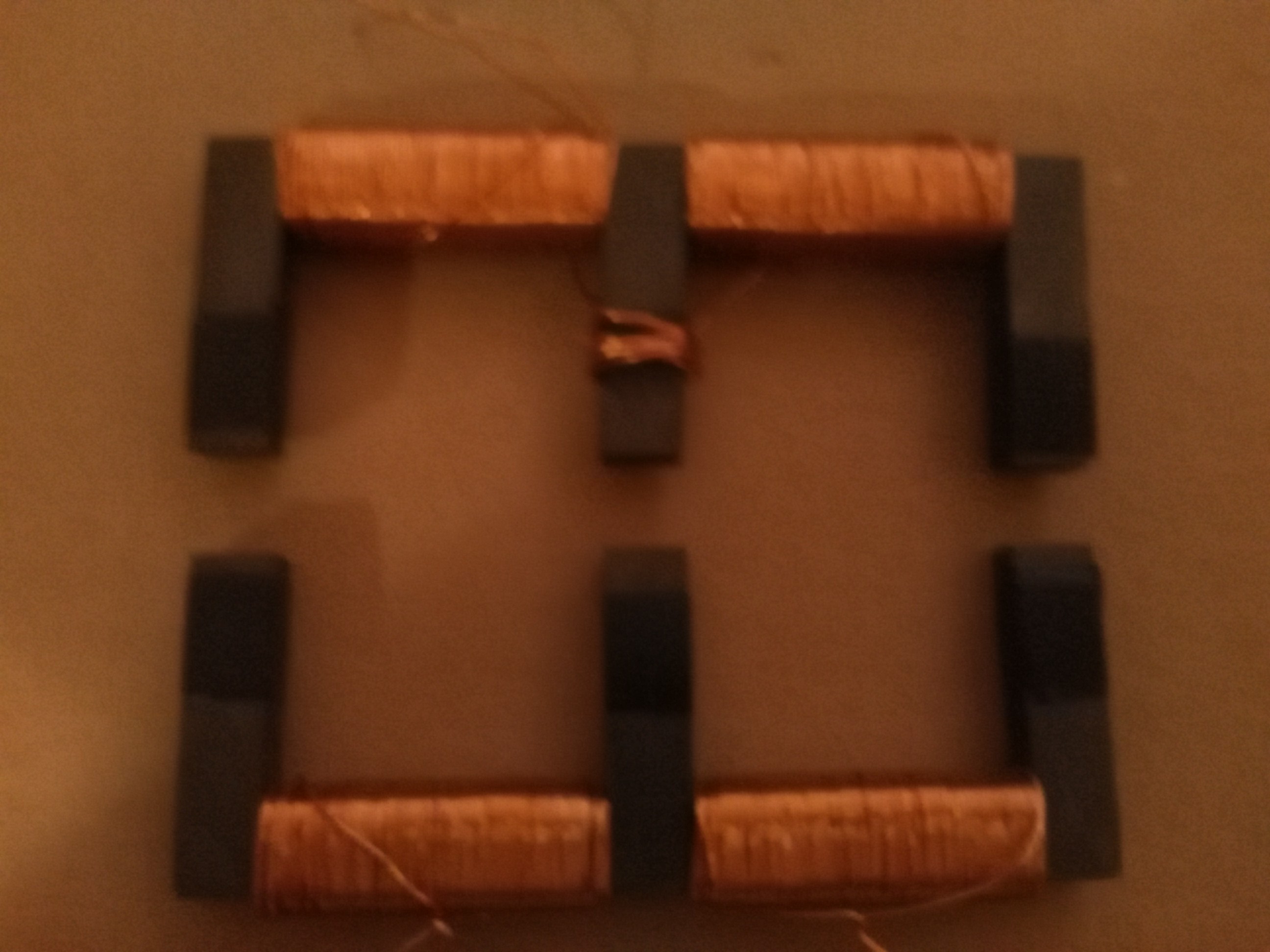

                              • #75
                                Well I got all the coils wound 375 turns each (1 ohm) ...then decided to check for shorts. Every coil is shorted to the core...So...I get to do it all again!!! YAY! I think life just taught me a lesson on insulating sharp metal cores from conductive wire. I did wrap them in electrical tape where the coils would be but apparently not enough!
