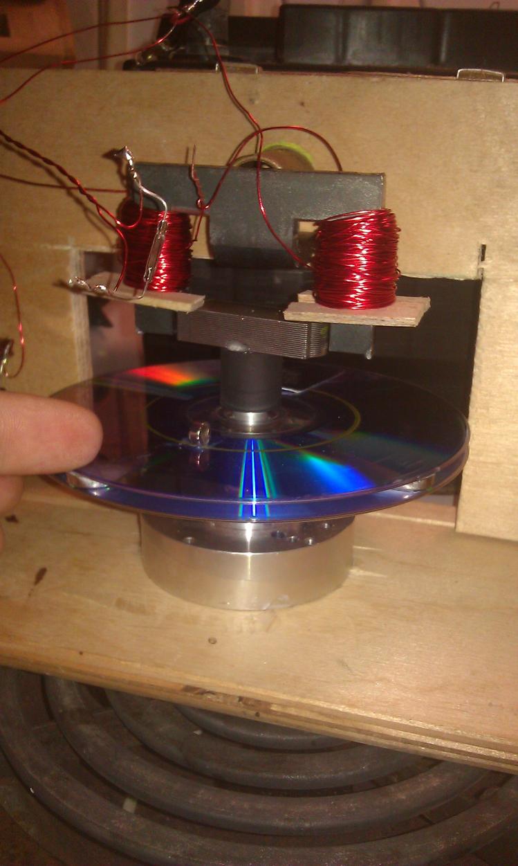

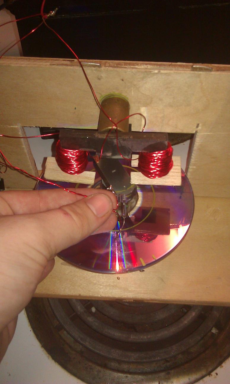

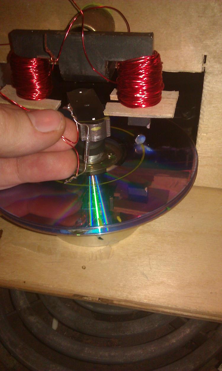

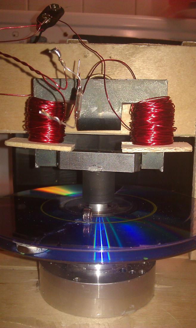

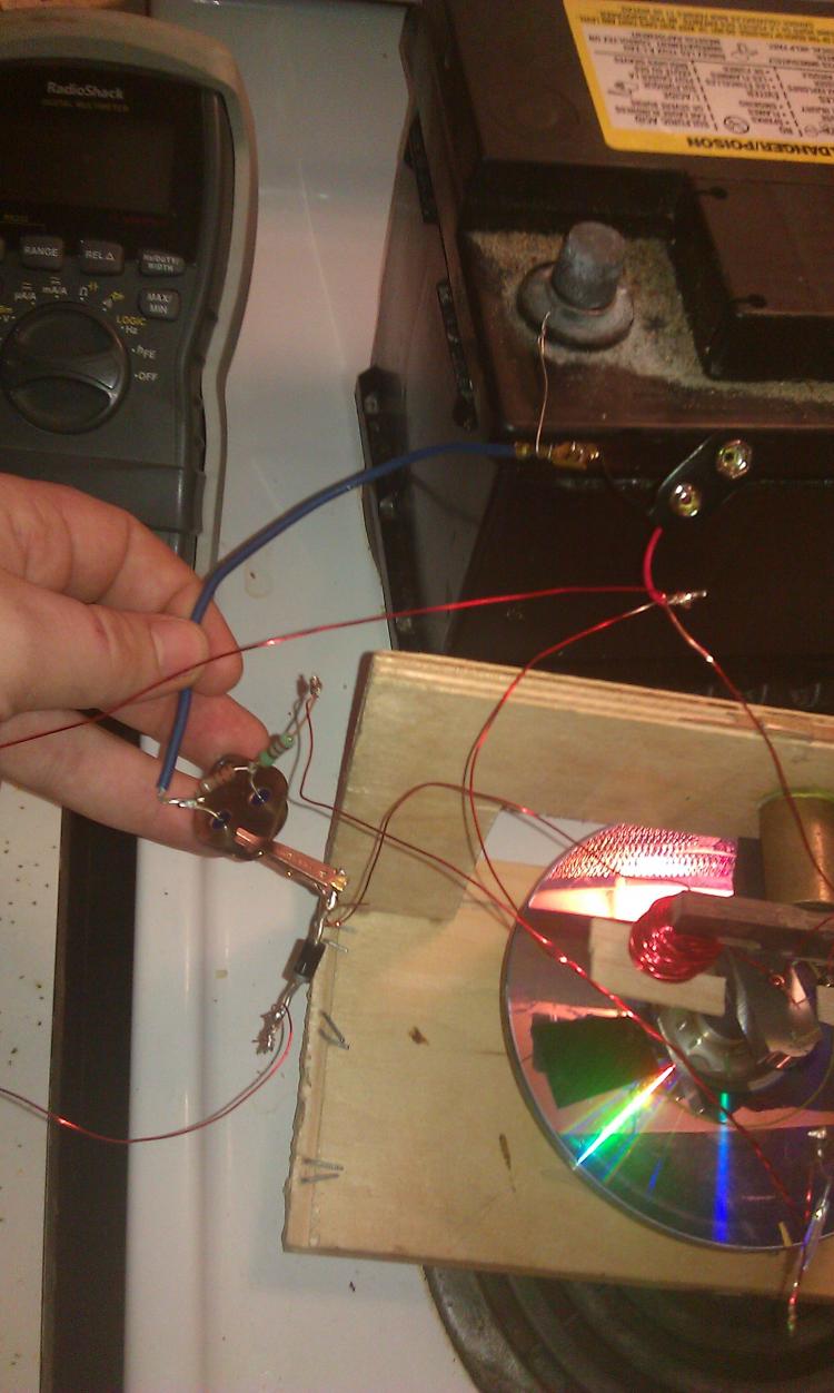

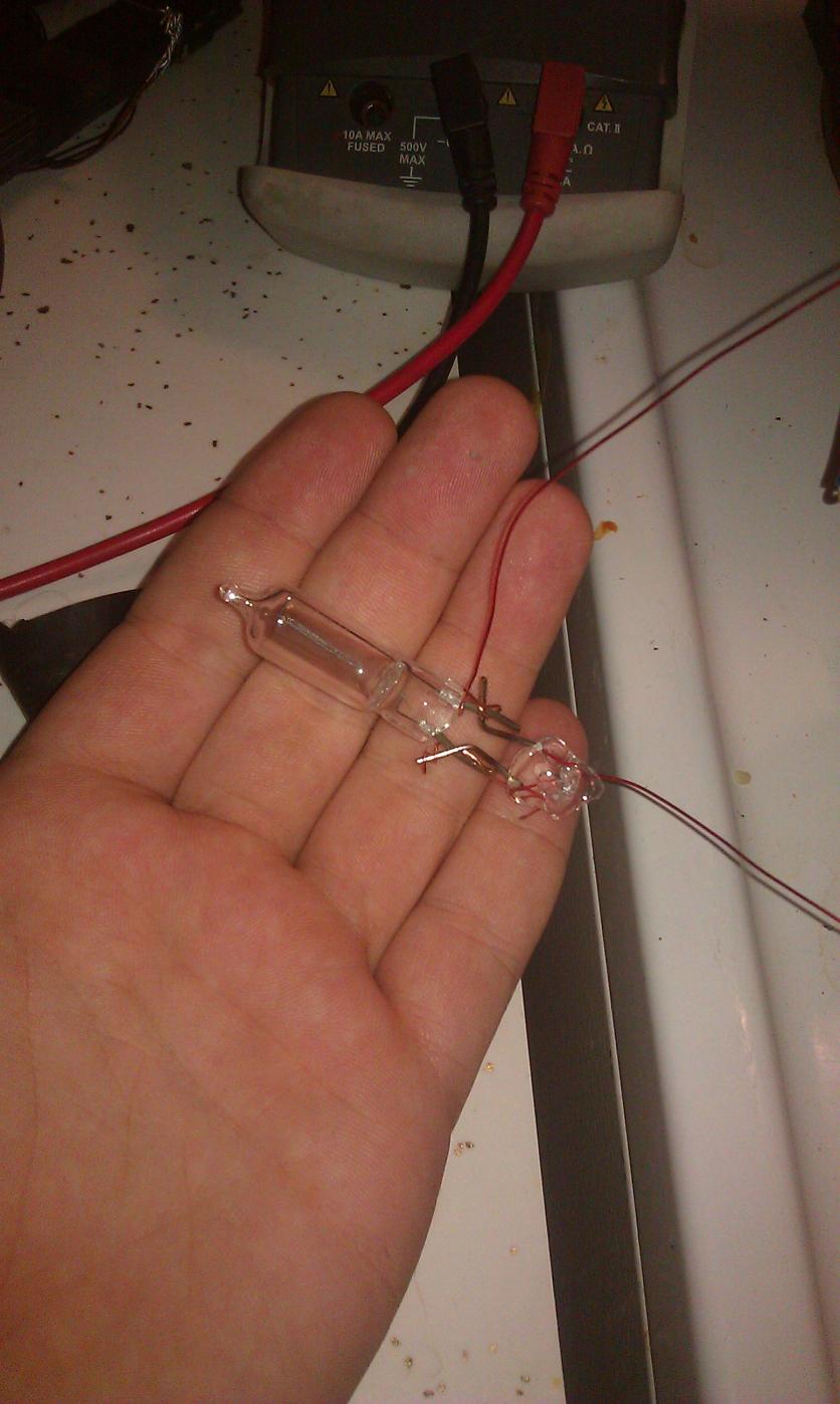

    • #47
      forgot this one showing the circuit...those are 220 ohm resistors on the 3055.
      if you notice in the pictures above, the picture where i am holding the reed to the tip of the rotor piece ....that is how i had it for the oscillation to happen. the magnet that is meant to switch the reed is on the upper right side out of sight behind the stator. i have four neo magnets at 90 degrees inside the cd's one of those that can barely bee seen between the cd's is the magnet that switched the reed for oscillation. the rotor was Not aligned to the stator as you can see but once the power would enter the stator its magnetism must reach out wether throught the pole piece or the air and switch the reed off making a magnetic oscillation. i found i could also very how bright i got the light by bringing it further away from the pole and closer to the magnet -requiring a bigger field to turn it off so the light would get brighter. but no matter what i did nothing got hot....even warm. after 10 seconds running the motor things were hot!
      *EDIT* was not the diode....transistor blew i forgot to disconnect a wire before checking the threshold voltages once i disconnected it i realized the diode is fine it was the 3055 that went...that explains why it stopped.
