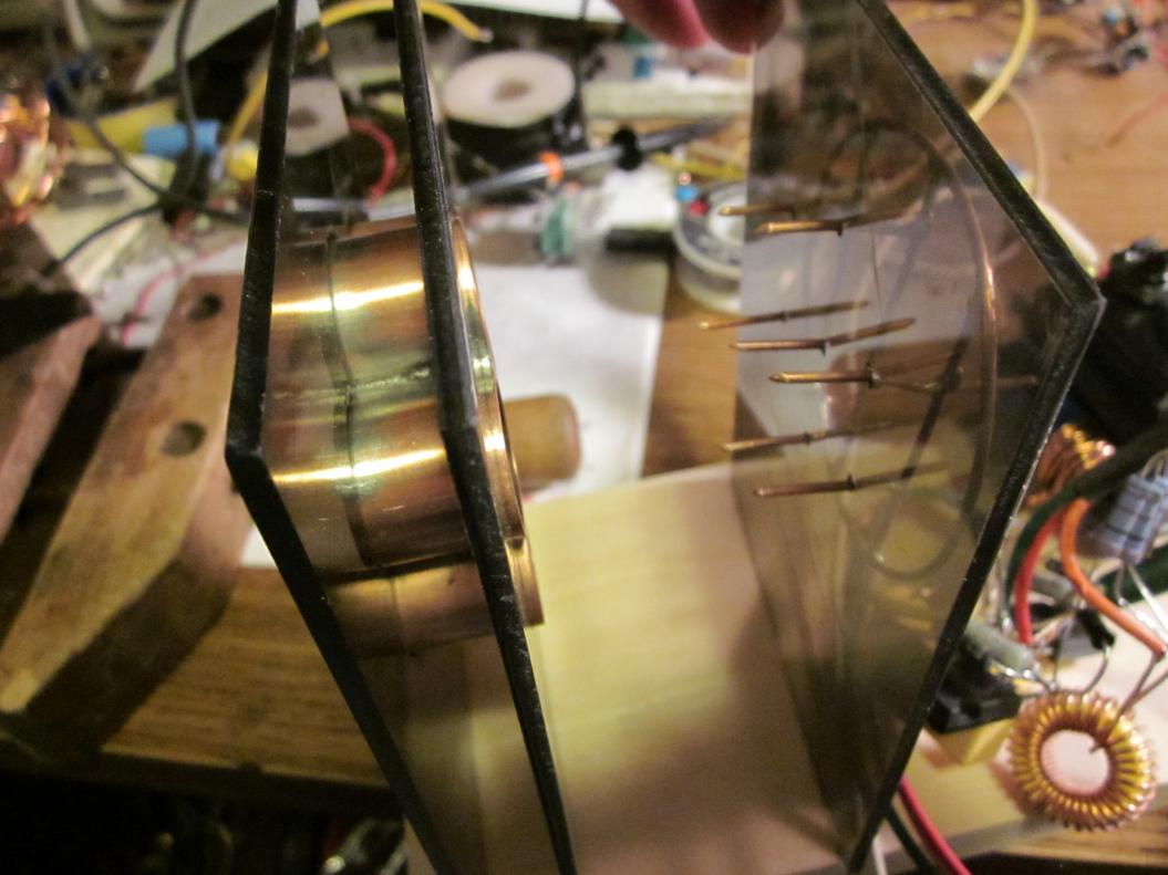

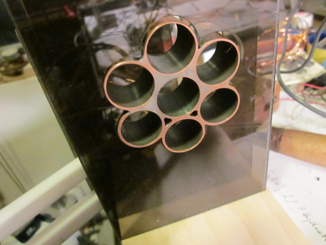

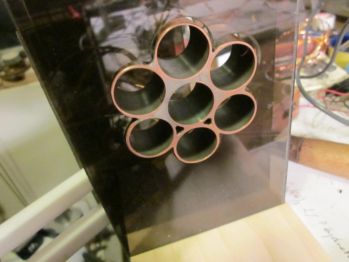

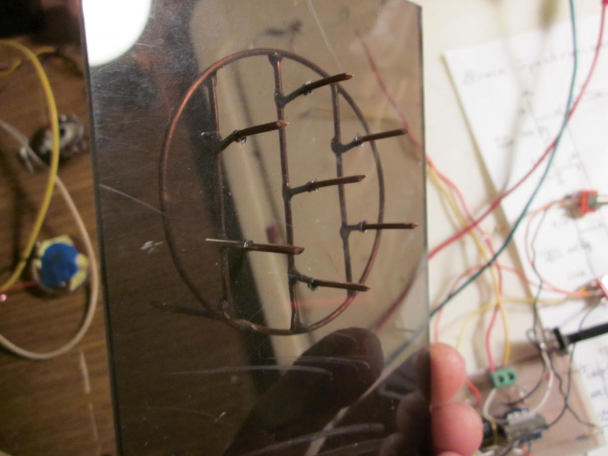

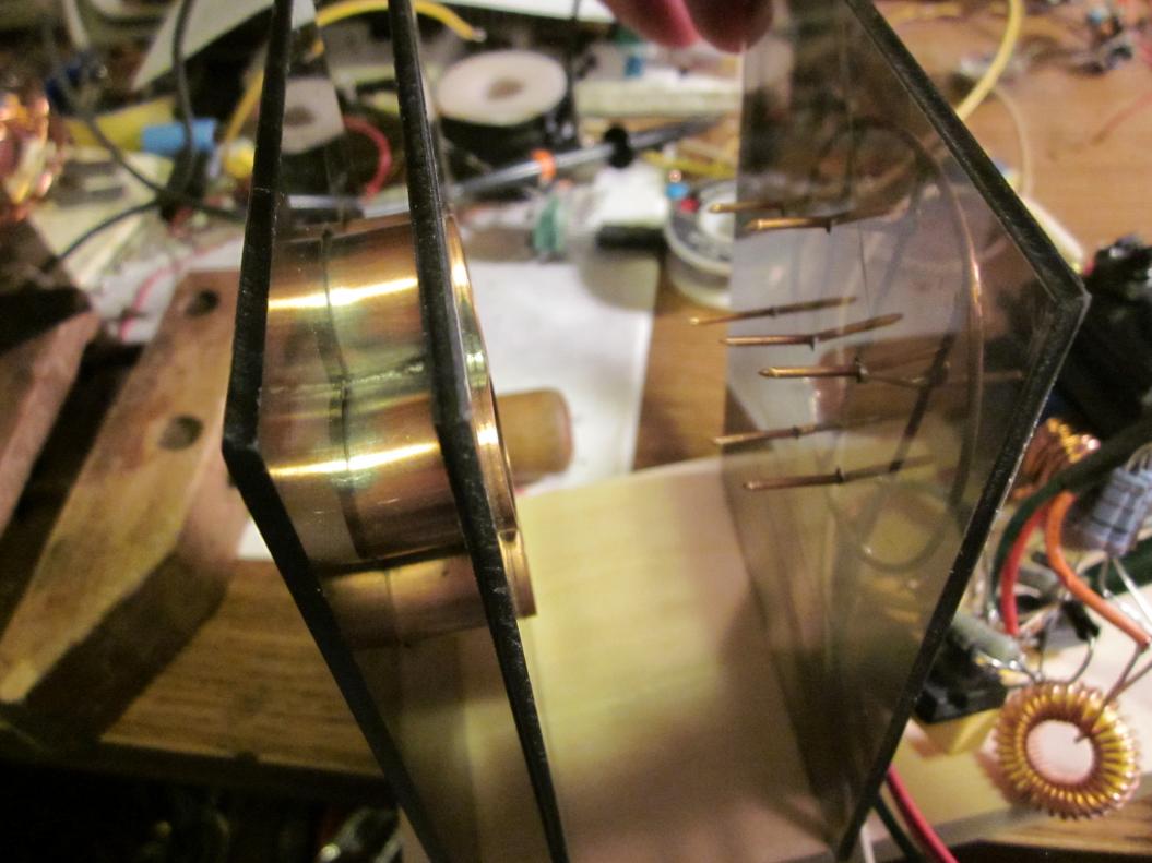

Target of my project is to make replicable device capable of cleaning air by using negative ions and small amounts of ozone. Also, capable of making ozonated water, oil etc.

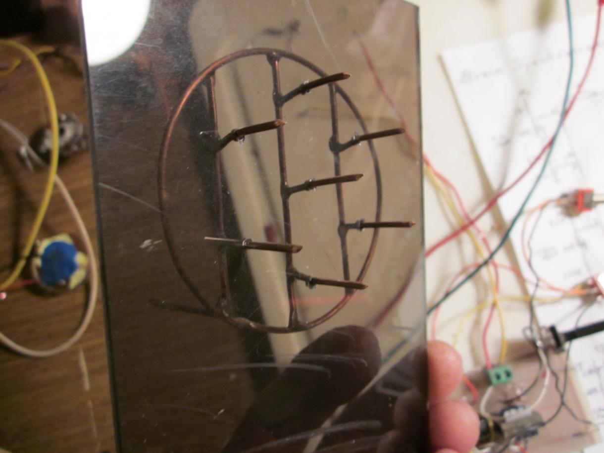

There is always more than one way to skin the cat and this case is no different. What we need is a source of reliable and tunable high voltage supply, launcher - in the form of electrodes or arrays and for second part - ozonated water we'll need a source of compressed air, such as fish tank pump and maybe even stone diffuser.

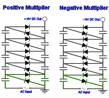

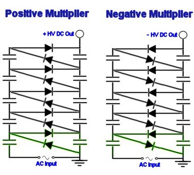

One way of generating HV would be by the use of voltage multiplier, such as -

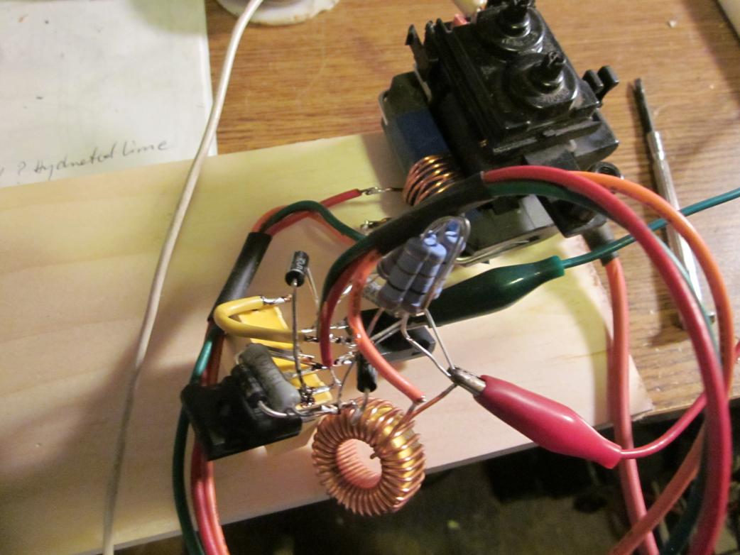

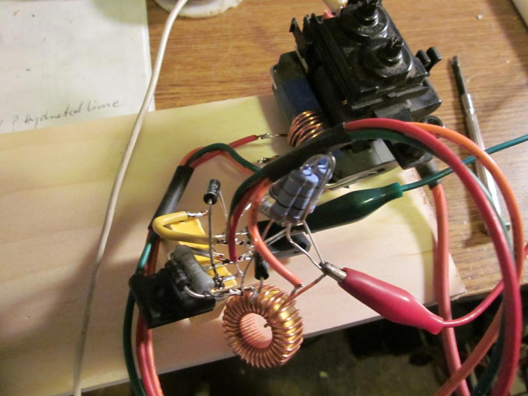

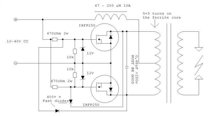

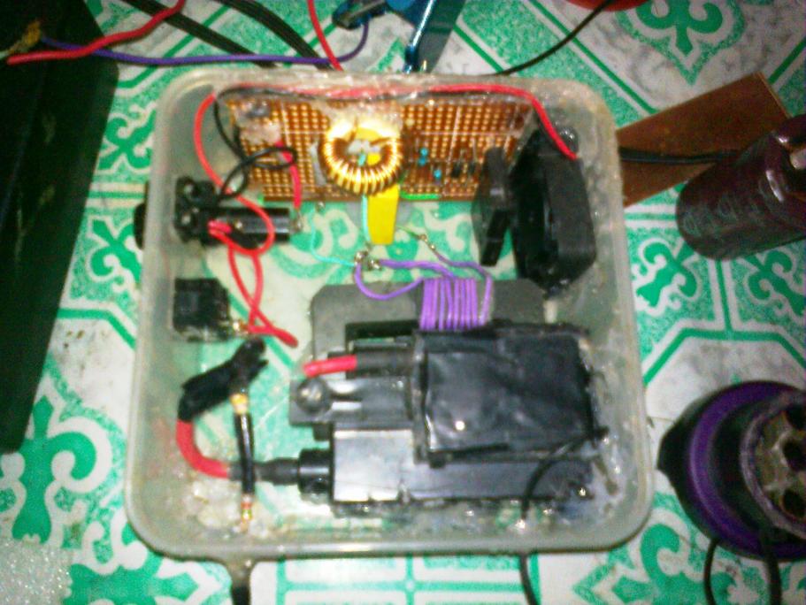

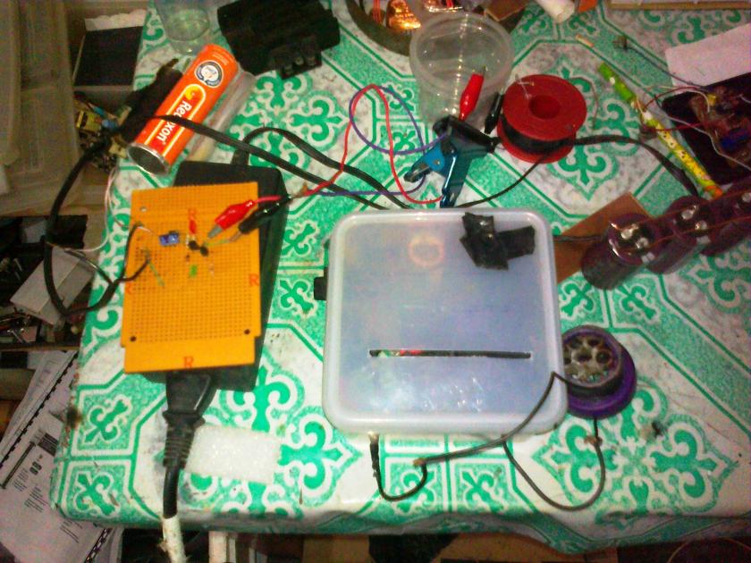

Second, which I decide to do is based on flyback TV transformer. They usually resonate in 20kHz range. Mine does at 28kHz and pulls 0.36A from 12V DC source. I'm not looking for spectacular purple discharge but just glowing tips of the electrodes for the creation of ionic wind rather than massive amounts of ozone.
Right now I've been running my driver circuit for the past few hours and it runs cool without heatsink on FET's. However, it is possible to run with more power and produce 2+ inch purple arc but this will cost about 4A and require transistors to be mounted on heatsink. I'm using small pancake coil connected to the scope probe to "sniff" the sine wave from a distance.

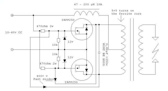

This is the circuit of flyback driver designed by Vladimiro Mazzilli-

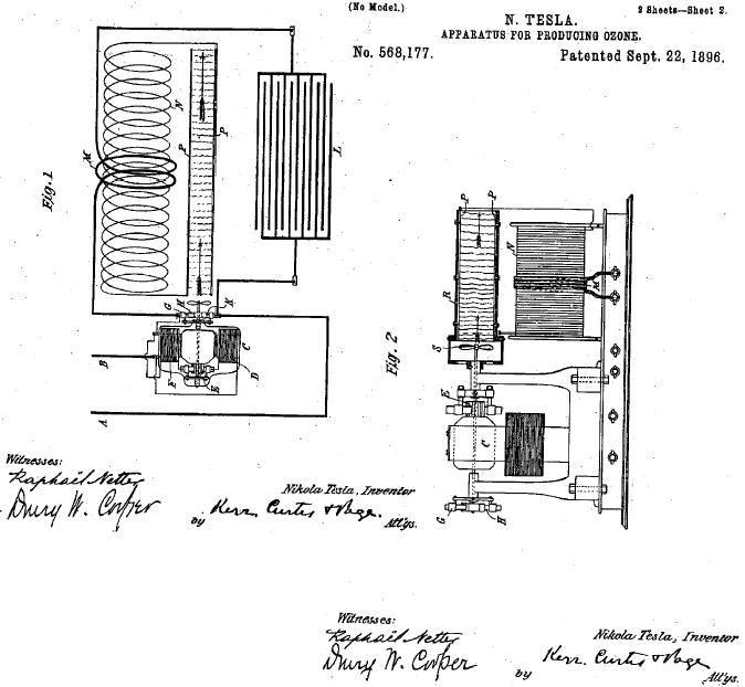

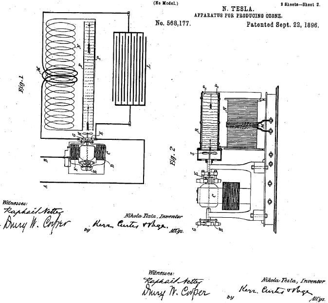

and patent of Nikola Tesla -
