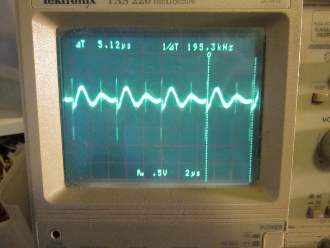

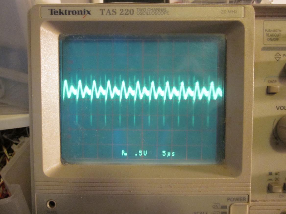

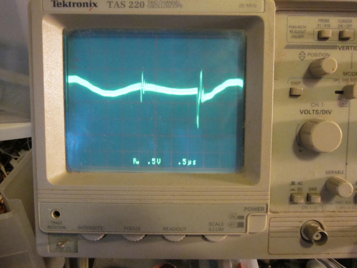

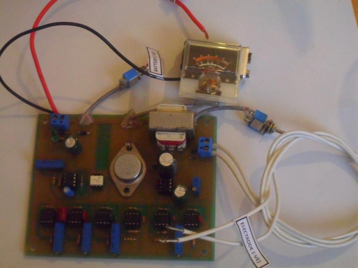

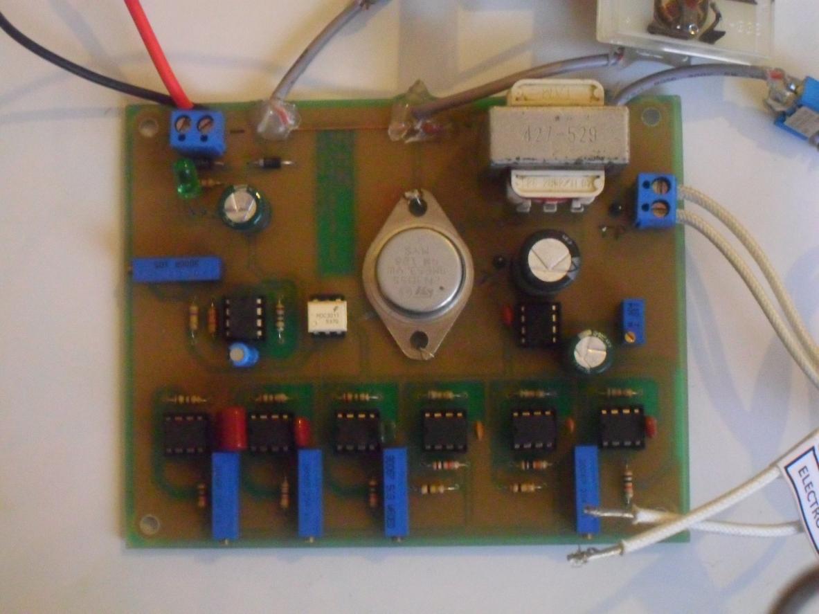

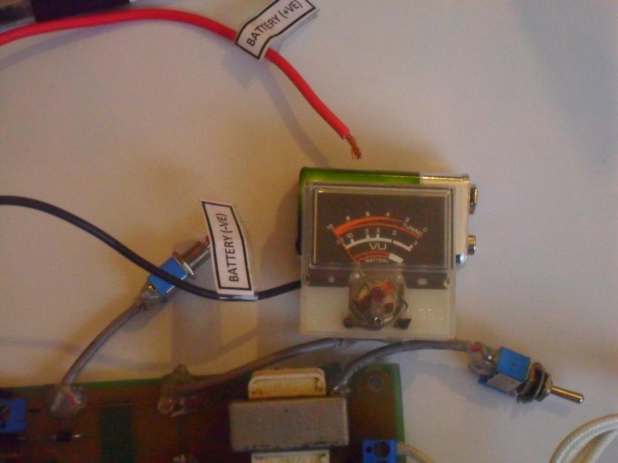

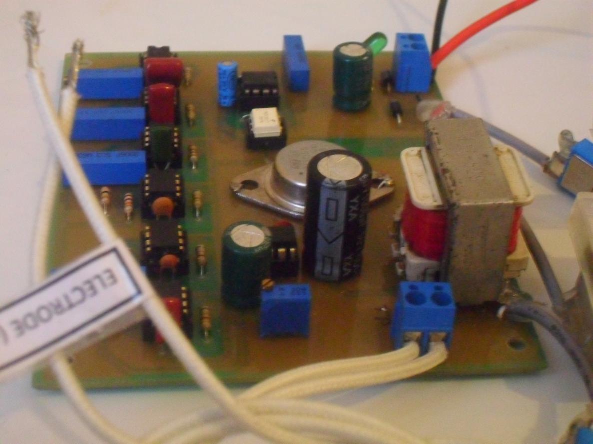

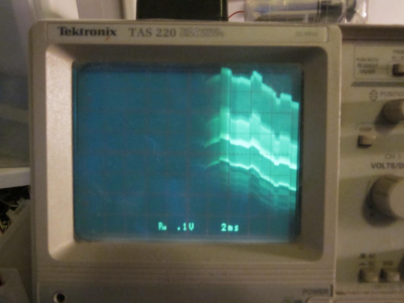

I can't tell if everything is connected right by looking at finished pcb but I believe that person which was helping you knew what to do. The only way to tell right now is to power it and check each oscillator with a scope, including 7th one - slow pulse, op amp and the output from modulator, after the transformer.
