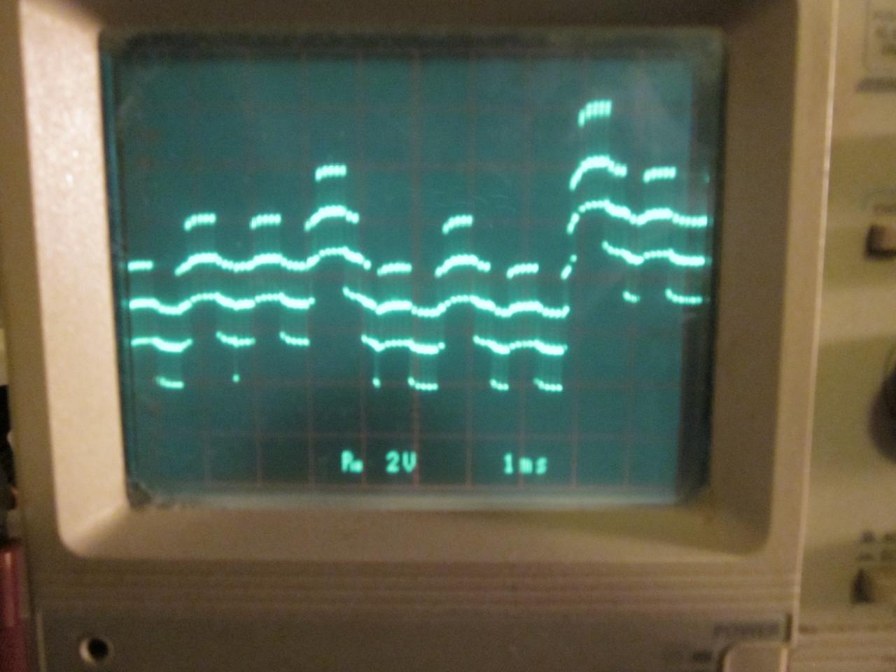

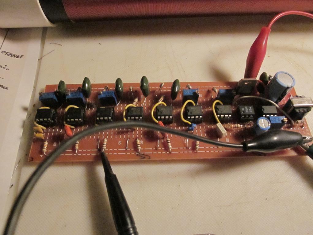

Hi guys. I've been busy today winding HV secondary coil (different project) and moving John's circuit from protoboard into pcb Got everything running. Oscillators frequencies and componets values as follows:
IC1 50Hz, positive to pin 7 150 Ohm and 250k pot, capacitor 200nF tantalum
IC2 150Hz, positive to pin 7 150 Ohm and 50k pot, capacitor 100nF
IC3 350Hz, positive to pin 7 150 Ohm and 50k pot, capacitor 68nF tantalum
IC4 800Hz, positive to pin 7 680 Ohm, fixed resistance between pin 7-6/2 100k, capacitor 10nF
IC5 8kHz, positive to pin 7 680 Ohm, fixed resistance between pin 7-6/2 10k, capacitor 10nF
IC6 20kHz positive to pin 7 680 Ohm, 250k pot, capacitor 2nF
IC7 7Hz positive to pin 7 150 Ohm, 1M pot/470k between pin 7-6/2, capacitor 220nF
and mixing line scope shot -
Scope shots of oscillators look like John drawing on the schematics.

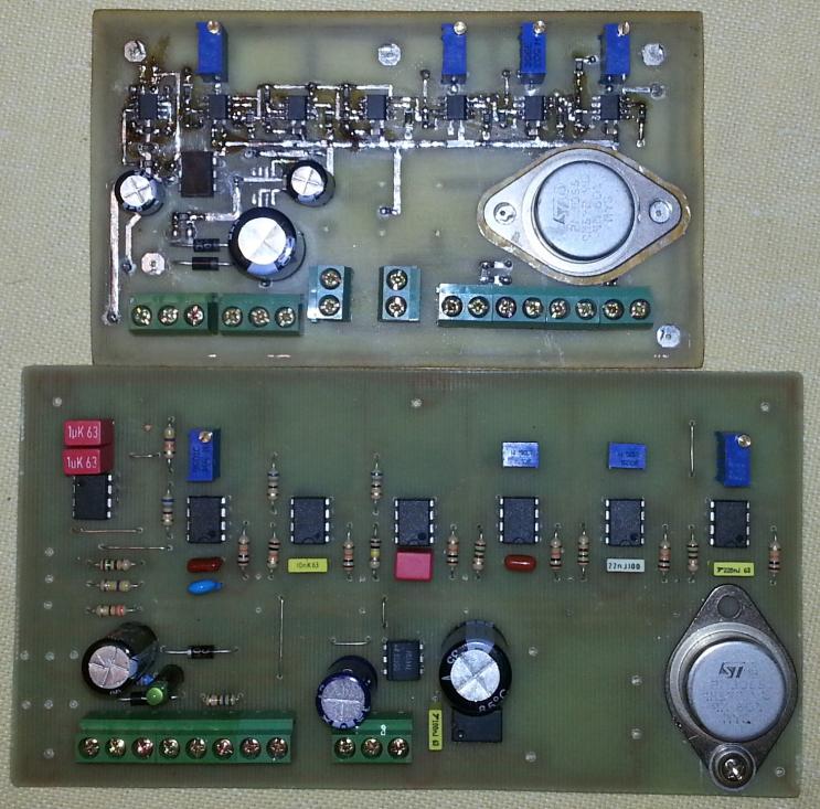

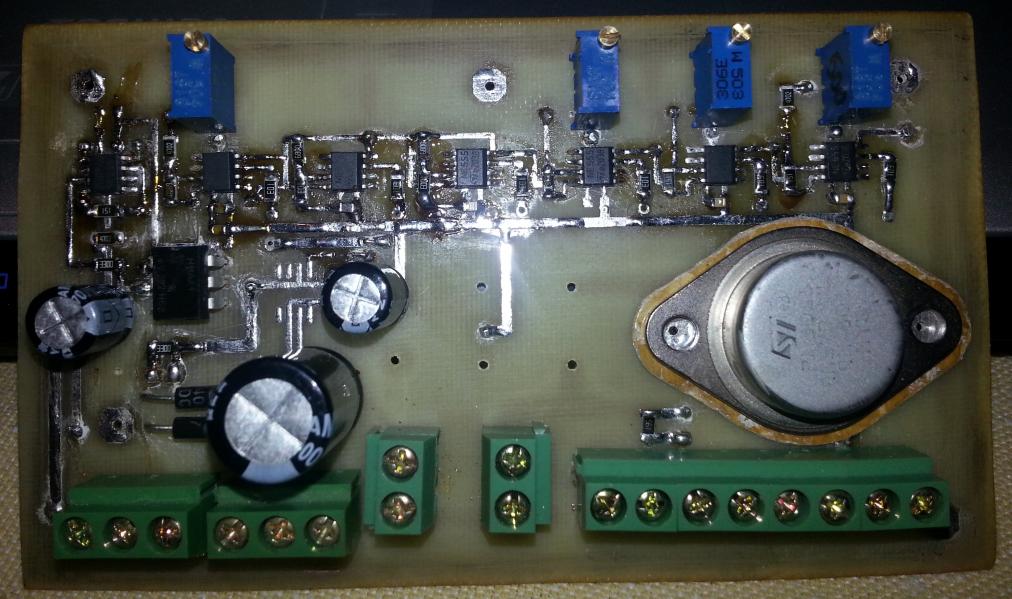

I have built this device while ago. Since you have one working as well, could you tell me what pulse rate range the last three oscillators are adjusted to? According to the circuit values the forth one will oscillate at approx. 153 pps, which I believe is not what is suppose to be, since pulse rates are going up from the first one - 50-150-350....
The fifth one will oscillate at approx 7,000 pps (or 7kHz) with components values as per diagram. Is this correct?
The last one suppose to be set to "highest frequency". How high should we go?
I understand that final tuning has to be done with help of microscope but I would love to have those ball park figures confirmed first. Upgrading microscope isn't something feasible for me at this moment but it will happen.

Well, there are no values of the pulse rate for the 4,5 and 6th oscillator in the schematics, except the remark that the last one should be set high. Components have their tolerance and individual results may vary accordingly.
John, if you happen to read this, could you please share those details?
Is there anyone else familiar with this device or having one working who could connect the scope to the last three oscillators and read their pulse rate?
I cannot believe that from all people who were at the Conference no one is trying to make this work or that I'm the only dumb one who can't figure this out.
Vtech
