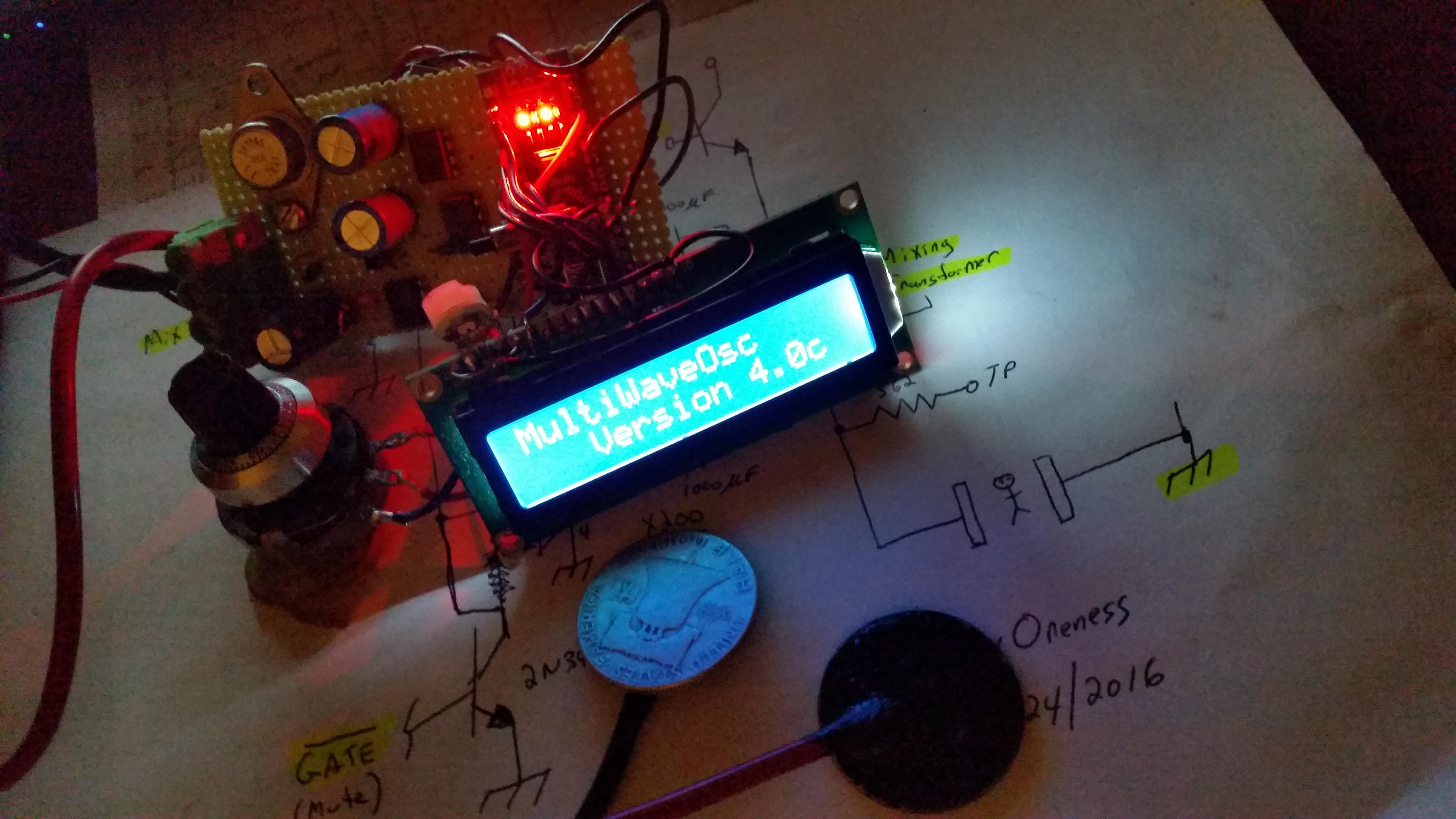

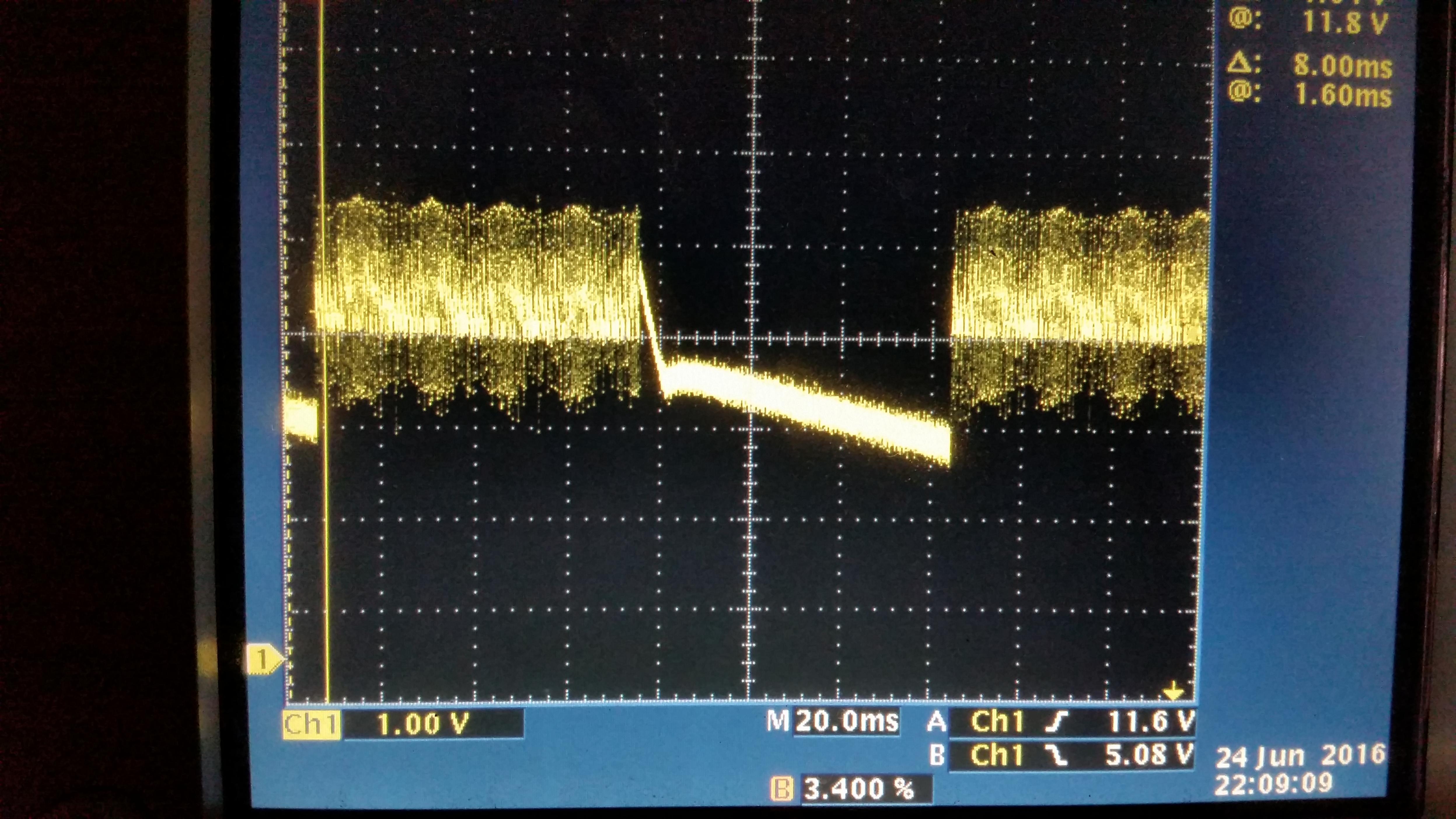

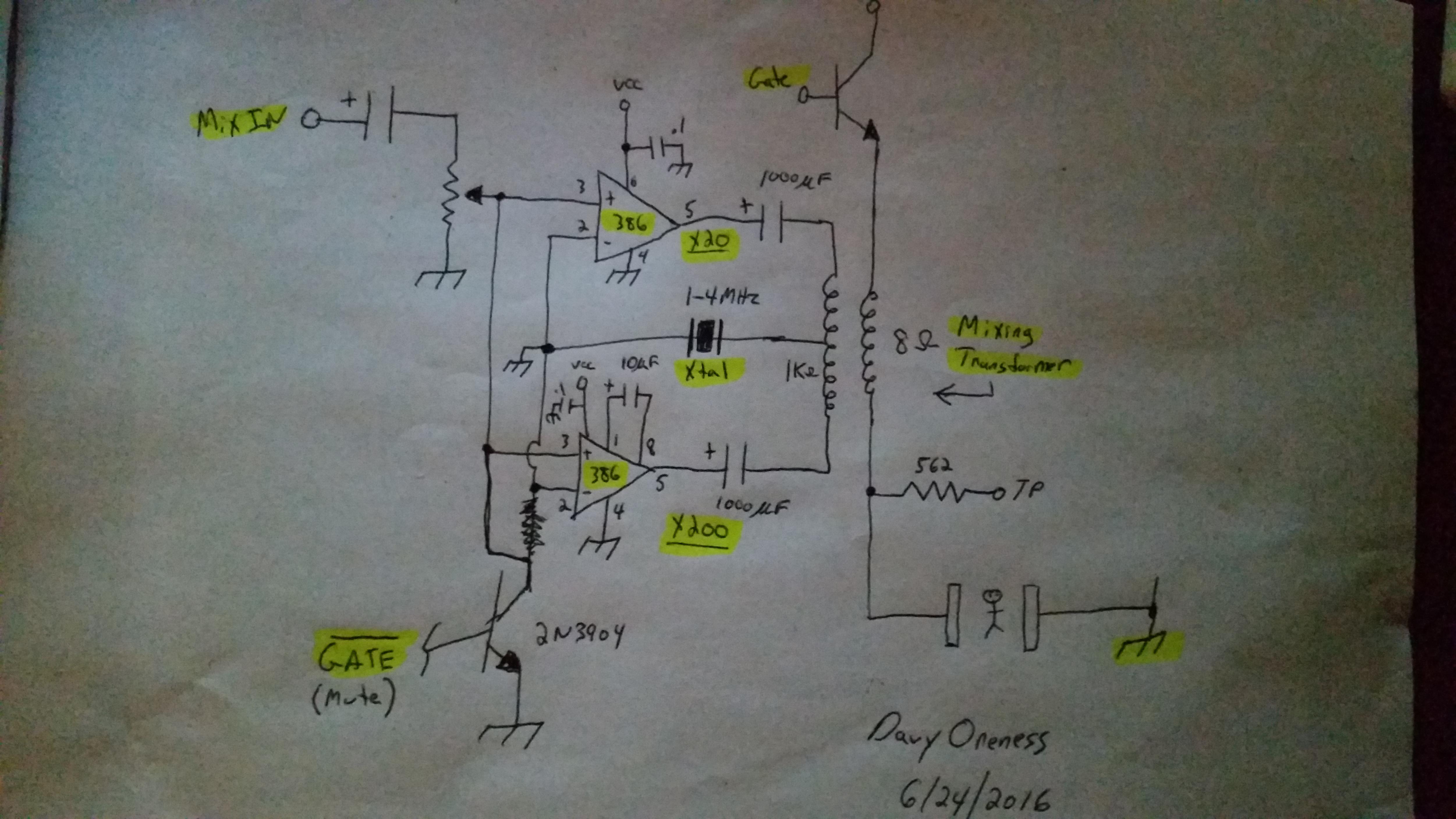

                            • Here is what I have found to give the closest looking waveform after working on this the past couple months. I figured out a way to use an arduino to output 7 frequencies at once, and though it is limited on precise freq settings due to the 16Mhz clock calculations, I feel it is close enough considering John says "any frequencies 10hz to 10kHz" . This also gives me the ability to work with different presets with different dominate frequencies and harmonics. The mixing transformer arangement I came up with was from studying the "Block Diagram of the Interferometer Oscillator" on John's "My Work page"http://johnbedini.net/john34/rife.html
                              He shows two out of phase amps, one is x10, and other is x1000. The lm386 datasheet had a simple cap addition to it for x200 amplification, so rolled with that.
                              Next I added the RF crystal(note: this isn't necessary though to get a similar wave form as on the schematic drawing from the two opposing amps mod)
                              I did the addition of the RF carrier based off the original rife work and also from patents like US 6321120 B1.
                              My electrodes are silver coins I soldered test lead wires to (had best flexibility for wire I had) and then coated with liquid electrical tape on back.
                              The positive electrode has accelerated oxidation(aging) from positive ions, and the negative coin is still just as shiny as the day I polished it due to the presence of negative ions. I also feel the shocking tingling from the negative electrode once the tissue gets charged up. The diode across the battery is important and should be looked at using in sg circuits. I also choose schottky diodes based off my tesla switch studies for all the diodes in my circuit, btw.
                              One last thing, I found I needed to mute the amp inputs with the gating signal so to have the quietest off times.
