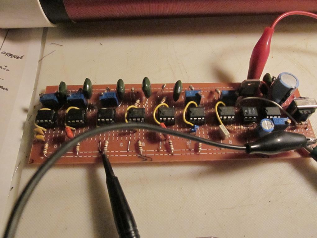

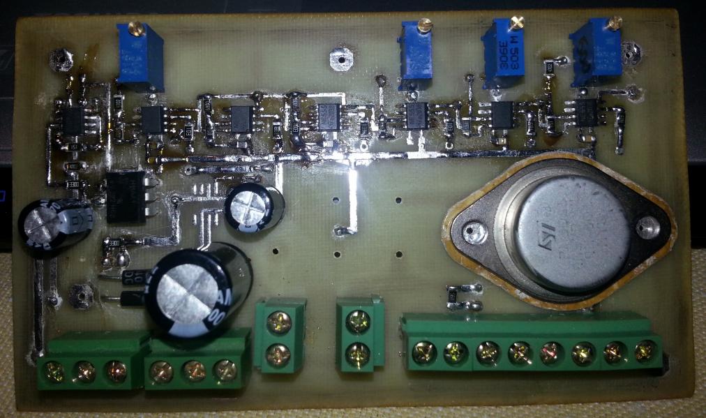

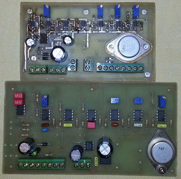

        • Hi guys. I've been busy today winding HV secondary coil (different project) and moving John's circuit from protoboard into pcb Got everything running. Oscillators frequencies and componets values as follows:
          IC1 50Hz, positive to pin 7 150 Ohm and 250k pot, capacitor 200nF tantalum
          IC2 150Hz, positive to pin 7 150 Ohm and 50k pot, capacitor 100nF
          IC3 350Hz, positive to pin 7 150 Ohm and 50k pot, capacitor 68nF tantalum
          IC4 800Hz, positive to pin 7 680 Ohm, fixed resistance between pin 7-6/2 100k, capacitor 10nF
          IC5 8kHz, positive to pin 7 680 Ohm, fixed resistance between pin 7-6/2 10k, capacitor 10nF
          IC6 20kHz positive to pin 7 680 Ohm, 250k pot, capacitor 2nF
          IC7 7Hz positive to pin 7 150 Ohm, 1M pot/470k between pin 7-6/2, capacitor 220nF

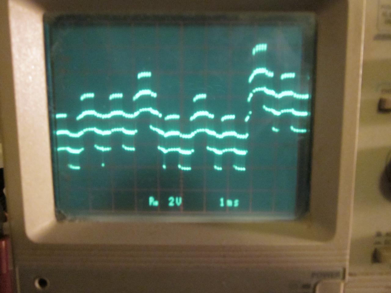

          and mixing line scope shot - Click image for larger version
          Scope shots of oscillators look like John drawing on the schematics.
