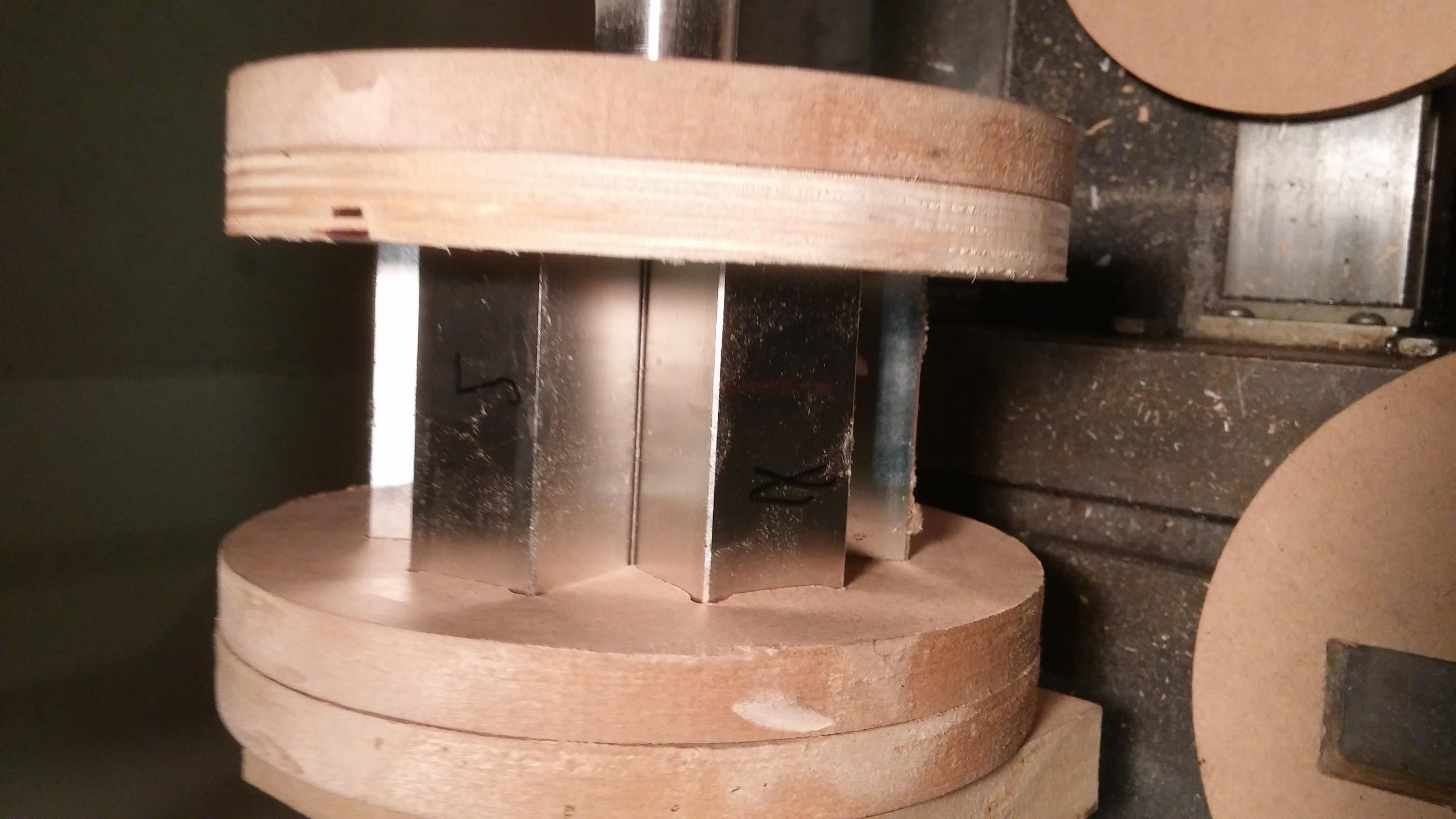

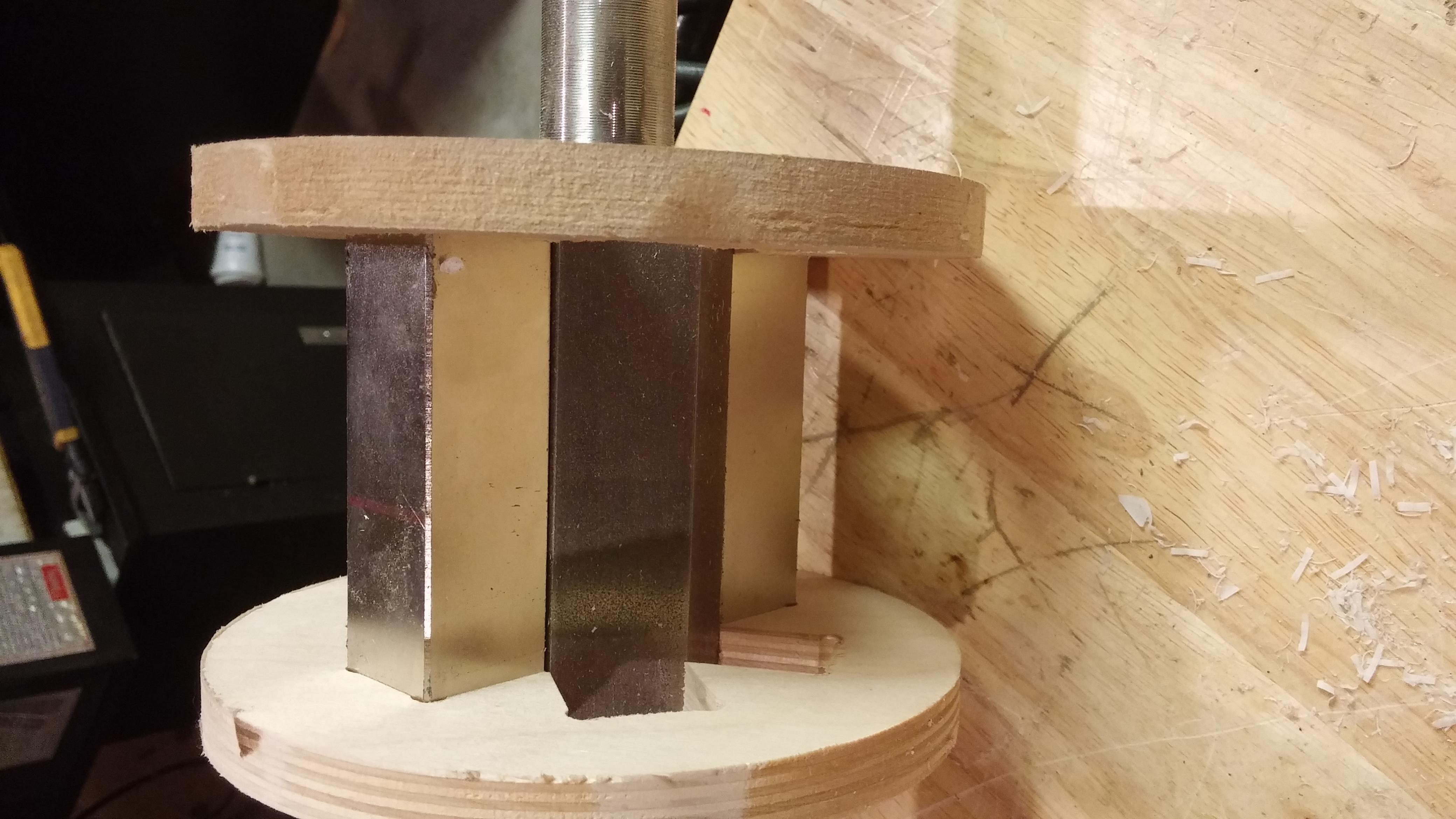

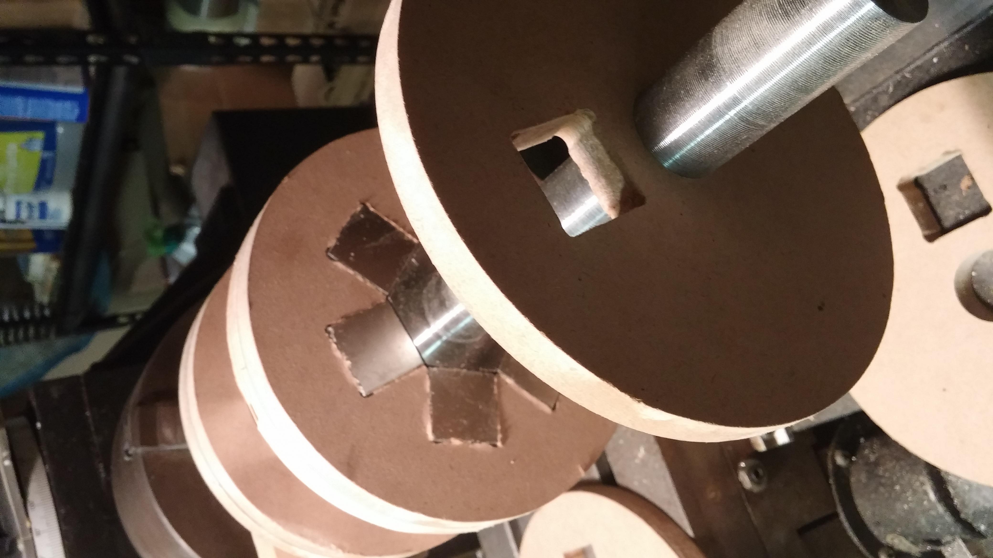

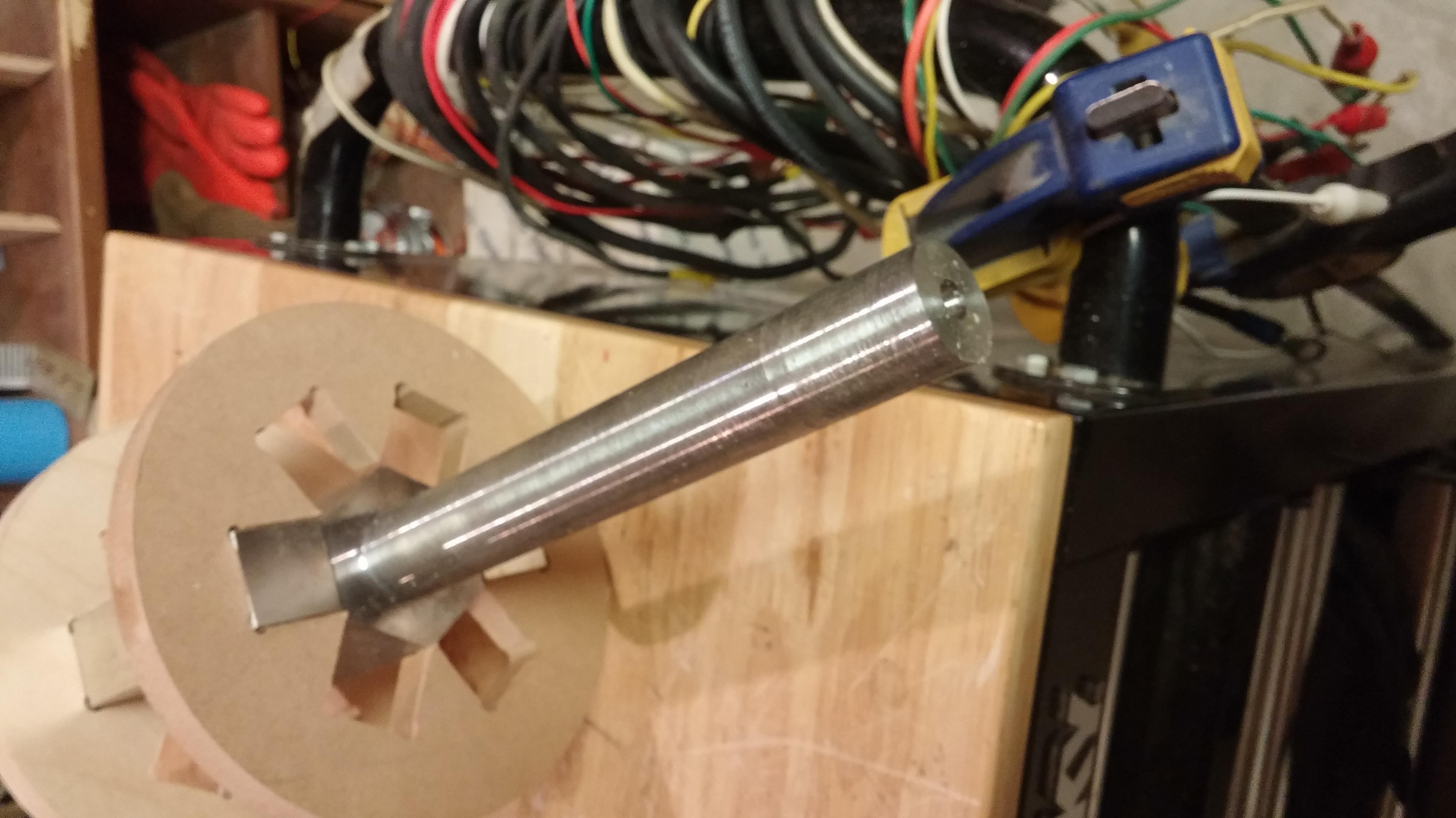

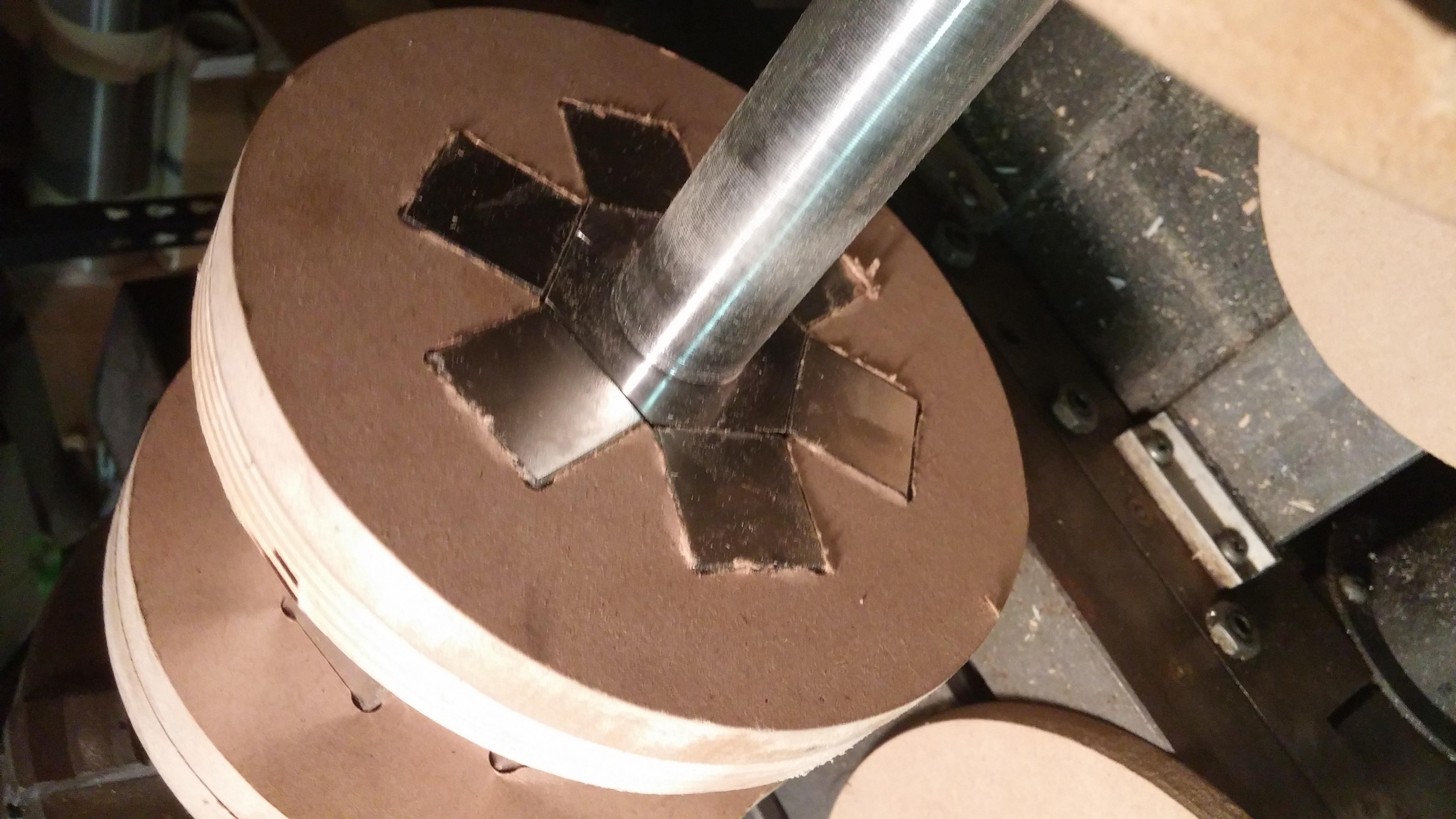

      Hi All,
      Was able to get the powerful neo mags in position.
      Made two jigs with CNC router.
      1. jig to hold position of mags on hex rotor.
      2 jig mounted (used 3 of these) on shaft to hold and position one mag.
      this jig allowed me to use tail stock of lathe to drive mag into position, one at a time.
      Shaft was mounted in 3 jaw chuck.
      bro d

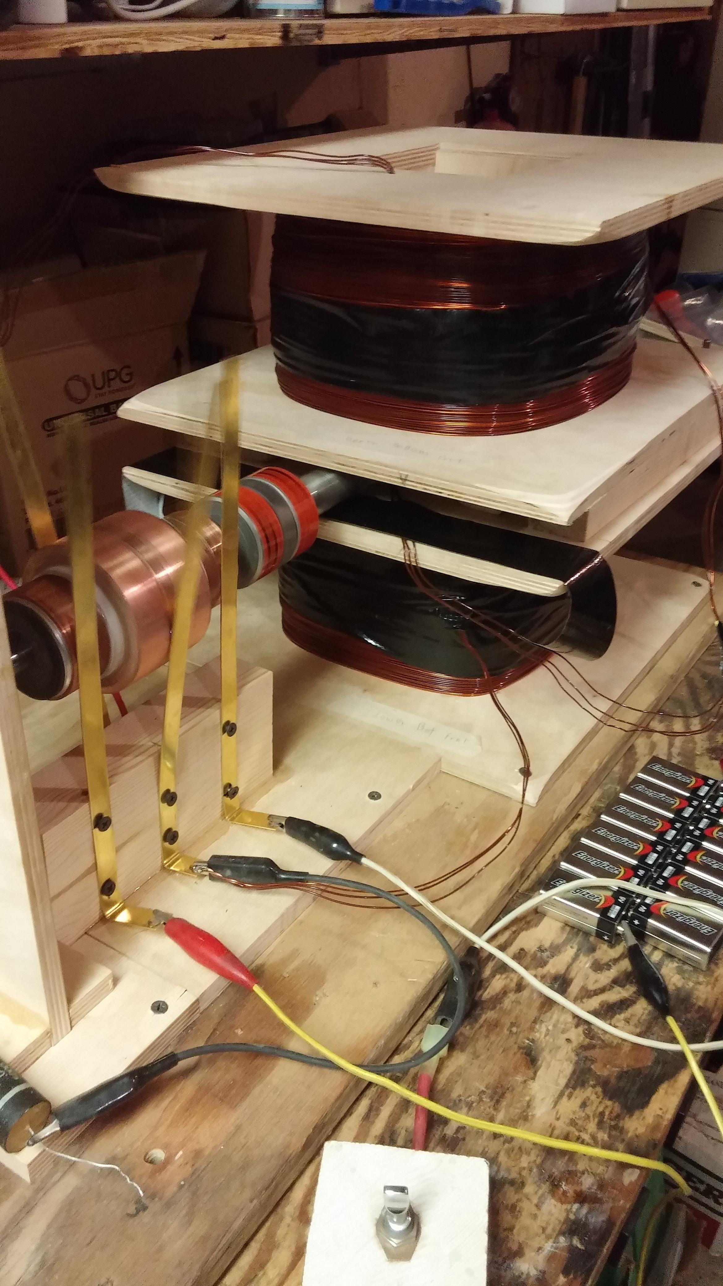

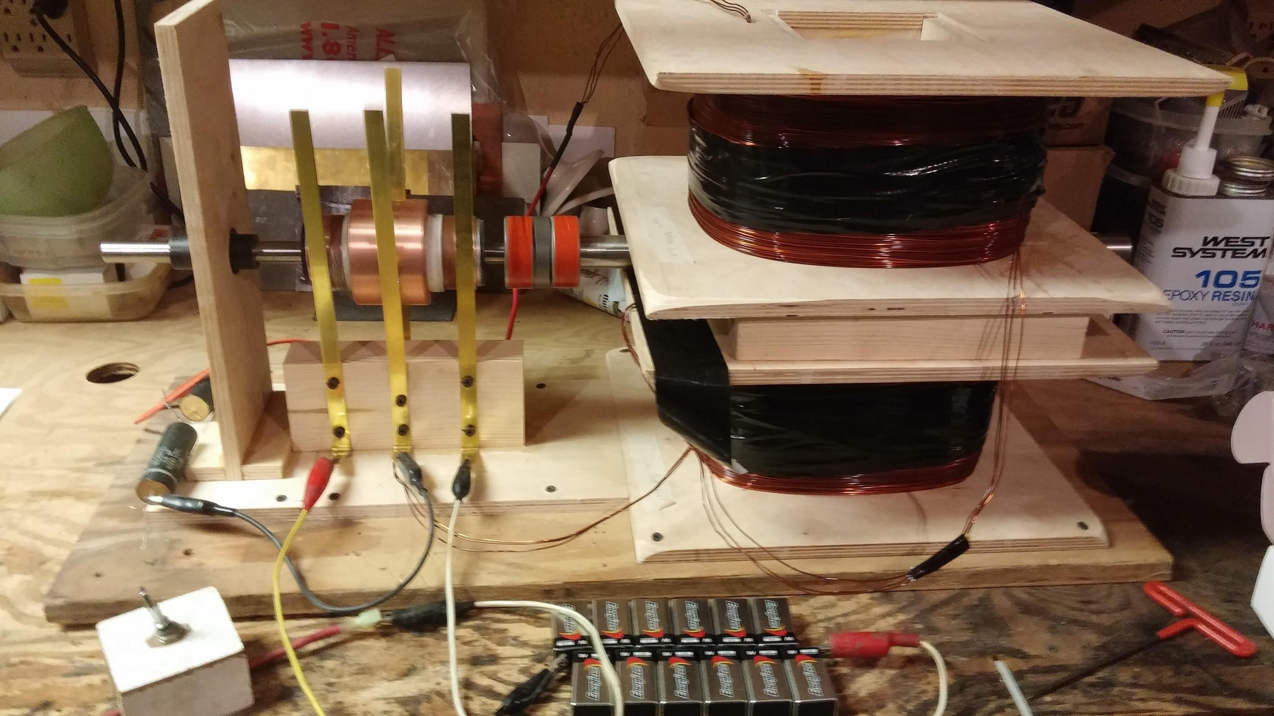

              Should be ready for smoke test by friday.
              The commutator is ready for the brushes and have lovejoyed it to rotor shaft. (5/8" to 1")
              Epoxy comes tomorrow to finish the rotor.
              Need correct caps.
              Keepin' on,
              bro d
              • #22
                Friday: The Small Newman passed the smoke test.
                Need help with caps.
                bro d
                • #23
                  4 micro wave oven caps (about 1uF X 2000V in oil) stopped the sparking at 70v and about 255rpm.
                  The batteries seem to be maintaining their present charge have to let it run.
                  bro d

                    • #25
                      Originally posted by brodonh View Post
                      Batteries are getting hot and running down rapidly.
                      Commutator drags it down.
                      Hi Brod,
                      How have you wired /and or wound the coils the top and the botttom coils?
                      they look trifilar each??
                      Your Capacitor are just about correct.. you can try a combination of series and parallel of the value you have.. this must be in parallel to the coils.
                      if your commutators are not working 'properly'.. the batteries are draining faster than they excite the coils(ON TIME)...you may also have to increase the number of turn in the coils this will increase the A-T (Ampere-turns) and also the input impedance to the coils for that DC Voltage (108V) and will drain the battery slower..but here is some learning... the Newman batteries would never drain if you had the coils correct in configuration.. another charateristic of the Newman motor is that it is more a Torque motor than speed..hence if you have a high speed motoring, it is way away from the Newman effect.
                      • #26
                        Hi Faraday88,
                        Glad to hear from you.
                        Are you feeling better?
                        60lbs of trifiler #18 wire.
                        I don't want to buy more #18 wire because I plan to use what is on the this Newman coil for another project.
                        I was mistaken about having 100lbs of #18 wire, only 60.
                        I'll get 100lbs of smaller gauge wire and replace the #18. (5-filer)
                        I'm planning the bigger motor now and I'll reuse the smaller gauge wire for that coil.
                        With fresh batteries I'm running @ about 325rpm.
                        bro d
