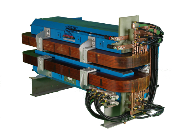

                        It looks like this company is well able to produce perfect Newman coils.
                        200lbs of #38 in a pair of coils that are sealed like rocks.
                        Doable.
                        bro d
                        Stangenes Industries specializes in advanced electromagnetic solutions for the manufacturing industry. Learn how our technology can elevate your processes.

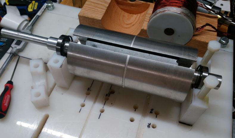

                          big neo issues
                          Hi All,
                          Gathering what I need to make a Newman motor that has the same dimensions as the Geoff M's build sheet except for length.
                          I got a hex bar shaft that is machined for just 4" of mags. Chose 4 x 1 x 1 neos (#45) They are brutal to handle.
                          It seems that the configuration of 3 norths together and 3 souths on the other flats, is a very difficult arrangement.
                          The mags very forcefully resist this arrangement.
                          I've cut a jig that goes around the hex bar and will only allow the mags into the proper slot.
                          Getting them in and secured is another matter.
                          Anybody done or doing this?
                          Wound coils of 60lbs of wire (I know, 200lb is required for the newman effect).
                          I'm setting up for the full blown motor except I'm doing this shorter one first.
                          Can get a lot of bugs out this way.
                          thanks bro d
                            Much respect for a big job.
                            I put 6" x 1" x 1" ceramics together by machining the rotor longer.
                            When I got a magnet in I pushed it almost half way out the other end then secured it.
                            This allowed the majority of the fields not to interact untill they were mechanically fixed in place. (one magnet did shoot out like a rail gun when I wasnt careful)
                            I had about 100mm of seperation and then I could push them in the slots by hand.
                            Im assuming you dont have slots and the magnets are monsters to handle but its the best ive got.
