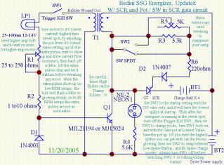

but these are in the collector circuit.
now, the light bulb being in the trigger circuit (to the base circuit of the transistor),if blows out would mean that the base would also be hit hard!! I use a 2 watt 630/470 Ohm base resistors in my SSG circuits to ensure they withstand the heat dissiapation.. (they run warm to the touch) I think one can use the light bulb in place of the branch(Global) resistor feeding the other resistors.
so a 15W light bulb is appropriate in this position.
