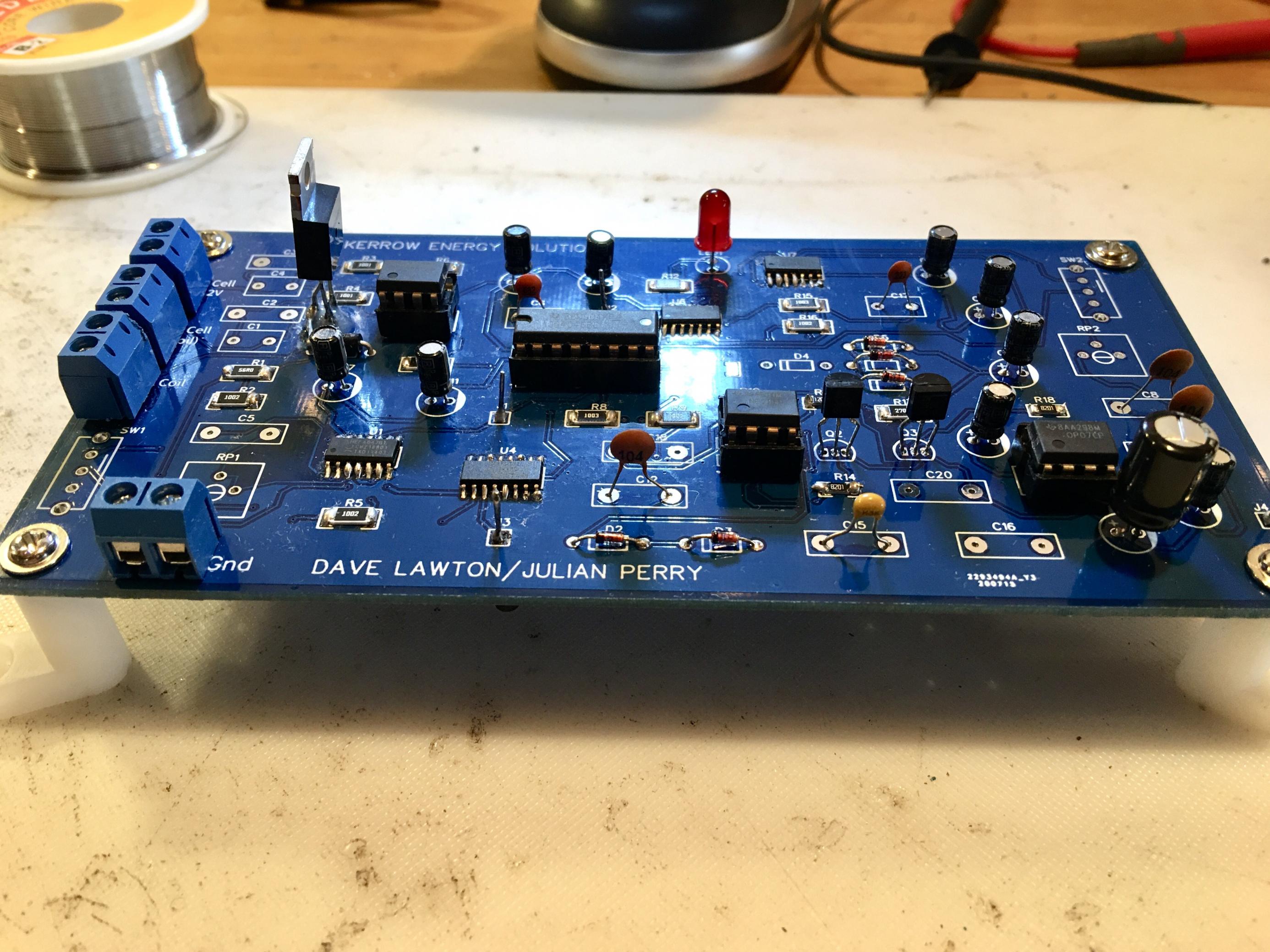

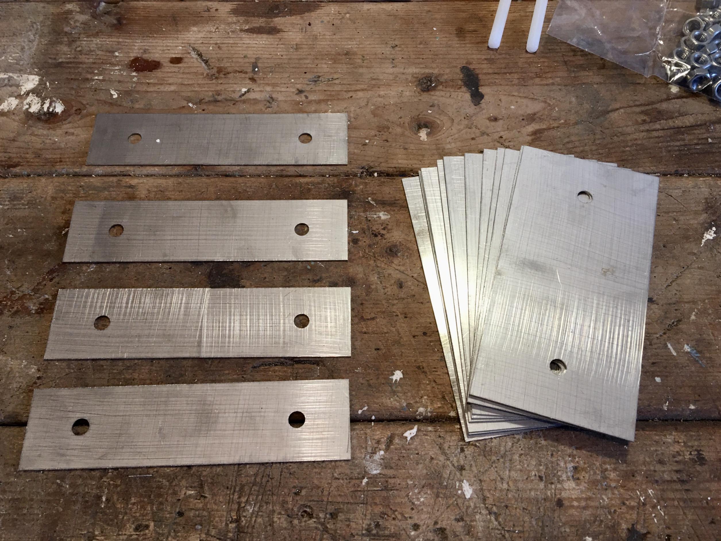

        A quick update on progress:
        The specially designed PCB has been received and is nearing completion ready for testing. The electrolyser and plates have been assembled and are nearly ready for the extensive cleansing and conditioning process.
        At the right time the PCB production (Gerber) files will be placed on the shared area for anyone to order it. They are amazingly cheap with the international postage costing more than the boards.

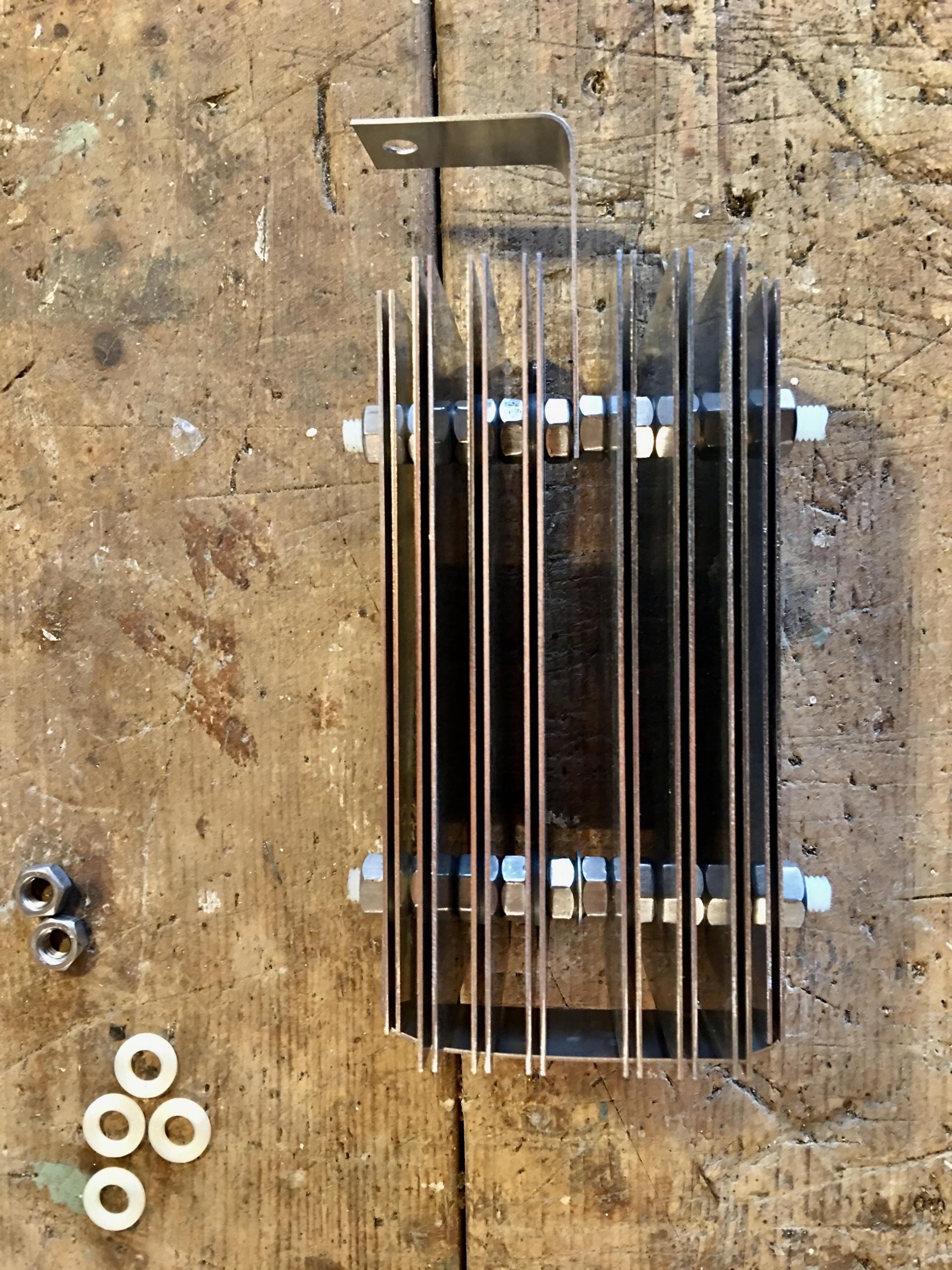

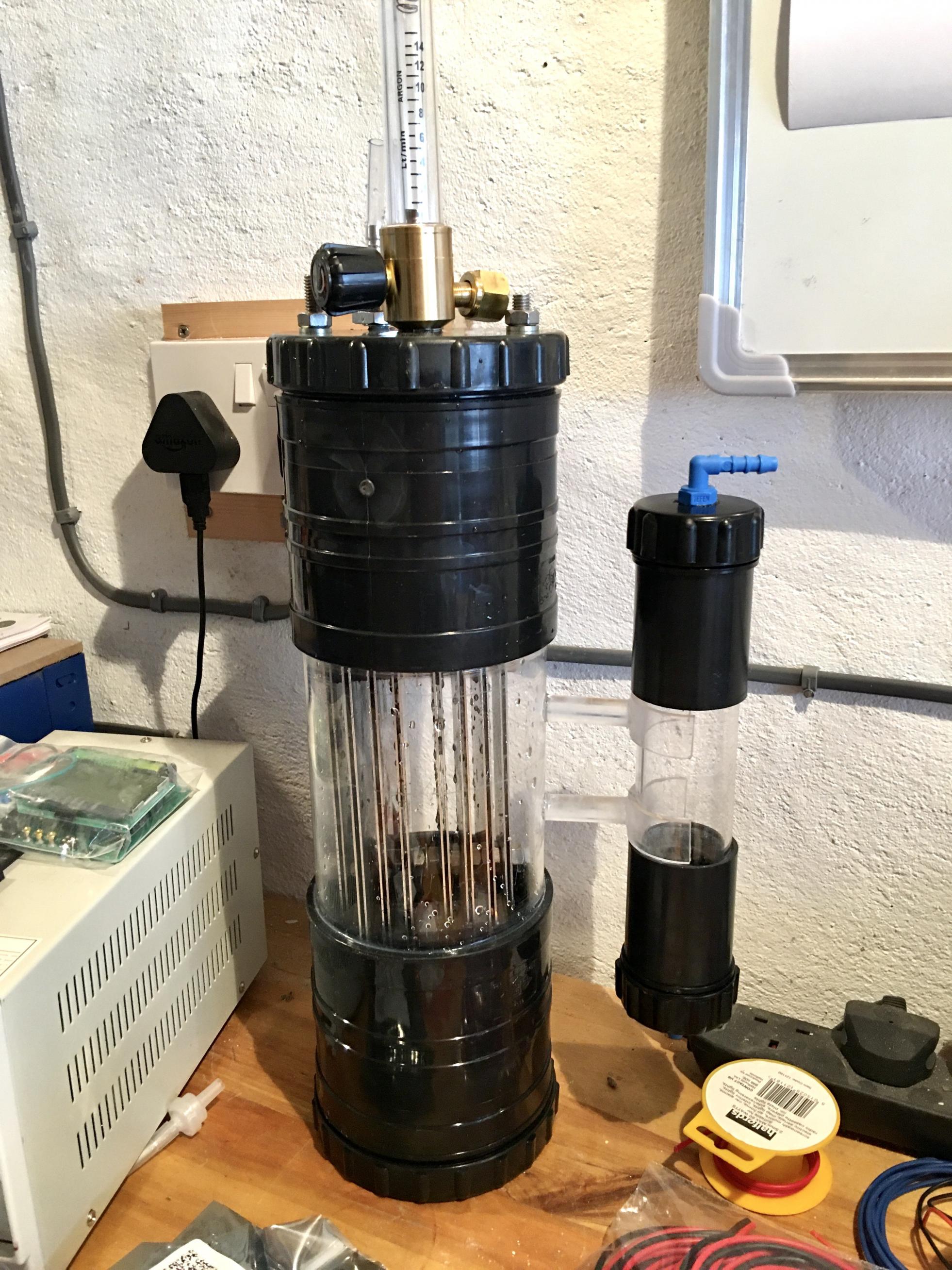

                    This is an update of progress with my electrolyser and related builds towards the overall aim of assembling the most efficient HHO and plasmoid generator so that an electrical generator can be run in a closed-loop mode. This will serve to demonstrate that additional energy is being brought into the system.
                    I have constructed the following, and which I will comment on further below:
                    • A multi-plate (Series-Parallel configuration) electrolyser
                    • A small single cell test electrolyser (for use with either parallel or cylindrical electrodes)
                    • Two custom power supplies (2-24V and 45-75V)
                    • Auto tuning pulsing unit (using Dave Lawton's/Patrick Kelly's circuit design)
                    • An output flow meter to measure gas production.
                    With the large electrolyser, I have been undertaking the onerous cleansing stage but after a total of 80 hours of operation, involving 20 cycles of 4 hours each, and changing the electrolyte for each session, the discolouration of the fluid continues. To keep the current at around 4-6A with a 12V DC supply, the concentration of KOH was reduced to 0.15% w/w. The fact that this red-brown precipitate continues to appear makes me concluded that it is not a result of something, like Chromium, being drawn out of the plates, but instead a chemical reaction of the KOH electrolyte during electrolysis. I am tempted to send a sample away to be analysed.
                    The notion in the various blogs that this precipitate will eventually stop appearing seems unfounded in my case so I have resorted to the technique used by Dave Lawton who advises me that I should apply 60V to the cell with distilled water only and run the cell for 30 min periods and then rest it for a few hours, and then repeat. This is conditioning the water more than the plates and I am starting to try this method on my small test cell that I have assembled, using a Kilner jar for ease of access. What I find works with this can be applied to the larger electrolyser.
                    The two customer power supplies are such that the 0-24V one can be used alone to run a cell in the low or 12V range, and it can also be used to supply the other PSU which outputs 45-75V for the conditioning stage. Once conditioning has been completed, and the gas output has noticeably increased, only then will I use the pulsing unit to supply the cell. In part, the small cell was constructed to test the pulsing unit - which it has been shown to work in ramping up frequency and output, but I need to scope it fully to see what is happening to the waveforms and of course its effect on gas production using the 'dielectric' process.
                    The flow meter uses the displacement method and has been calibrated to indicate when 500cc of gas has been produced to an accuracy of around 1%. Using a stop watch and a simple calculation, the output in lpm can be derived.
                    That is progress so far and related photos are at: https://www.dropbox.com/sh/yyxdclniz...fd7lQh7Ua?dl=0 (There seems to be a site error when I try to attach pics)
                    I have also included there a paper by Moray King entitled 'Is water the key to new energy' and who argues convincingly that the anomalous energy coming from HHO gas is not fully explained by the burning of Hydrogen but involves cohering ZPE via the charged water clusters. He goes into this in some depth and his theory is supported by various practical work including that of Walt Jenkins of H2GE.com who is developing an engine to run on water vapour alone in what is in effect a plasmoid engine. This is the leading edge of R&D in this area but it is being heavily suppressed and their site has been attacked many times and is currently suspended. I include one of their docs (H2 Global Report) for those who are interested.
                    If anyone would like more details of the design or builds of any of these constructions then I will happily provide them. When the day comes when I have a fully functioning system, I will provide full disclosure for others to replicate.
