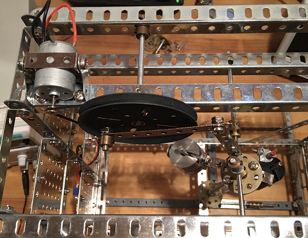

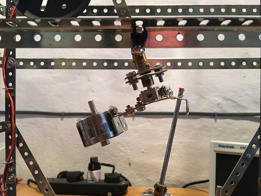

      I have spent the autumn building a small scale replication of the William Skinner device using Mecanno. My aim was to test the principles of the device, make a series of measurements of input and output power, using a classical dynomometer approach and to calculate the CoP.
      From this I planned to embark on a full scale replication with a view to producing a device capable of generating about 3kW.
      As it happened my experiments on the small scale device gave a CoP of 0.1 so a lot more energy was being used by the small motor to move the upper weights and the translation joint then was emerging from the output shaft connected to the lower weights.
      This was a big disappointment and very surprising but I have to stand by my results in the scientific approach.
      If anyone would like to read my 4 page report and see the video of the device then these are available at: https://www.dropbox.com/sh/bws0akodi...fIdN6zVZa?dl=0
      Thoughts and suggestions are welcomed.

        Jules, thanks for posting your work. I just downloaded the report. You're right about the small scale vs large scale friction losses. The bigger it is, the smaller the friction percentage per bearing, etc.
        I know someone that has a full size 4 quadrant unit - he just has to add the elliptical input mechanism. I'm looking forward to the progress and hope to be able to report something.

            I noticed in the video that Skinner's device used four weighted shafts for the output and only one input motor. It also looks to have less inclination on the lower rods (with the output weights attached) and the center of gravity on the lower weights seem to be higher from the bottom attachment point than on your model. I assume that the ratio between the mass of the top and bottom weighs is very important as well as the angle between the center of orbits of the top and bottom shafts.
              Hi Gary,
              My small scale device did not replicate all the features of Skinner's original system. You rightly point out some differences but I argued that the key issues of the independently moving upper and lower masses, a greater than 2:1 mass ratio and the elliptical movement of the translation joint should be sufficient to at least demonstrate a CoP around 1 or even a bit under. While raising the centre of gravity might help I did try stacking more weights on the bottom which both increased the mass and raised the CoG but that also required a lot more input power on the small motor to keep it running so I found a happy compromise of all those factors, including the long shaft angle caused by the upper mass orbit. The fact that the CoP was way down has to be due to something else and I proposed that the friction losses will be much higher gram for gram with a small device than a 30kg or larger system and that may or may not be the key.

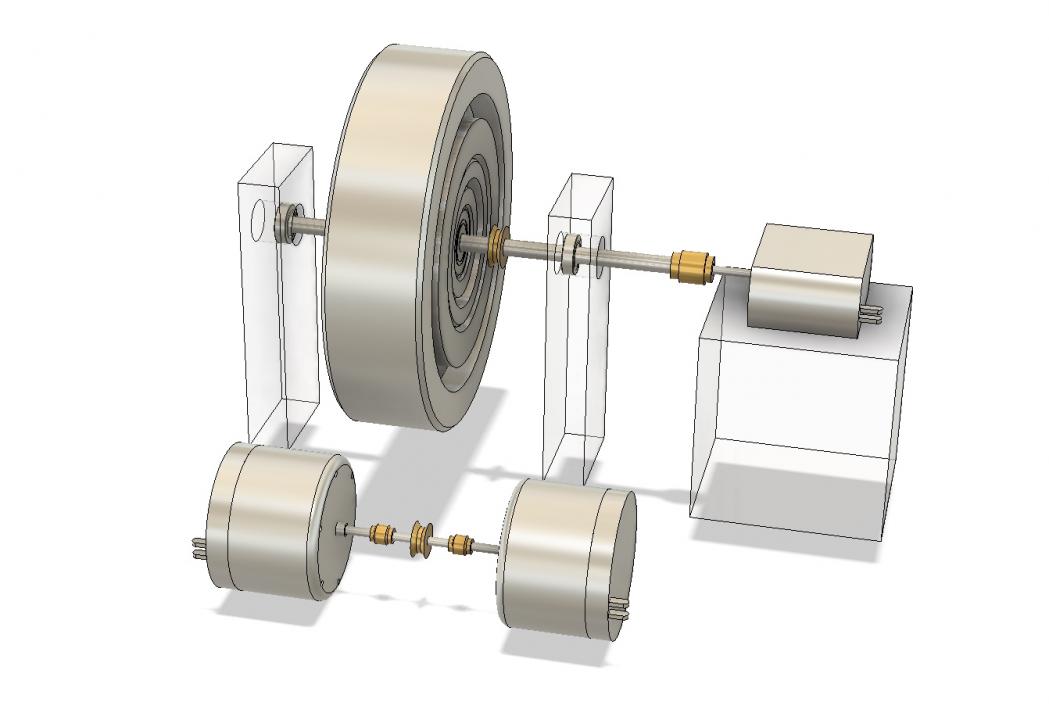

              I'm turning my attention to a pulsed flywheel system of the 'Chas Campbell' type of which there seem to be many variations. There seem to be loads of videos out there showing failed attempts and a few allegedly successful ones and in this technology it seems that the critical element is the intermittent impulses applied to the flywheel, either by some electronic system or by a loose jerky drive belt - there are those pulses again! There is hardly anything on the Energy Science Forum about this type of device but as I develop something I will report it under the 'Mechanical Amplifiers' section.

                      Would it be possible to start a new sticky thread entitled something like: 'Pulsed Flywheel Systems' to distinguish it from the Skinner type system? I have some papers by Lawrence Tseung, who may have retired out by now as I have had no replies to communications with him, and who was the major exponent of Gravitational Lead-Out Theory which he argues is behind the OU results of his Pulsed flywheel systems in China. They had several universities dedicated to such research and correlate the theory with the same principles applied to magnets via electron motion.
                      I would like to put up some of the papers I am reviewing to help set the theory framework, which is what I do anyway while considering and preparing for a build.
