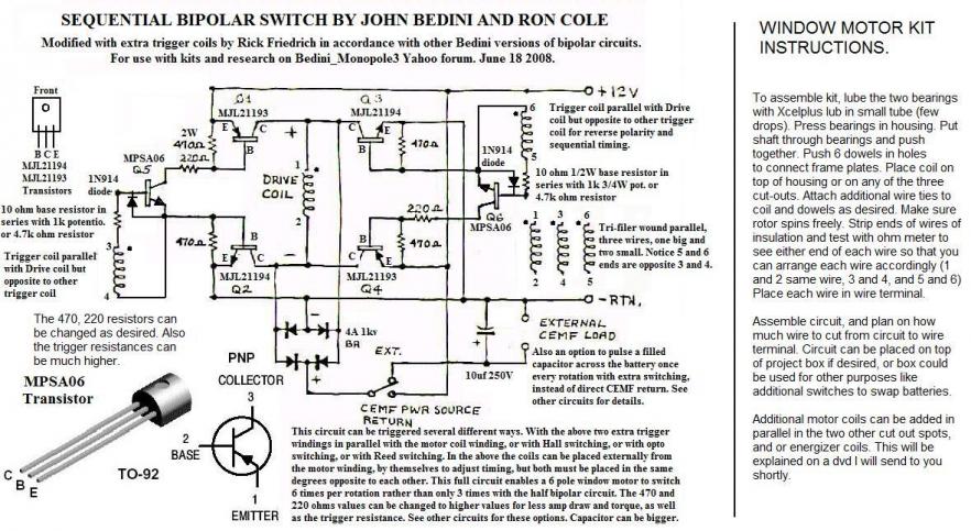

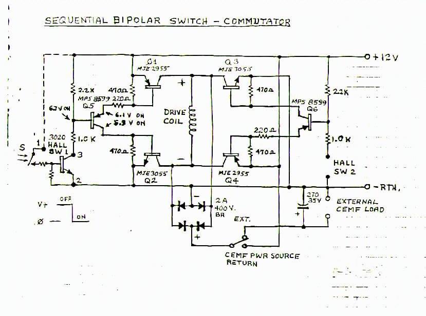

the full bipolar circuit is the way to go for driving, with a Hall sensor and timing disc.
