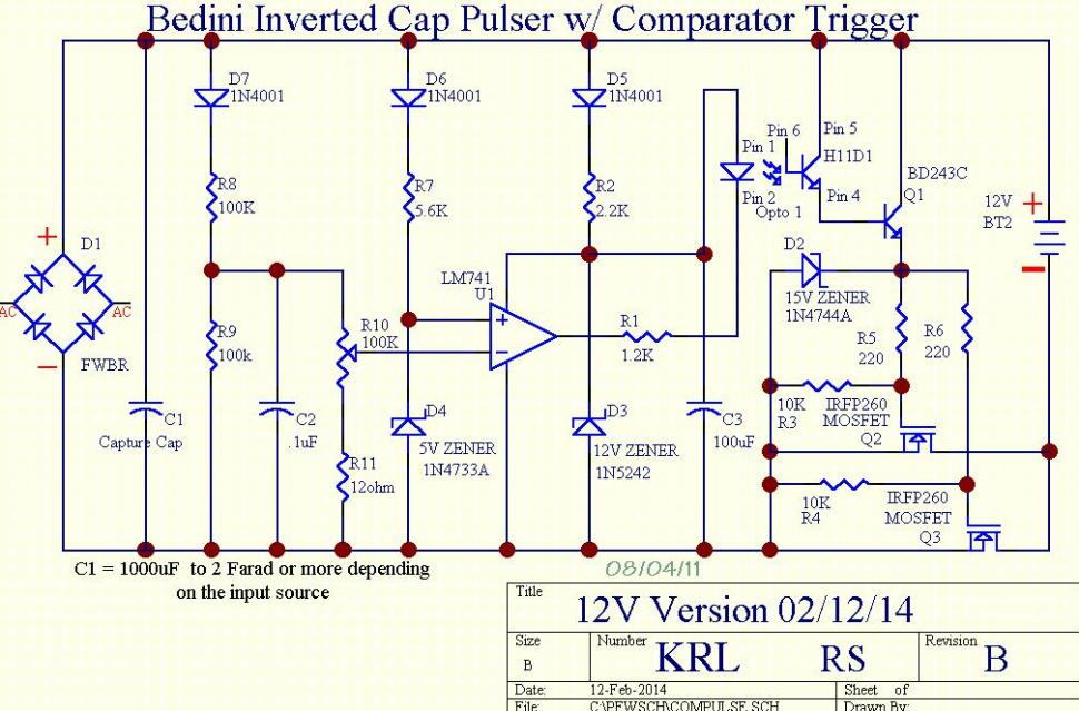

        Hi,
        Just found this thread.........
        here is the standard Bedini Comparator Inverted Cap Pulser Sch....
        works very good, you should give it a try.......
