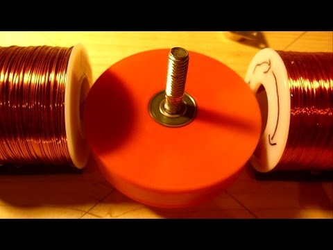

                  How does this look, I have others that show the neg spike more pronounced, have to look for them a bit more.
                  • Patrick,
                    Nice video, but not quite what I ask for....
                    Can you see the negative current flow at turn on, using a 5A 75mV current shunt, with a scope across the shunt where you would normally put the current meter? Measure without a meter (just a 75mA volt meter)on the shunt, as your scope is the meter.... Not across the transistor collector / emitter voltage.....
                    some units show it real good and a very high neg flow for a long time, some other units show it barely happens.
                    do not try to look at the voltage across the collector / emitter, while looking at the current flow across the 5A 75mA current shunt with a duel channel scope, your scope will not like that.....
                    I have found that some models of hall effect (non invasive) current sensors work good for seeing this neg transistor current effect, and you can still see the collector / emitter voltage on the other channel....
