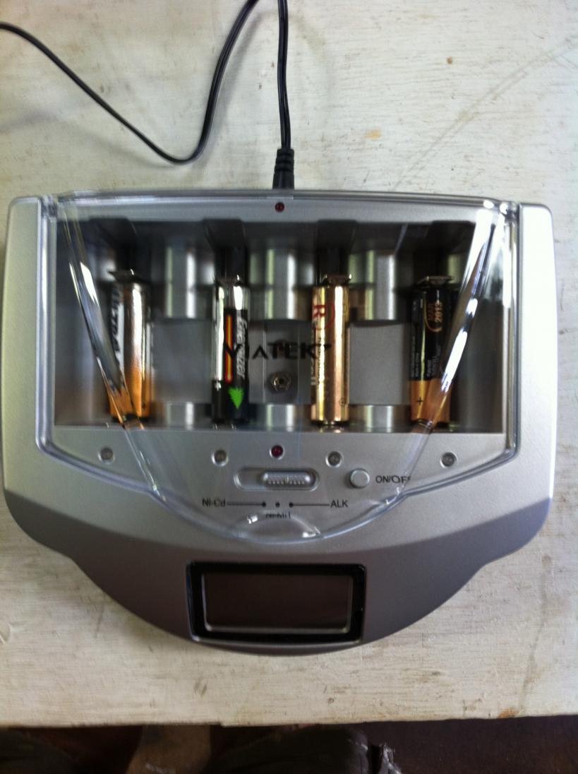

            Mr.Bedini
            In your video you said that you trash your ALK batteries.
            I have been charging them up with this charger, and have also put 20amps on any ALK battery until [COLOR="#FF0000"]HOT[/COLOR} and it charges the batteries up also.
            Have been doing 20 amp. charge thing, when I was 8 years old.
            What do you use for your potting compound?
            Thank You

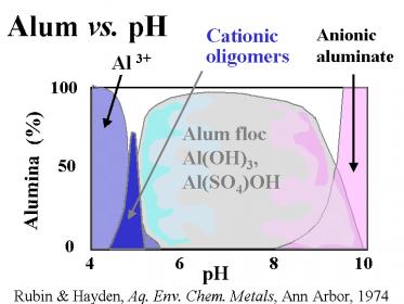

                        Composition: Papermaker's alum is aluminum sulfate. Concentrations and addition amounts are usually based on either (a) the equivalent amount of Al2O3 or (b) the equivalent amount of the hydrate, Al2O3.14H2O. Alum is most commonly delivered as a liquid concentration, having a solids level of 8.3% as Al2O3 or about 50% as hydrate. Alum solutions are acidic. For instance, a 1% solution has a pH of around 3. Ionic species present in alum solutions are highly dependent on the degree of reaction with hydroxyl ions. It is tempting to say that "the composition is pH-dependent." However, in the vicinity of pH=4.3 the composition of alum solutions changes a great deal with very little change in pH. At pH=3 and lower the main species is a hydrated form of Al3+. At a pH near to 4.3 there may be oligomers such as Al13O40H487+ or related species that contain sulfate. In a broad range of pH between about 6 and 9.5 the main species will be Al(OH)3 (and possibly related species that contain sulfate). The soluble aluminate ion predominates at pH values greater that 9.5.
                        It is important to mix enough Alum. I hope to post a new video tomorrow on a lead alum crystal without growth so far. We will see how it goes.
