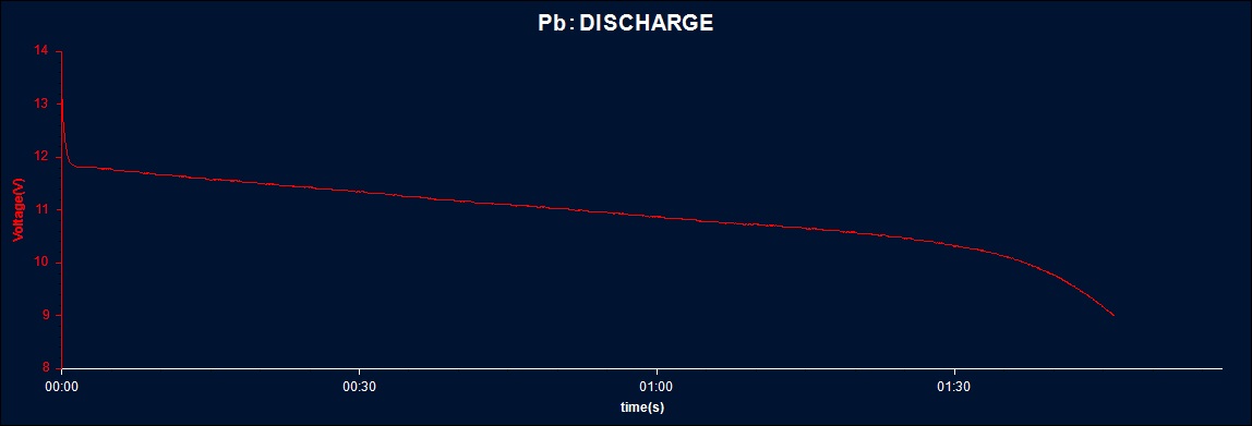

                    Here is first discharge curve. I hope the battery capacity will increase after few cycles. For discharging I used two 45W halogen car light bulbs connected in parallel. I let it discharge over night and in the morning it had around 0.7V. For the voltage graph I used my smart rc charger.

                        George's battery is no longer a typical lead acid battery. My alum batteries flatline between 7-10 volts. How big of a battery did you convert Geroge? 2*45=90 watts/12v= 7.5 amps of discharge (that is a heavy load) for 1.5 hours then it drops off. rule of thumb, c20 discharge rate is ah/20, much nicer to battery. Al

                          My battery is (or was ) 52AH. I recharged it yesterday and it works fine... I Did the same discharge test and again it lasted about 2 hours till the voltage droped to 9V. Then I removed the bulbs and put it on the charger. Interestingly my smart charger (when in discharge mode) discharges 12V lead acid to 9V which is under the "safe level"? I will do the graph again today then we can compare the results.
                          52Ah/c20 = 2.6H. My battery lasts 2 hours... I think it is not so bad considering it is 10 years old (it was just sitting in garage for 3 years with acid in it when last summer I started using it) and converted with epsom salt not alum. Maybe if it desulfates it will get little bit better.

                            52 amp hours/c20= 2.6 amps for 20 hours. That is the safe discharge rate. You are pulling 7.5 amps for 2 hours. 7.5*2= actual capacity, 14Ah. You will get more amps out of your battery if you decrease the draw. Your "smart charger" is smart on the part of the battery companies. They will sell you a new one in a couple years if you discharge a regular lead acid to 9v repeatedly. Aln
