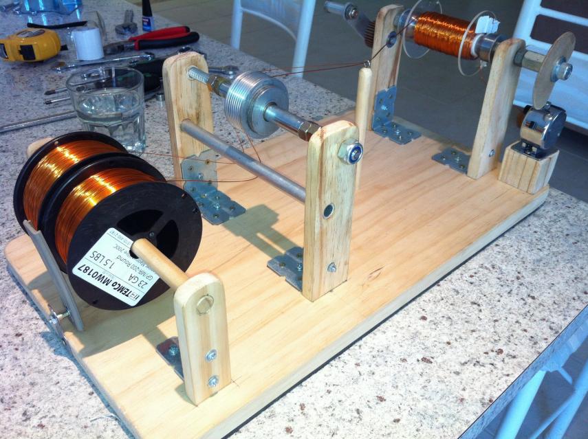

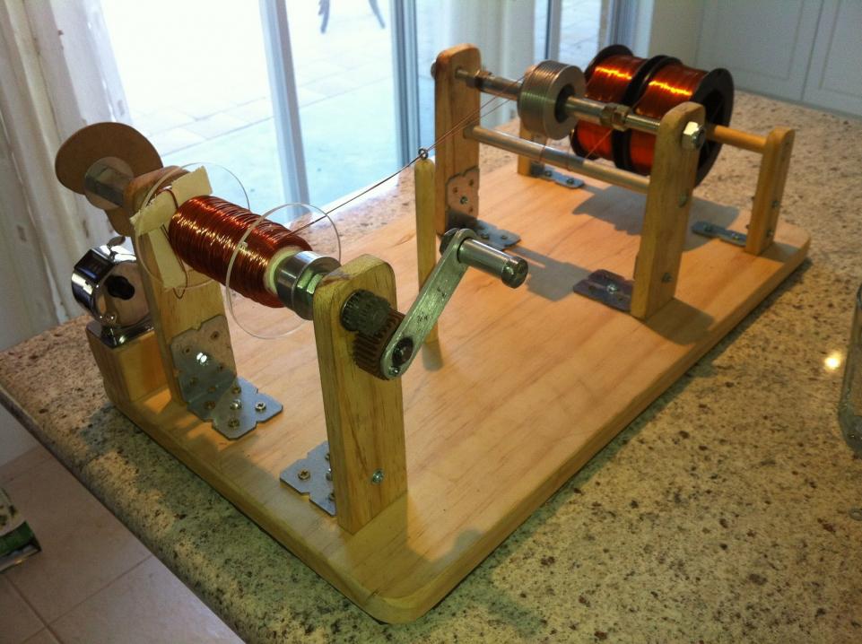

    I’ve recently completed my home built coil winding machine – see below. And while I’m happy with my first coil winding attempts I would like to produce much more professional and high quality coils as well as experiment with different designs.
    I was wondering if anybody knew of a service that would professionally wind coils, (Bifilar, Trifilar etc,) to whatever spec you wanted?
    [ATTACH=CONFIG]1924[/ATTACH][ATTACH=CONFIG]1925[/ATTACH][ATTACH=CONFIG]1926[/ATTACH][ATTACH=CONFIG]1927[/ATTACH]

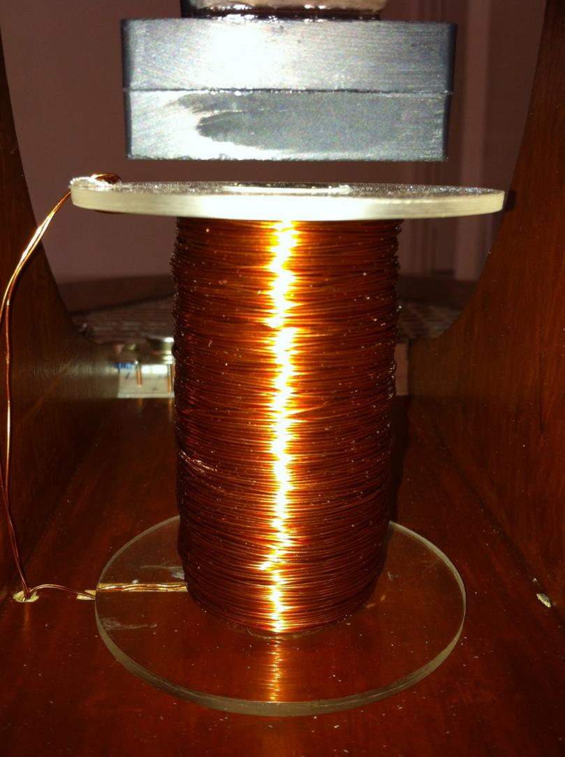

        Let me know where and I will send you a few pics if u like of a coil I made a few days ago.....8 filar ,130 feet, #20 and #23 guage as specified in the Beginners Handbook.
        Cheers

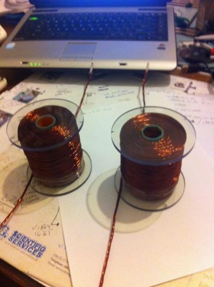

            Hi Wayne

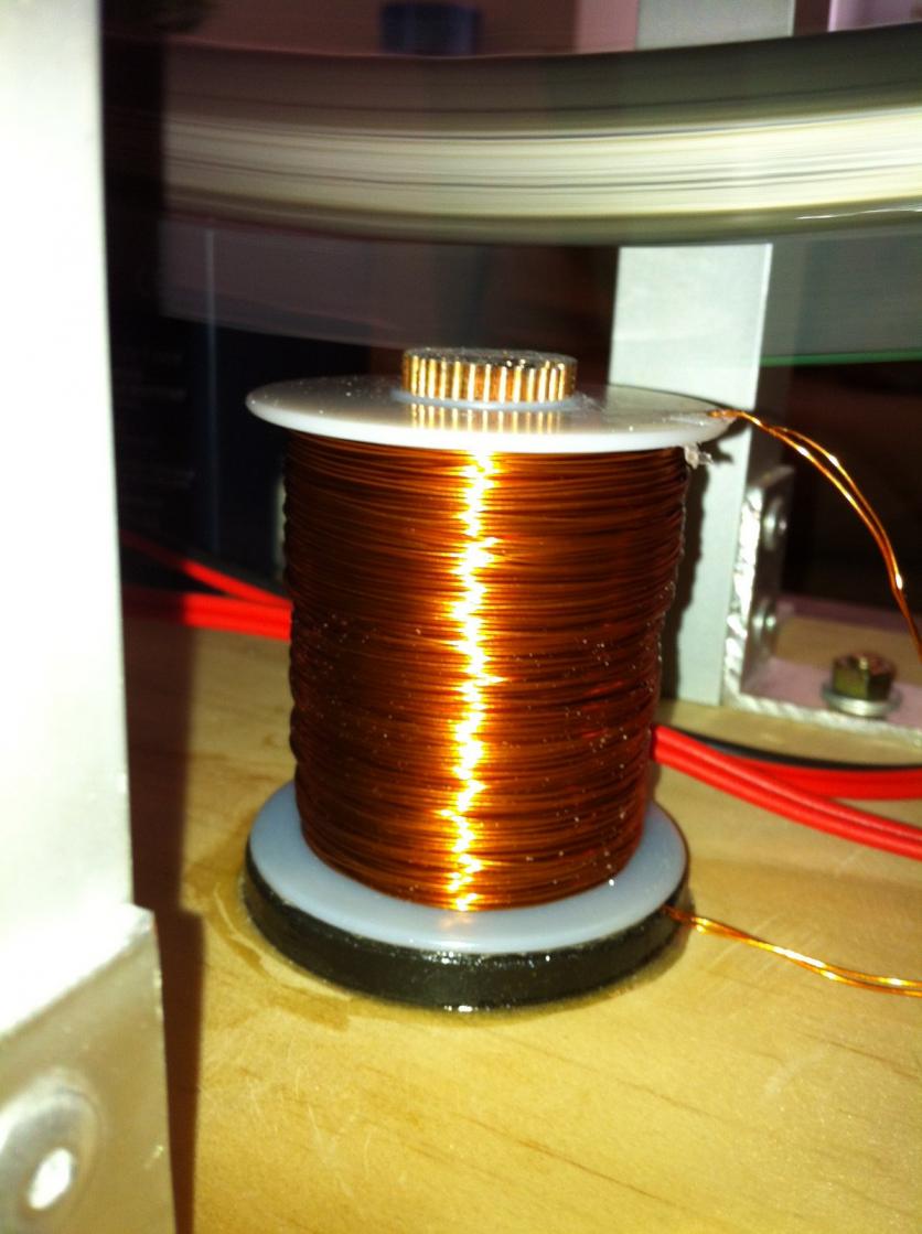

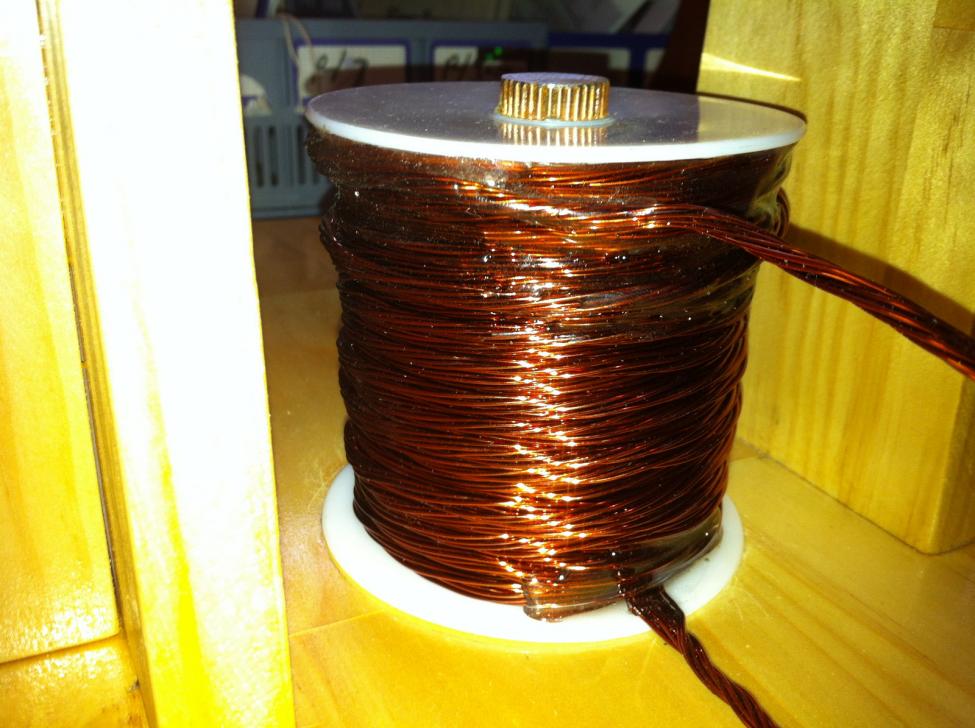

            Here is a pic of the last 2 SSG coils I made. I wanted to perfect my coils before I made a multicoil machine. The pic is of a couple of coils made to spec from the Beginners Guide Handbook. 8 filar 130 feet, #20 and #23 guage.
            My winding machine took 2 years to build...(work kept getting in the way....)
            I can now wind coils up to 12 filar with perfectly consistent litzing from beginning to end.
            With these on my adjustable airgap machine, I found it attained higher rpm with same current draw and charged faster. Also the sweet spots seemed to be more defined.
            If you need coils I am am happy to help.....
            Cheers

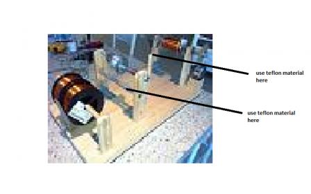

              Hi Archangel,
              Here i have shown in the picture, the change in meterial that is probably a must. winding at speed will peel or reduce the thinkness of the the enamel coating of the Magnet wires, which can be further degraded by The Radiant spikes that can easily leak out with eventual breakdown, you may break your head looking out for the flaws...!
              I have experianced coils 'damaged by Radiant-spikes behave hay-wire in SSG experiments.
              hence i suggest TEFLON materials for the rod below and the guide hole ring.Click image for larger version
Name:	Winding machine..jpg
ID:	45805 in the winding jig.

                The coils look to be built to a high quality and combined with your specifications, they should perform well - well done!
                Cheers
                  I would never have thought to use teflon to reduce potential damage to the magnet wire - thanks for that insightful tip!
                  Hi Archangel,
                  hence i suggest TEFLON materials for the rod below and the guide hole ring.[ATTACH=CONFIG]2599[/ATTACH] in the winding jig.
                    Hi Archangel,
                    Although Teflon is costly it is worth while to have them in the places i showed, you can try delrin as second option if it is easily avaiable...
