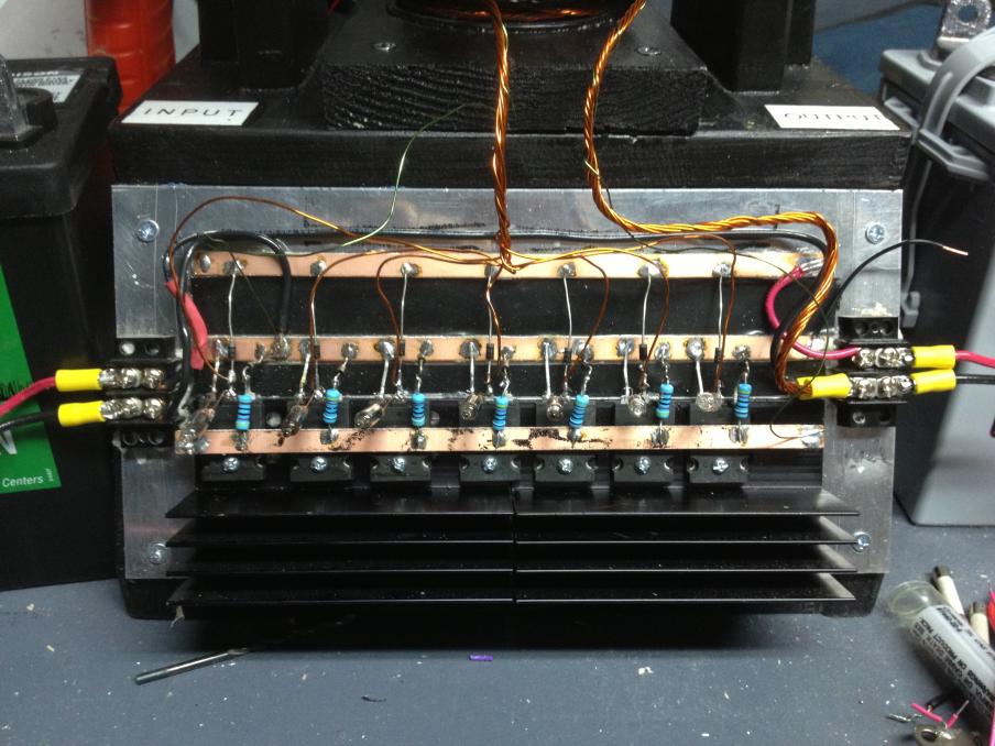

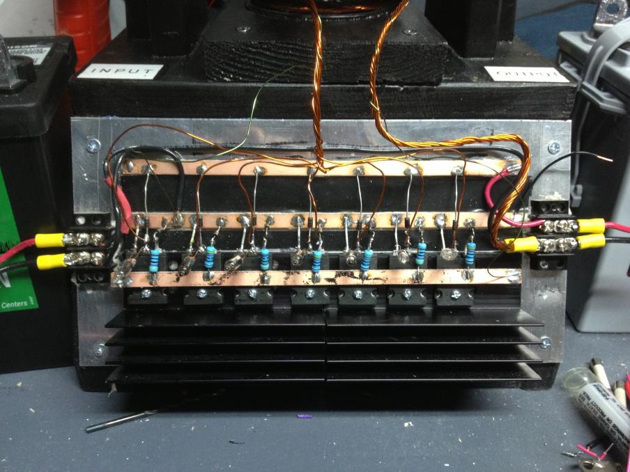

      I verified that all the base resistors are 470 ohms (1%). As for a 12 ohm final resistor, I don't recall that item at all. I looked at the schematics for the SSG and also the 7 wire SG and didnt see a final resistor. Could you please give more details. I included a pic of my final circuit layout.
      There is a variable resistor modification on the trigger , it also changes the value of the base resistors, but this is , called out in the SG intermediate book.
      Just a thought... I believe the original JB SG used an etched PC board as the circuit layout. I didn't use that, I cut PC board strips and glued them to a piece of aluminum sheet metal. Could this deviation be a problem? I figured it would be ok since it was non-magnetic.

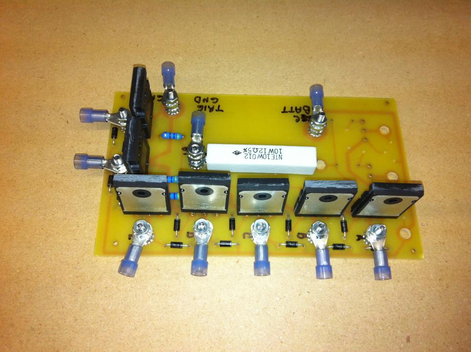

        On the kit, the trigger is going through a 10 watt 12 ohm power resistor then the trigger goes to all 7 base resistors.

          do you have insulators on all your transistors? the 12 0hm 5 watt resistor goes in series on the trigger wire before the individual base resistors.

            I did a test with a mock up circuit with just one transistor , one coil wire and the trigger , but using my main wheel and coil. The current draw was only 150-200 mA. When multiplied by 7 that comes out to 1.40 A. My device pulls 2.65 amps So I have something pulling a lot of additional current when 7 transistors are in use. It may be the fact that I didn't use the insulators, which is causing the increase in current. I have some on order...

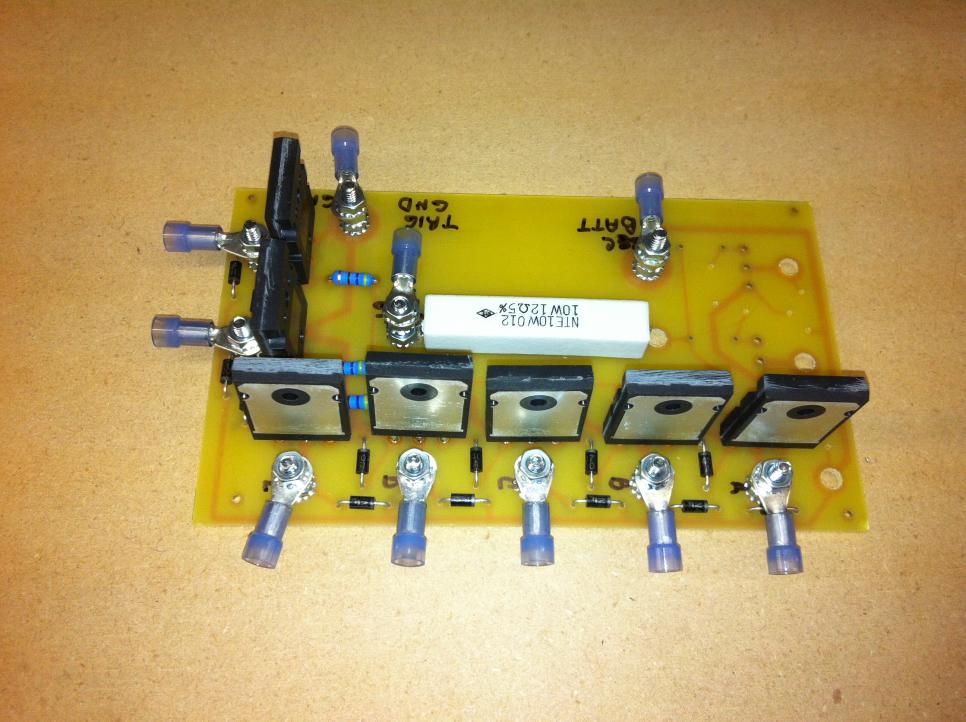

                The circuit in the kit doesn't have insulators on the transistors. The transistor are not connected to anything other than the 3 connections.
                This is exactly what the transistors look like - when mounted on the SG's base, nothing is added to this.
