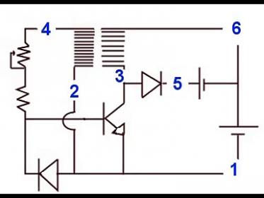

                By the way, i am using as reference this:
                  SUCCESS !!
                  Sorry to flood this thread... but i have a bunch of people here to convince about free energy and this Bedini is the working proof.
                  I changed the coil and the system start to spin. Both coils has the same 850 turns but the one that worked is with wires 22 and 26. The one with 20 and 24 was no able to sustain the wheel spinning.
