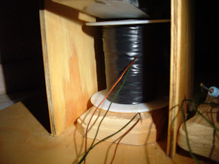

Hello,

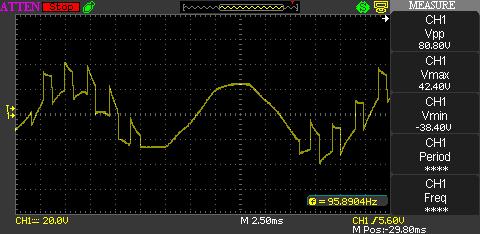

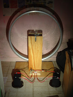

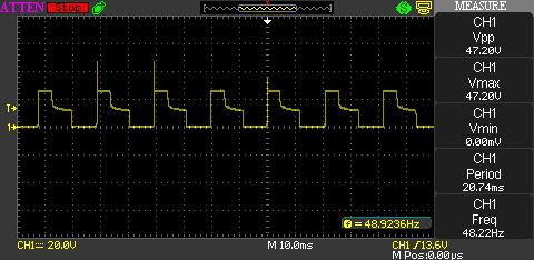

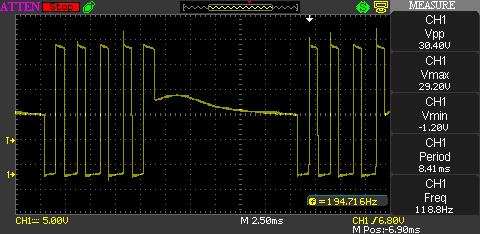

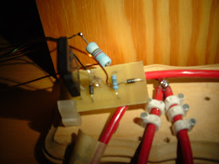

I wanted to post some photos of my SSG and my first 20 charge run data. I'm very pleased with the performance
. I averaged a system COP of about 70% and a battery COP of 180%

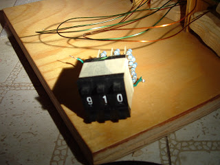

. The coil is 2 strands of 18 AWG the tuned resistance value is set at 912 Ohms. I used a great suggestion from the board--a small decade resistance "box" that really helped with that part of the tuning. Might want to see if I can increase system COP to 80-90% if possible, maybe through bearing adjustment or some other means, suggestions are welcome--but I consider it a complete success as it is! I finally got another battery so I am continuing to do charge runs to 14.5V to see if it conditions the battery further. Thanks to John Bedini, John Koorn and everyone who helped on the board!
