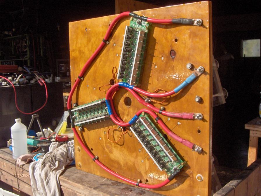

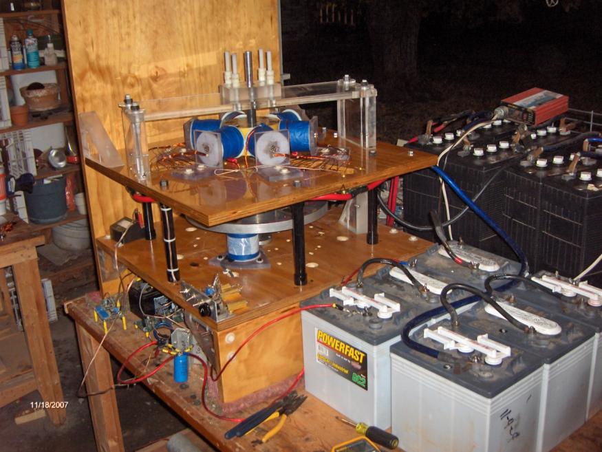

    The SSG machane Dan B. built, has a vertical shaft that run's on a single ball bearing on the bottom end, and has a normal bearing at the top end. It also has a 16inch disk with 6 magnets for 6 or 7 genny coil configurations, Chad and I wound the coils and built all the electronics and wiring, battery charge / discharge swapping system etc.....
    The genny coil Cap Dump is 3, 1.5F 24V audio super caps in series, and using 2 set's of 3 parallel MJL21193's in the full patent pulser configuration, to pulse 24V of golf cart battery's, at about once a sec +/- some, using a 556 PWM circuit. It also has a SSG Drive Battery Cap Dump Back Popper circuit that is relay based and runs at about once every 1 to 4 sec depending on the genny coils input that i had been testing at the time it blew up
    It also has a Window Motor addition that fits on the very top, to provide torque for the genny coils, because the Fogal mod'ed circuits had almost no torque compared to the standard SSG circuits. The window motor was for making up the difference, so that the SSG part, is just along for the ride..... the window motor's 2 FWBR outputs (Drive Strand and Pick Up Strand), also contributes to filling up the Cap Dump charger and the Back Popper circuit

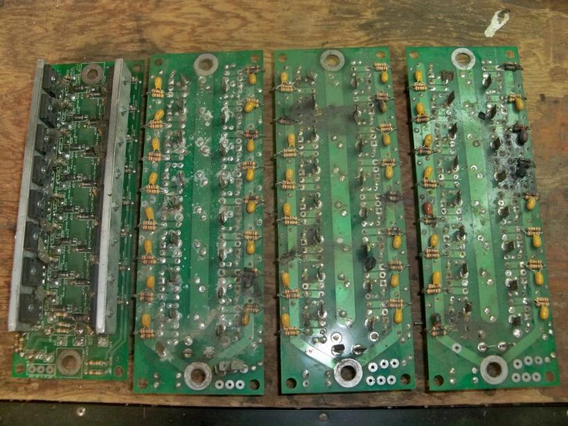

    The SSG/SG Fogal mods are very advanced, and i will not go into that circuit here........... I tested 3 sets of 3 PCB's, a standard SSG, then one with a SCR Output mod (that i nick named The Tranny Killer), and the last one was the Fogal mod'ed set
    the pic below shows the 3 Fogal mod'ed PCB's bottom side with the burned up parts, and the one on the left is the top side of a standard SSG PCB that has several blown trannys too (I blew them up, when your pushing the envelope, things happen)........
    next pic is the Dan B SSG machine when we first got it running. it does not show all the equipment currently there, as all that was built later......
    it was nice and shiny then, now it's quite dusty and will need a good cleaning and electrical reconnecting to get it all back to running in it's new location in my new shop......
    the 3rd pic shows the PCB's mounted to the bottom side of the coil platform
