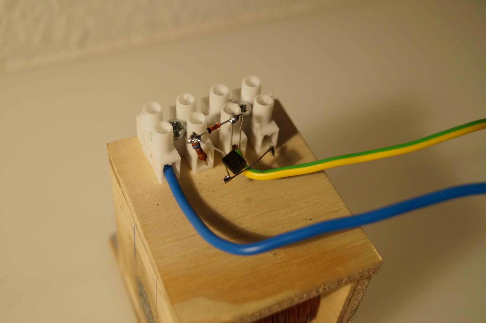

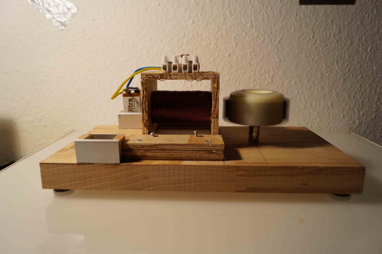

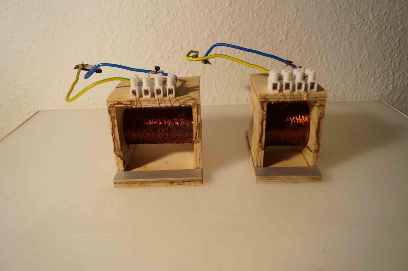

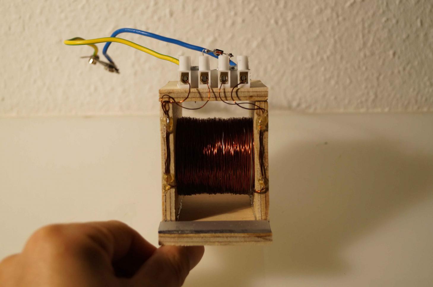

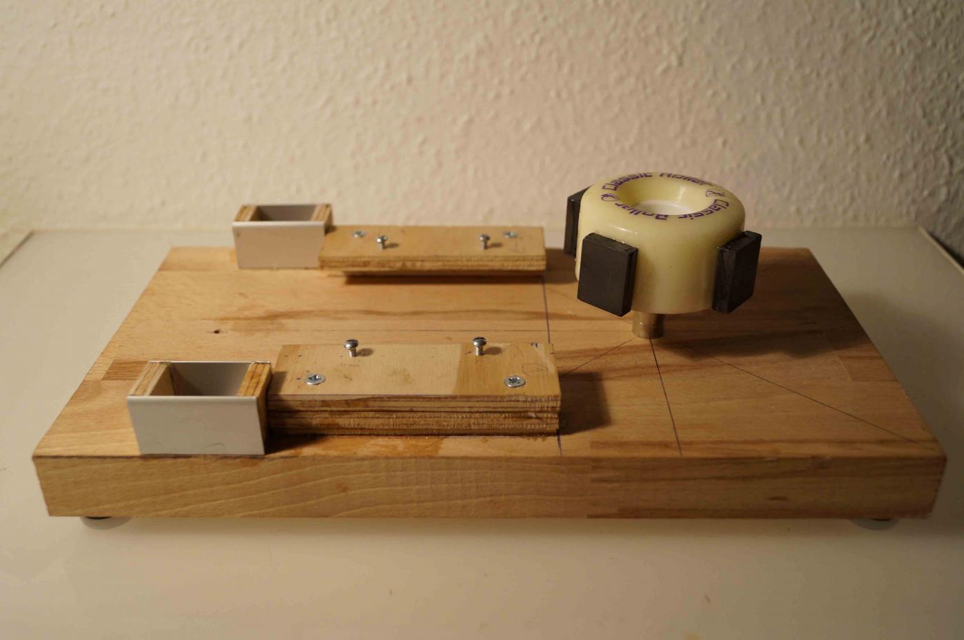

                    Hello Aaron
                    Thank you for your reply.
                    I am building the small SG with the 9 volt battery just to see if I can make it run for 4 - 5 days on one battery as Shawnee did. This is pretty awesome itself. There are a lot of leaning for me in this small set up. Hopefully I can use this knowledge in the bigger models I will build latter on.
                    I have made some bigger models before, but it did not work, so I guess I need to learn more basic from this SGmodel.
                    It's all the small adjustment that makes the difference.
                    You say 23 awg is fairly to small. What is your recommendation ?
                    The small coil has 600 turns. Big coil has 520 turns.
                    The small coil the wire is wound clockwise the big one the wire is wound counter clockwise.
                    The transistor gets hot on the small coil - when I start the spin ?
                    The transistor on the big one gets cold the same does the core and the wire. I am not sure if the air circulation from the rotor can create the coldness or is it something else ?
                    The rotor is a rollerwheel with 4 magnet. North pole is facing out.
                    I made the coil adjustable so I can move it exactly to the rotor and the gap will be correct - as you mention.
                    When I start spinning the rotor is that clockwise or counter clockwise ?
                    When I start spinning the rotor - It can be a little sluggish in RPM after a while it starts to gain more speed. Actually I notice 2 or 3 step increase of speed until et reach a "maximum" momentum - maybe a kind of resonance. The scope show 200
                    Volt in peaks (spikes) the big coil. Small coil 175 Volt.
                    Do you have any idea how much the Volt spikes should be in this small SG model ?

                    • #70

                          If you want to make a small one, just use the same wire size specified in John's drawings that are included in the book for Shawnee's version.
                          Actually, both wires are wound in the same direction. You can wind them at the same time from 2 different spools.
                          If you wound them in different directions, you can run into problems. They should be wound in the same direction.
                          Is the transistor still hot when it is up to full speed?
                          I'd rewind the coil so both wires are in the same direction. If you wound the trigger in the opposite direction after the power winding, just unwind the trigger and rewind it in the same direction as the power winding.
                          It doesn't matter which way the wheel spins.
                          The spikes can easily be over 100v on a small coil like that.
                          I would still use ceramics and just study that for a while.
                          You can run it in attraction mode no matter which direction the coil is wound as long as the magnets are placed in the appropriate polarity out. Attraction mode all by itself will give you more mechanical and electrical output compared to repulsion mode per unit of input work.
                          Before answering anything else, please make sure both windings are in the same direction then come back and post.
