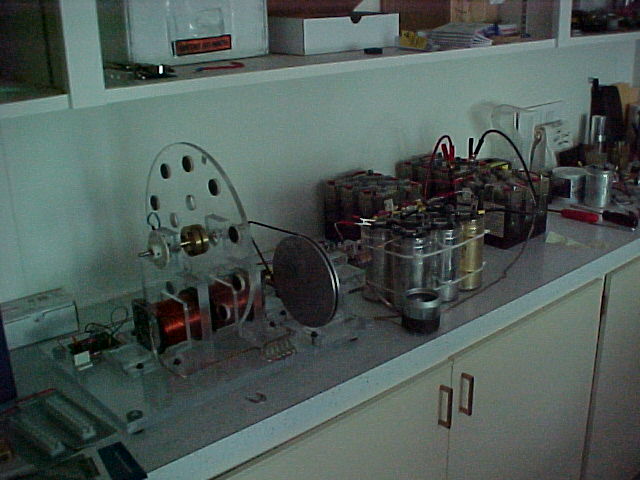

                    If you had it running in the better mode, I don't doubt the "OU". It can still be had with the normal mode and many of us have achieved it. Probably not with the 3PM kit from Rick - not in normal mode. It is just easier with this other mode spelled out in the book.
                    But the new energizer kit with the circuit actually designed by John, it is intended to run in the new mode. Everyone really owes John some serious gratitude for this because it will take the entire Bedini SG and Bedini SSG world to a new level for everyone. There are going to be a lot of "skeptics" - really cynics - that will be putting their foot in their mouth now. It will still be a while before it really hits everyone what has been handed to them in this book. I just can't wait to see everyone post their results with some real numbers. Notice the temperature difference in normal mode and this other mode.
                    This is the first all out build I ran in that mode:
                    We did many experiments with our cd spinner before deciding to do this with 24 transistors on the kit. on this one we used your referenced #3 in the book.
                    kind regards,
                    Patrick
