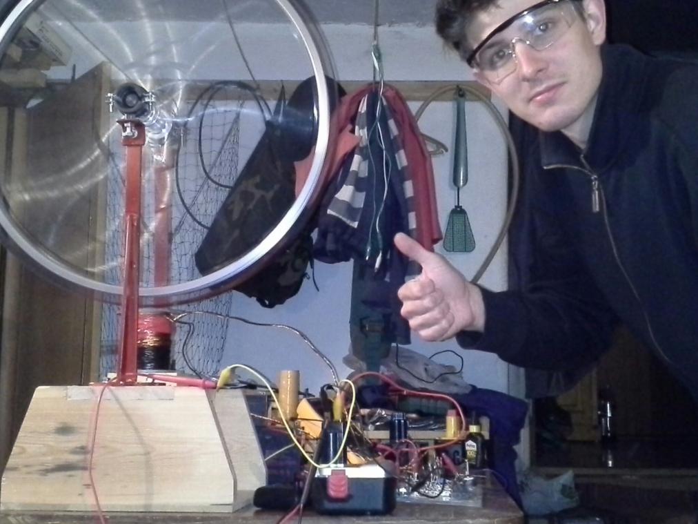

    Almost done !!!! It's working nicely. I will upload photos of "making of" on my G+ account once it's done.

        Awesome! Looking forward to seeing the complete model.

          if your yoke is steel you need to change it out for wood or plastic, you don't want spinning magnets passing by metal you are creating little magnetic impulses (locks) in the steel and it reduces your efficiency....Tom C
                When I started to build the whole frame with my grandfather , he was the big boss saying "why from wood?". We argued a lot. But then he pushed so much that I let him to do it from steel. I knew that steel would affect the magnetic field ,but ... I am preparing to build a second ssg with bigger steel wheel rim and wooden yoke and adding/experimenting/learning the cap dump to the first one.
                I will post results later.

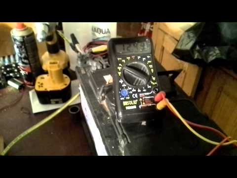

                  • Here is my SSG with homemade relay activated with 555 timer for discharging 8000 microfarad bank cap ,in 12 volt bateries ... the timer is set to discharge the cap once at aproximately 20 seconds at 80 volts, in old car battery...
                    Generator bedini SSG - YouTube
                    I observed also the electret effect of the capacitors but is very poor... the voltage are going up after discharging the cap bank ( and ssg stooped) to at maximum 1v ...I am using common electrolytic caps ....flash caps cannot be found easy in this areea of world and also are expensive...so I using normal electrolytic caps
