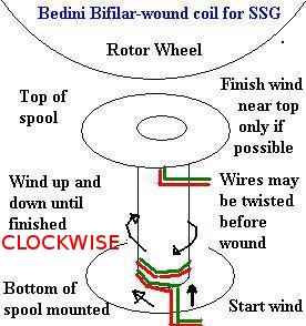

                      Wow, so after spending a week winding this perfect new coil I read this and discover the day I finish that I wound it the wrong way. I went by the diagram, but I had to restart it a couple of times and I guess I switched it. A suggestion--could someone replace the coil winding diagram in the sticky thread with this one or one like it, it might make me feel a teeeeeny bit better right now.
                      *edit* Glad to have the winding xp but for future reference, counter clockwise coil wind with N pole of magnets on wheel facing out should be better than clockwise (unless S poles are facing out). Explanation is in Bedini SG Manual book! And if you want to switch the polarity of coil you can apparently switch the top with the bottom of power and the top with the bottom of the trigger winding where they connect to the circuit (or switch the poles facing out of the magnets on the wheel) rather than rewinding your coil.

                          Ha, yeah, I'm glad I caught it, thanks Forrest! It is good experience, I'm glad that this forum exists so that it's easier to learn from others' experience--as I might've spent months doing lackluster charging runs and wondering what the problem is. So far my machine problems are small compared to what you guys have successfully ironed out .
