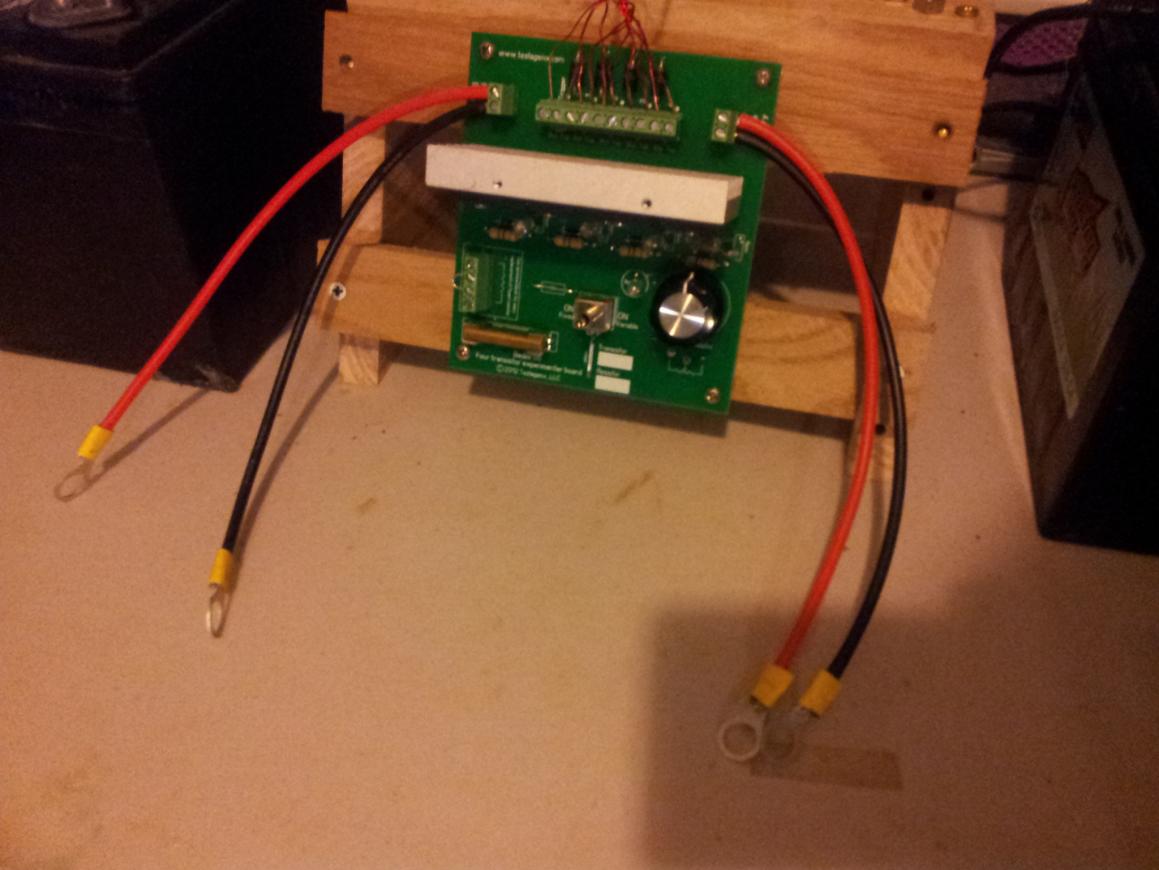

            • #66
              Update: I've changed the primary and charge battery wires to 12GA wire, and soldered ring terminals so I can screw them onto the battery posts instead of using alligator clips.
Name:	2013-05-06 00.16.24.jpg

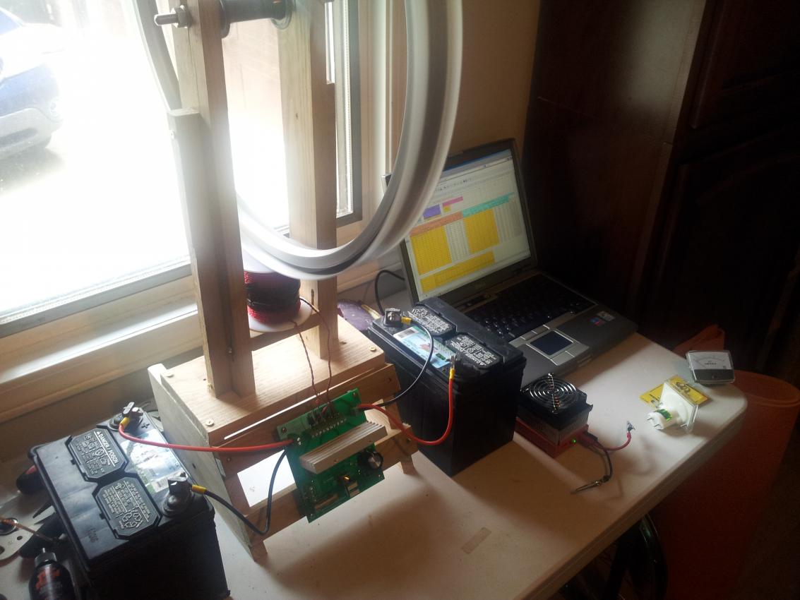

              • #67
                I've started my 1st test run! Some specs:
                Frame: Solid oak w/ Brass screws
                Wheel: 24" Aluminum. 9:30 free spin time using ceramic bearings.
                Circuit: 4 transistor Teslagenx board
                Coil: 4 power, 1 trigger. From Teslagenx
                Wire to batteries: 12GA with ring terminals
                Input draw: 330mA
                Output: 170mA
                RPM's: Waiting on reflective tape for tachometer
                Batteries: Interstate Lawn & Garden type batteries from True Value

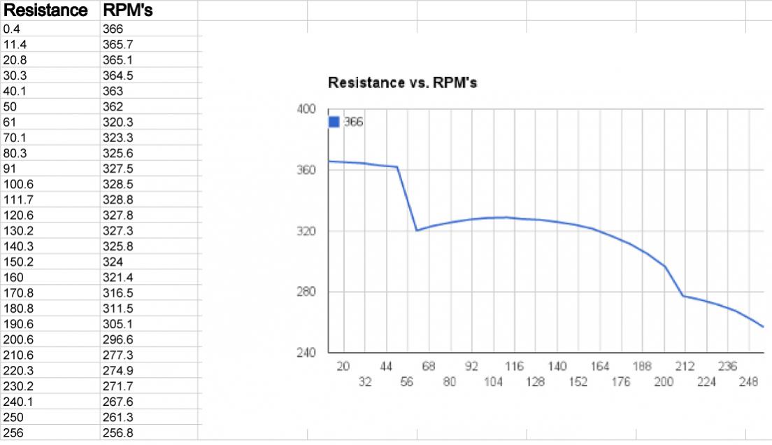

                            • #74
                              Ran through all the resistances in increments of 10 ohms and documented RPM's in order to find the sweet spot. Looks like I need a resistance close to 110 ohms.
                              Does this look correct to everyone?
Name:	Resistance vs RPMS.jpg
