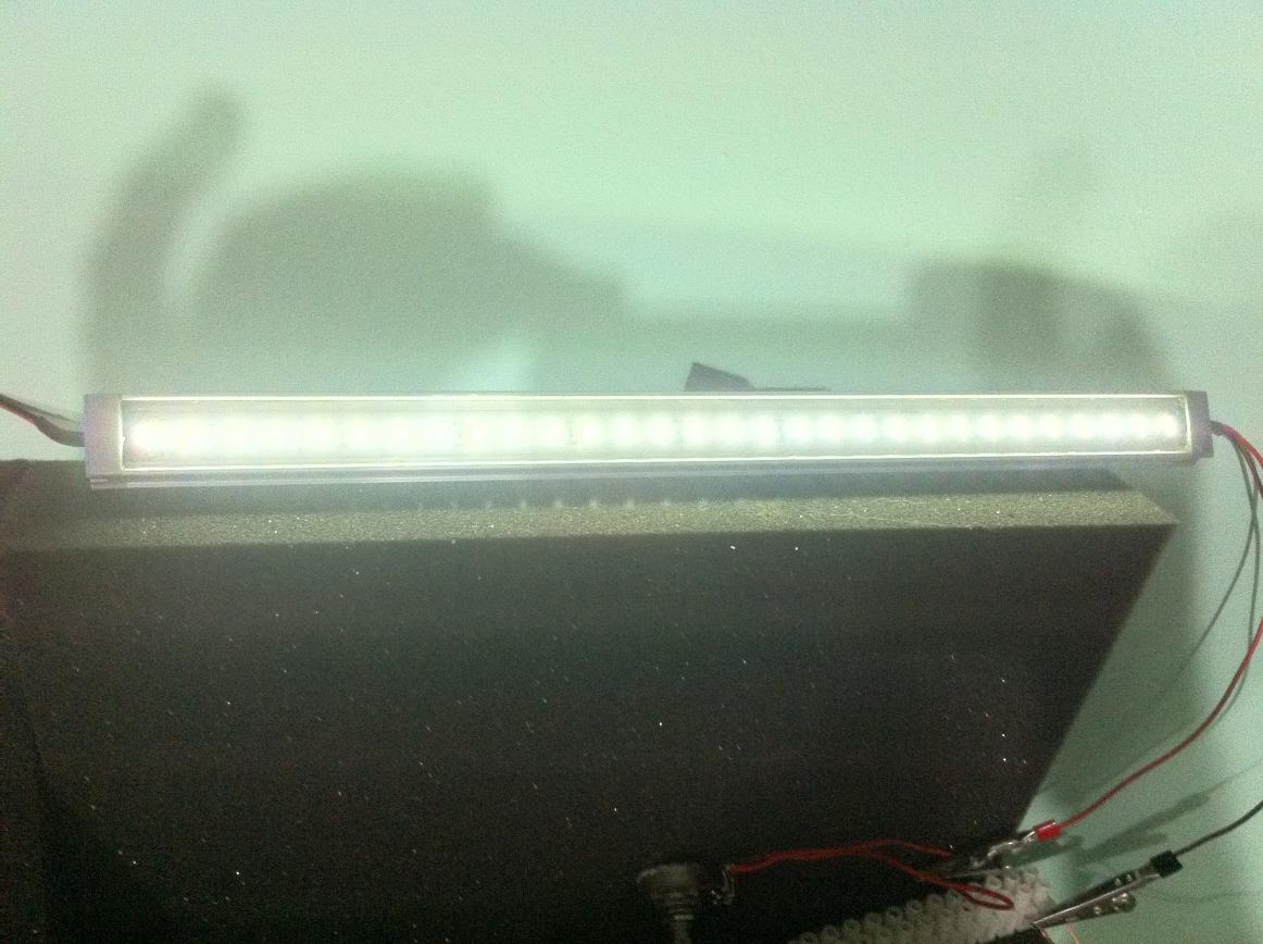

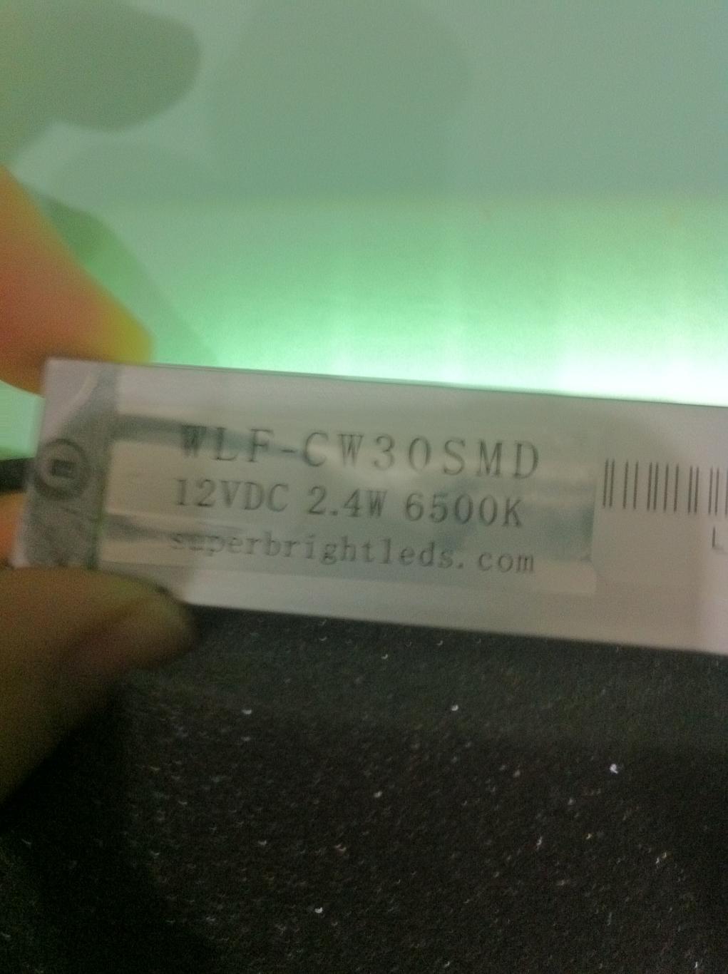

          • Hey Bob-
            The LED strip is 12v and pulls 500mA.

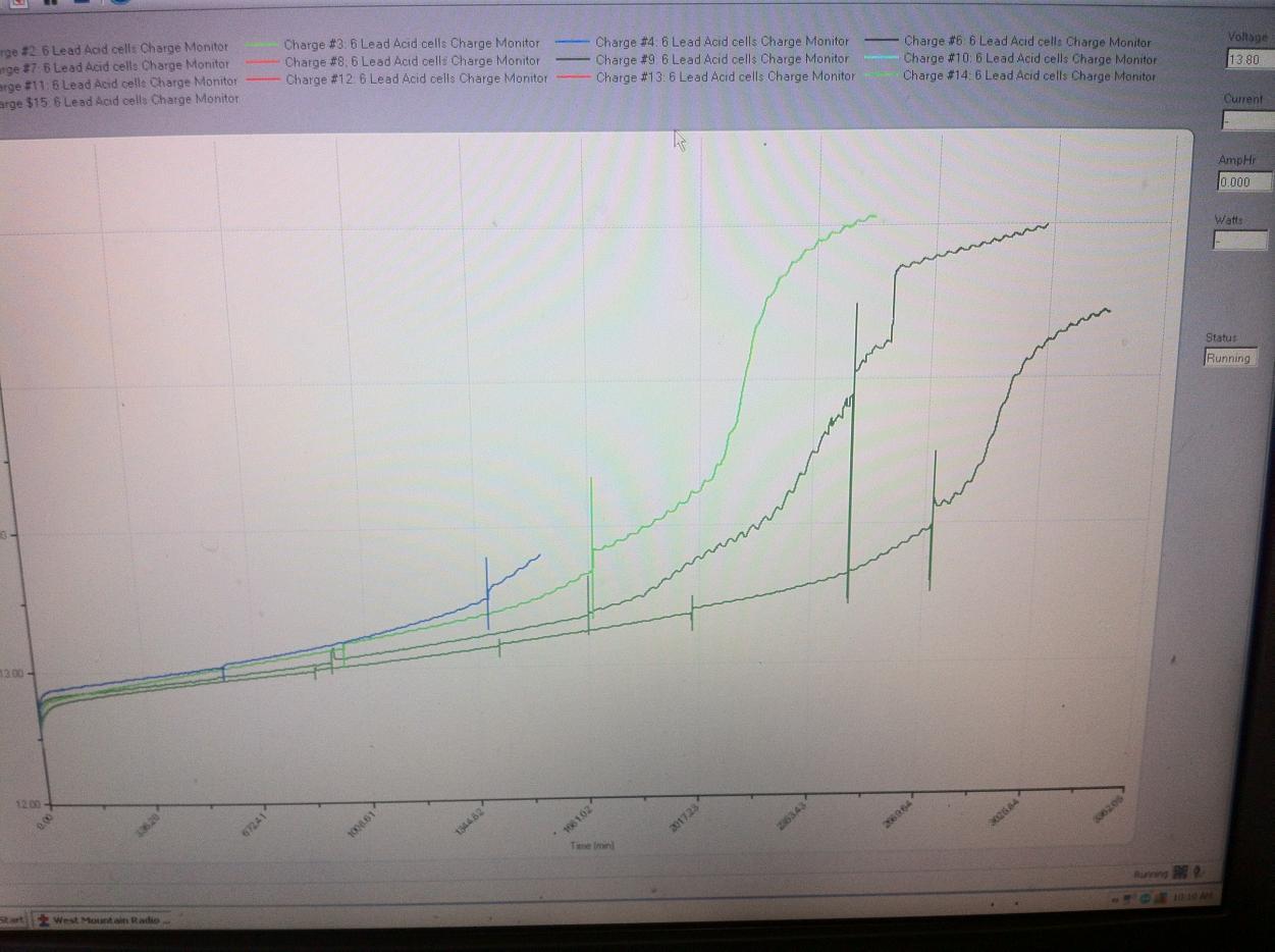

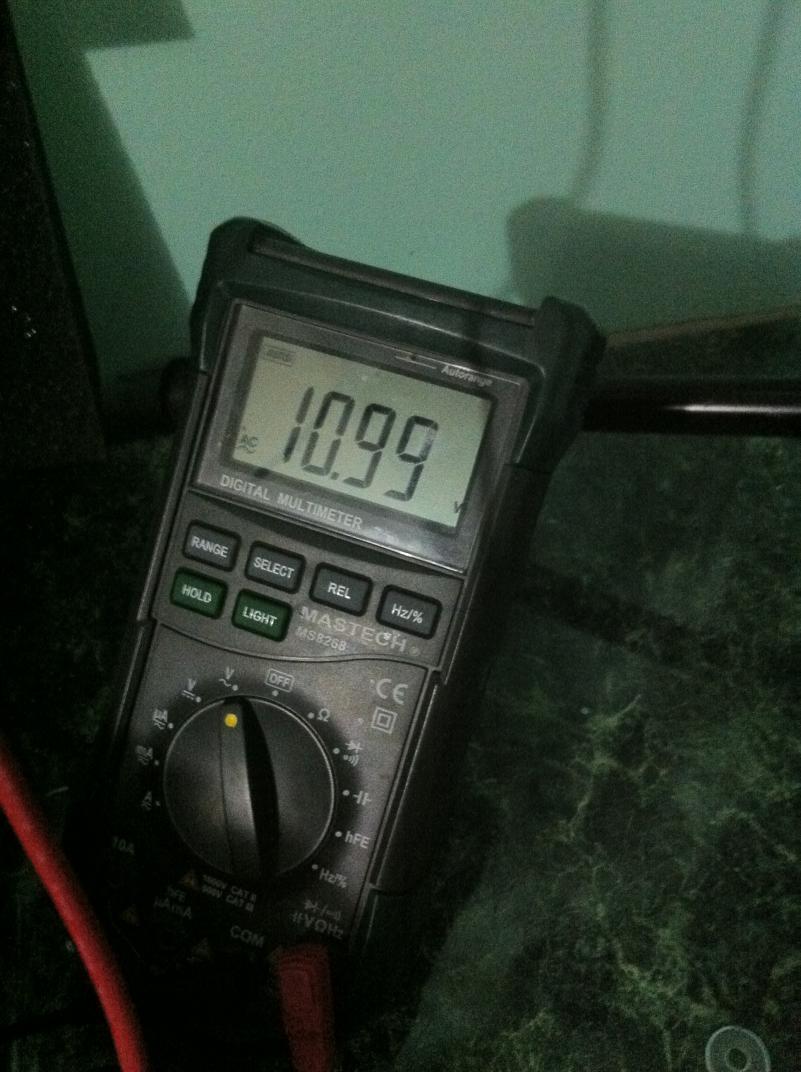

            • Here are some photos for ya. Coil is putting out between 10v to 11v.
              Also posting a photo of some curves. From right to left those are charges #2, 9, 14, and 15. Charge #15 is running right now. So every curve peels upward a little bit earlier than the last. You can see on charge #9 where the voltage shoots straight up towards the end? That's a curve where I had my genny coil too close...and that's the point where it slipped out of tune and started pulling a ton more. The charge output goes up too...it's just not efficient.
              It took me 5 primaries to charge 1 battery when I started. It's almost at 3 primaries now...so a slight improvement haha. Again the little spikes in the curves are where I change to a fresh primary battery.

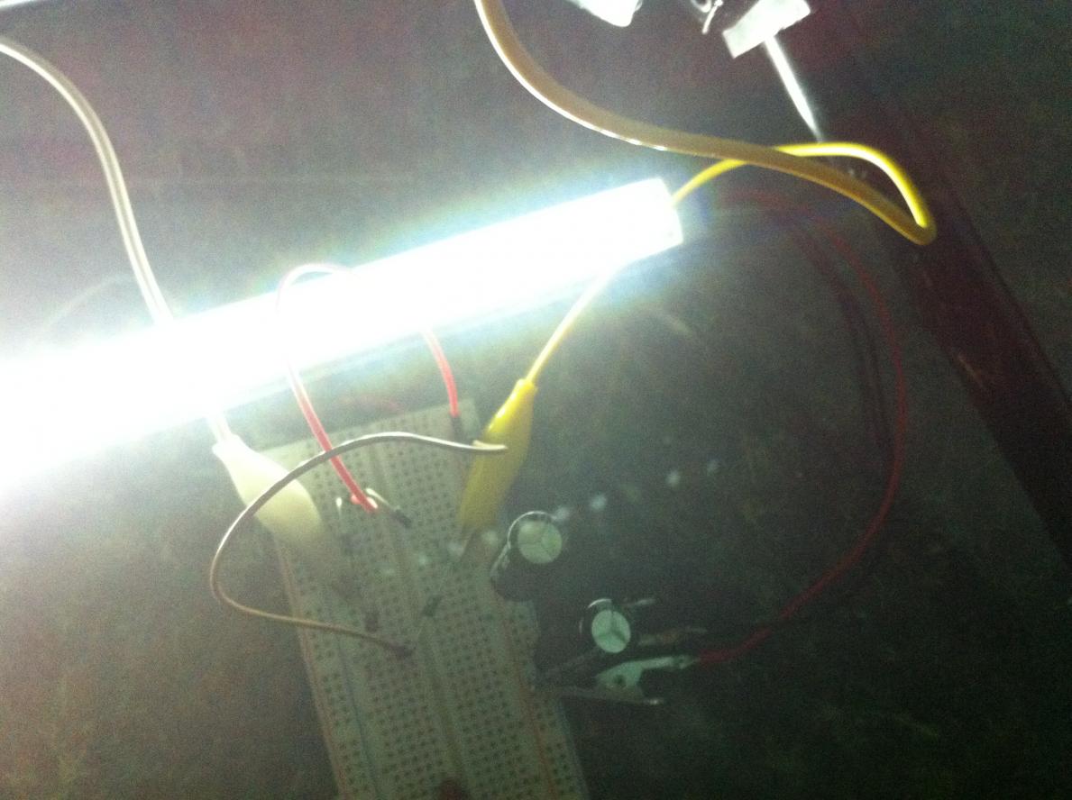

                          • Hey Bob-
                            I looked up bridge rectifiers (I am still a beginner with electronics) and learned how to make one with diodes instead of buying a ready made one on ebay. I am using IN4001's, and two 1000uF 25V caps. I am getting 9.08V DC to the LED strip.
                            Pretty fun! The lights are still pulsing a bit with each magnet pass though...I'm guessing that means I need a larger capacitor?
                            So if I want to charge up my alum battery...I would just take some leads straight from the capacitor to the battery terminals and that's it?

                            • Hey Branch,
                              It is a lot of fun indeed ;-)
                              I was going to mention that you could make your own bridge but I figured you had already ordered one. It's good you are learning and making strides on your own!
                              Really it is just residual signs of the frequency your machine is producing and you may have to play around until you get it how you want it. Did it improve with the bridge and cap at least?
                              I suspect if your coil were putting out more voltage it would help because your juice is mostly passing through and not building up. The idea is to build up the cap as a storage device, like a little battery if you want to think of it that way so that it can release a steady flow. That is where the regulator would come in BUT you need to be making more voltage than the led uses to create; a bottleneck at the cap. It sound like under the current conditions the led panel is thirsty for the voltage and it is drinking up everything it can get from the cap. The regulator is like a pressure valve that would feed the led just what it wants. So you may have like 16v on the cap and 12v coming out of the regulator.
                              Did you try the second coil in series? If you still have things setup so you could try that go ahead and hook that to your bridge and see what voltage comes off.
                              As it is,, no I don't think it will charge your alum very well. It would bring it up to a point but not fully charge it. If he source is 9v than the alum will not go past there. Remember that when charging you need a greater POTENTIAL than your target or they will just equalize. That is one of the amazing aspects of a mono pole besides thinking about the radiant and all of the theory,, someone who has never seen or heard of one but knows just a little about electricity would be amazed that you can take a lower potential on the front to charge to a higher potential on the back. In other words if you were to take two batteries one has 11.5v and the other 13v,, and hook them in parallel the most you could ever hope for is they would equalize and both would be like 12v in the end. The same would be true coming off your bridge/cap. Go ahead and hook it up to the alum and give it a few tries, it shouldn't hurt anything since it is a converted batt. Who knows you may get a nice charge on it but if it were a regular acid batt I would say it would be a bad idea. With the alum they are much more forgiving with running down the voltage.
                              One other thing you can try is to just put one diode going to the cap. It doesn't matter which lead you hook it too but put the band going towards the cap. This may give a higher voltage, may not but worth trying. I am thinking about the voltage drop through the diodes. If you just put one diode you will just be chopping off half of the AC wave.

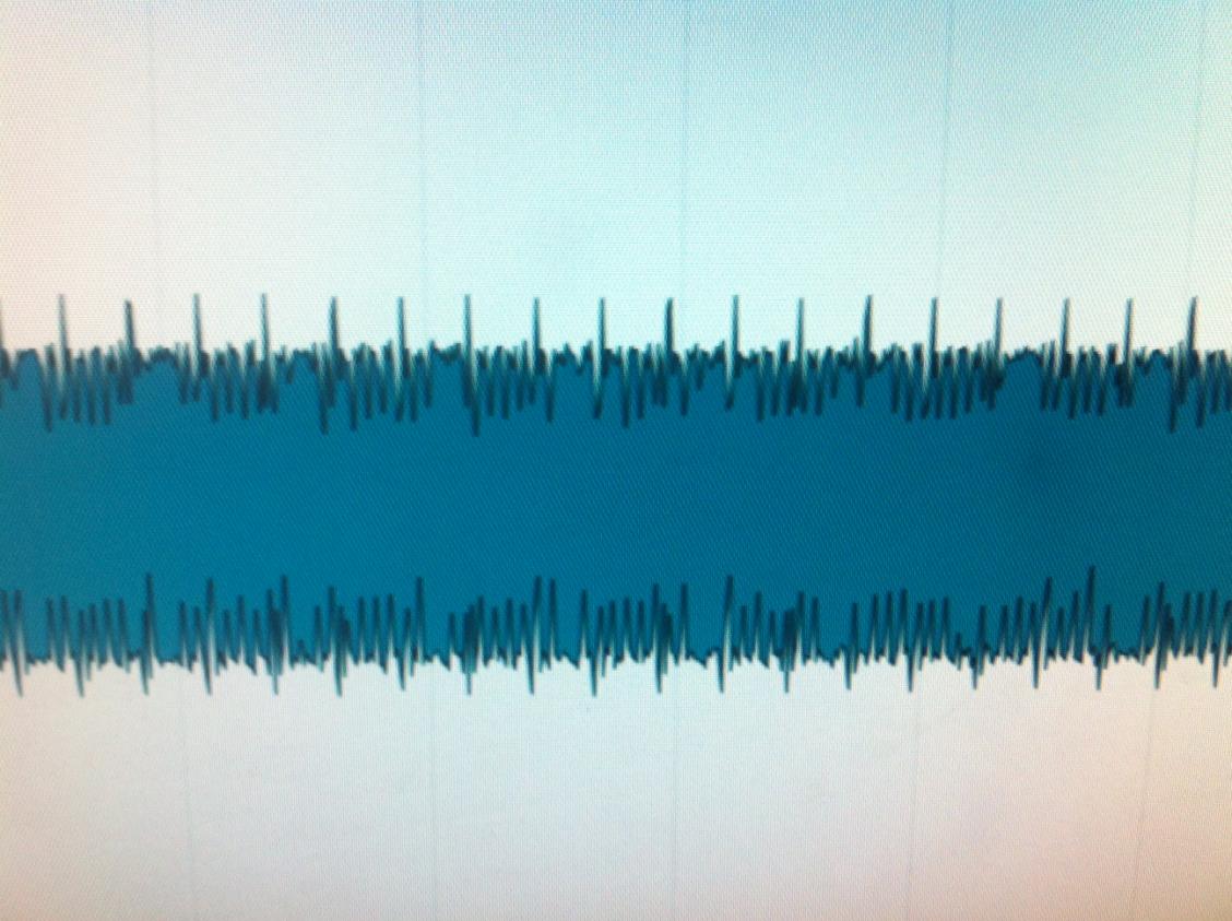

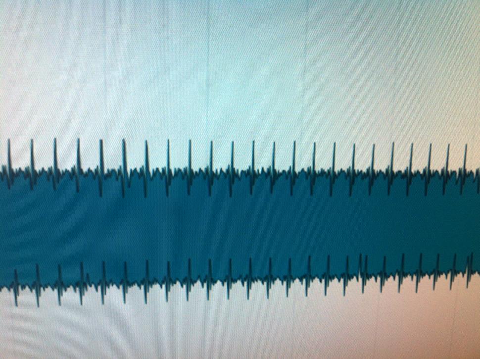

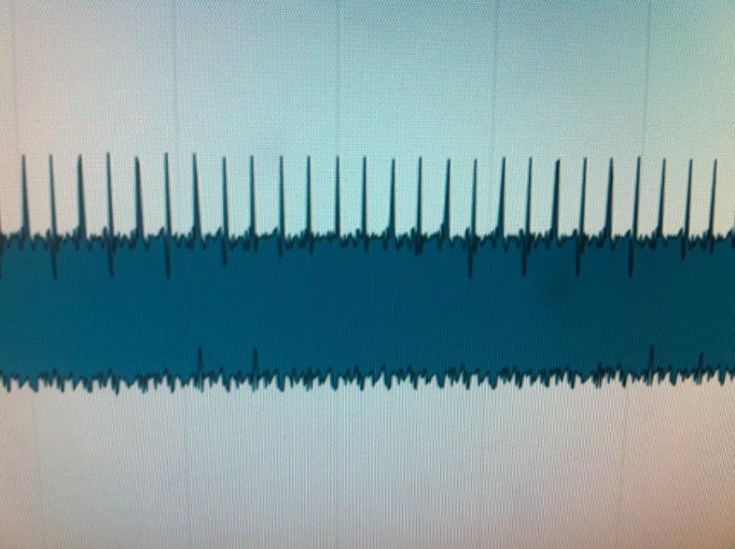

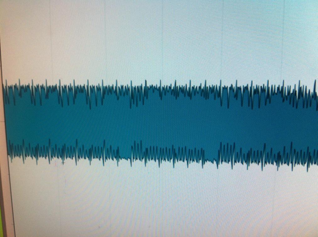

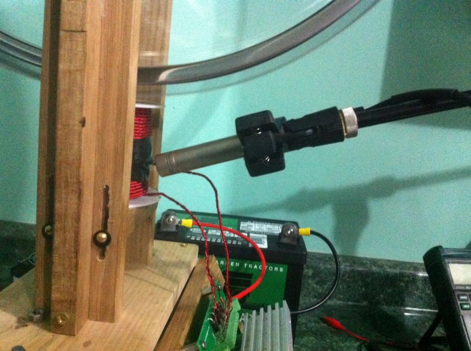

                              • Tonight I setup a microphone right next to my coil so I could hear any sounds it was putting out.
Name:	Mic Setup.jpg
                                I put on my headphones, and booted up my recording studio software. I then started to turn the POT and found 3 very distinct points where I heard very audible single clicks. I then recorded myself tuning into each point so everyone can hear. I also took photos of the audio wave file. You can see the spikes quite clearly.
                                Highest Resistance: Click image for larger version
Name:	Highest Resistance.jpg
ID:	45948 Click here for Audio File (this one you have to really listen for it, headphones best)
                                Middle Resistance: Click image for larger version
Name:	Middle Resistance.jpg
ID:	45950 Click here for Audio File
                                Lowest Resistance: Click image for larger version
Name:	Lowest Resistance.jpg
ID:	45949 Click here for Audio File
                                Out of Tune: Click image for larger version
Name:	Out Of Tune.jpg
                                Here's a video of the fader volume showing each pulse: http://www.youtube.com/watch?v=0xdz_qE5QvA
                                The lowest resistance is not very stable...it may require some very fine tuning...it tends to slip out of tune and I have to raise the resistance slightly. Interestingly, the middle resistance requires me to lower the resistance to get it in tune...and then it sticks.
                                You know what else is interesting is that I'm hearing a chorus effect coming from the SG now. I'm speaking from an audio standpoint...when you hear two audio signals phasing in and out of each other...and it sounds like a watery chorus effect. It's a little discerning haha.
                                Very cool project tonight that I just had to share with everyone! You can definitely see a benefit here to very fine tuning, beyond just seeing one pulse on your scope. We'll see if it translates to better charging for me...
