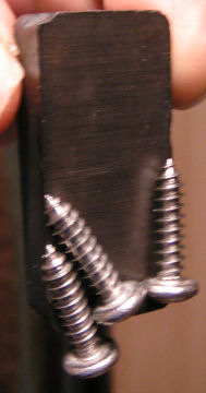

Something to note about stainless steel is that there are different grades and some have more steel in them. A magnet will stick or drag on some of the cheaper grades, so don't just assume that if it's stainless that it won't drag. Check it before you use it.
