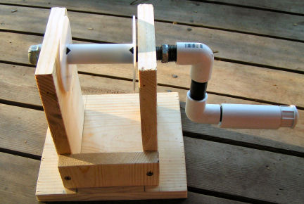

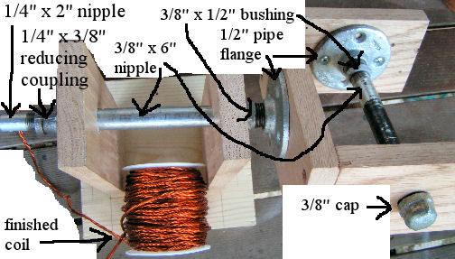

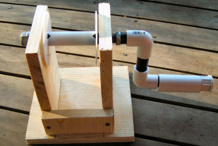

When I needed to wind a coil I never wanted to stop what I was doing and run down to the hardware store and get parts to make a winder, but finally I was at the store and bought some parts on the fly.

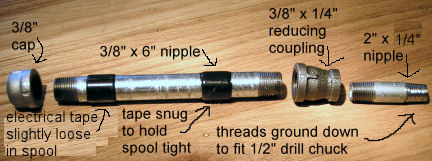

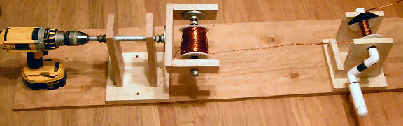

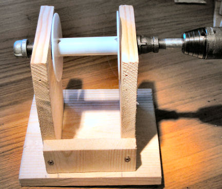

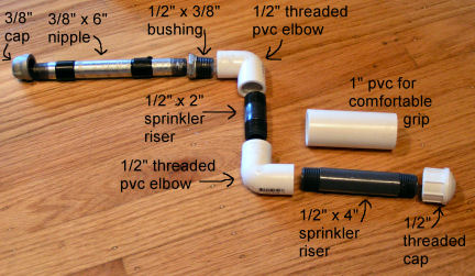

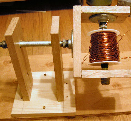

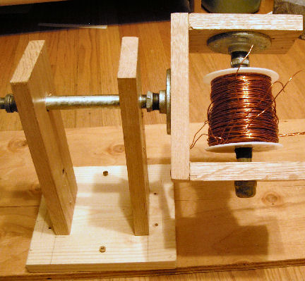

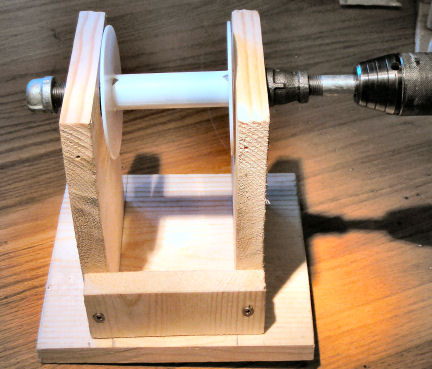

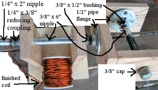

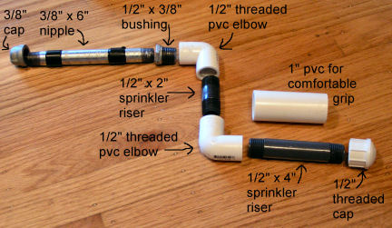

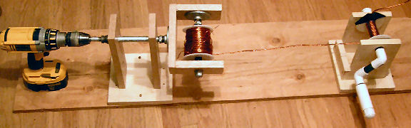

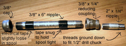

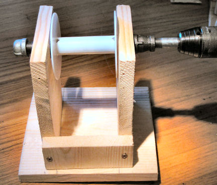

I wanted something that would be quick and easy to throw together so I used common pipe fittings. I made it so it's easy to switch a couple of fitting so it can be used as a hand winder or with a drill.
I put it together in around an hour and man, I'm really glad I did. It's so much easier than wrapping by hand. I'll post some pics below.
This winder is for the 3 1/4" spools with the 3/4" hole. Obviously you want to wind your spool before packing the welding rods in. Not that I know anybody that did otherwise.
