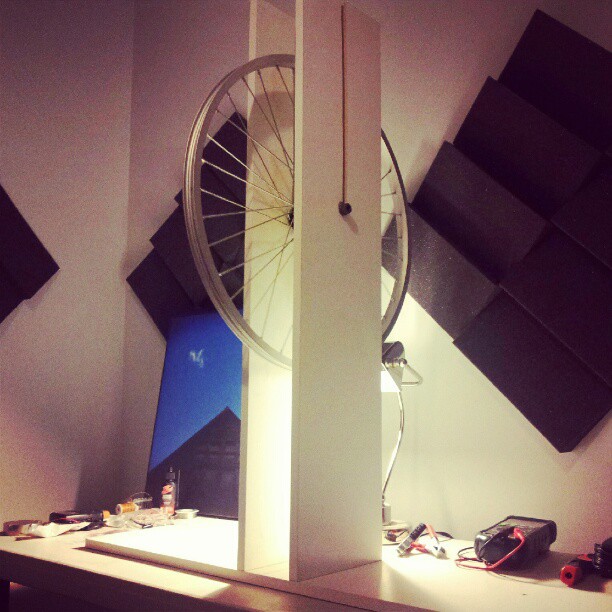

    I got my frame built out of some old shelves, and screwed on the bike wheel. It's pretty sturdy...we shall see how it holds at high RPM's. Planning on taking it to the bike shop to have it balanced so there isn't wobbling going on.
    Next is attaching the ceramic magnets. it's a 24" wheel...according to the experimenters doc I need 16 magnets. According to my calculations....and someone correct me if I'm wrong here...it's been awhile math wise.
    24" diameter = 75.36" circumfrence
    My magnets width = .875"
    So if I add up all the width's of the magnets (16 x .875), I get 14". So, 75.36 minus 14 gives me 61.36. If I take that and divide it by 16 spaces, I get 3.835".
    That seems to be an awfully large space between magnets. Shouldn't the space be somewhere between 1 and 2 magnets spaces?
    Here's a photo of the build so far...

    Hi Branch,
    The 3.835" spacing you calculated would be the space between centers, or between the same edge on each magnet. You need to deduct the width of the magnet from that to get the open space between facing edges. So 3.835" - .875" would give you 2.96" between magnets! And dividing 2.96" by .875" would give you 3.38 magnet widths between magnets.
    I think the recommended space is 3 to 5 magnet widths apart. Looks you're good to go at 3.38 widths!
