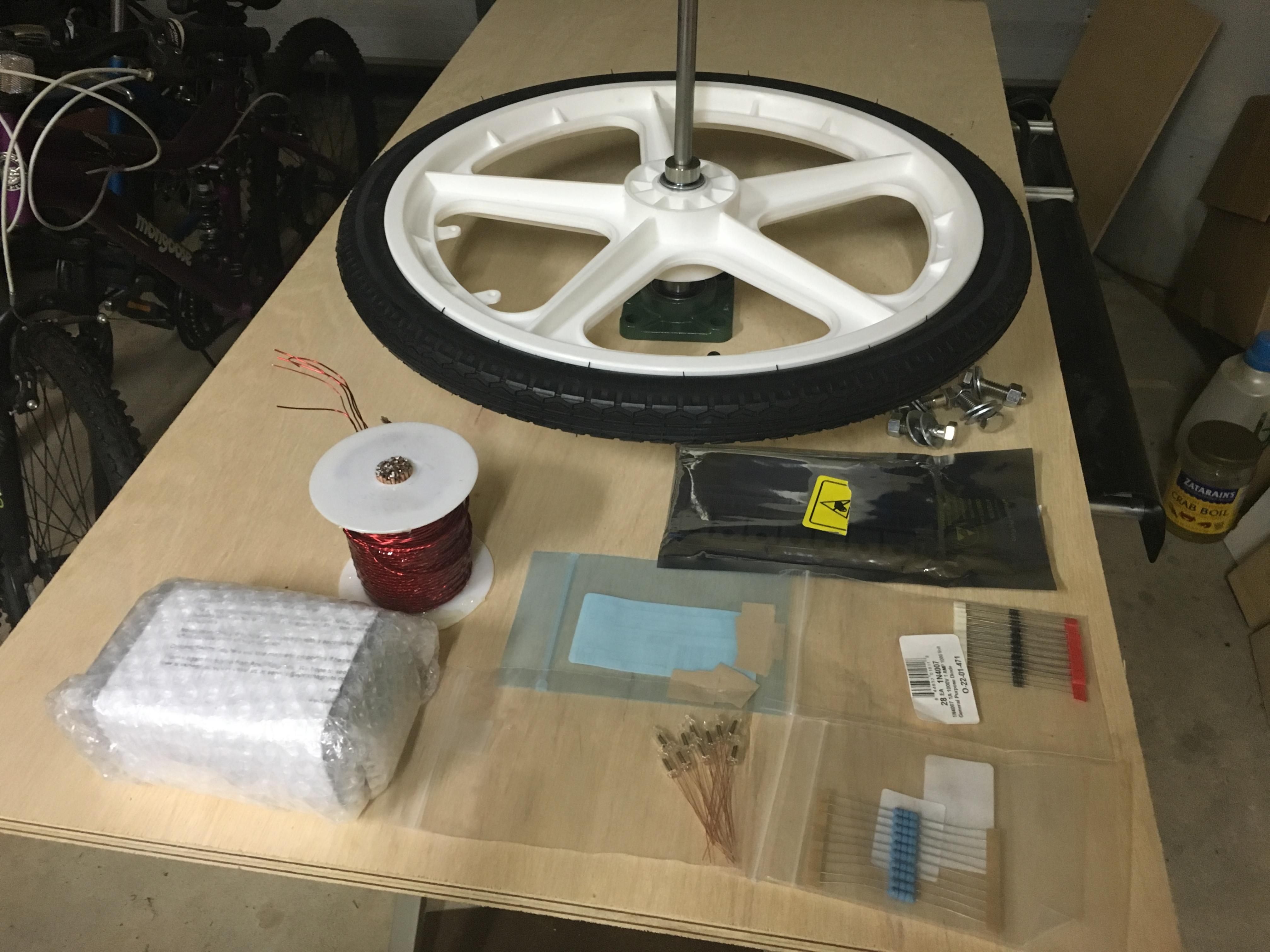

Name:	Bedini SG Parts.jpg
    Note: I know I have to remove the tire from the wheel. Just haven't done it yet.

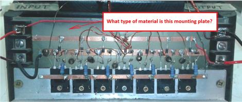

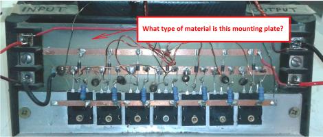

    The first question I have at this time is what material to use for the mounting plate? (see image below)
Name:	Bedini SG Wiring Diagram with Question.jpg
    My second question is what is the best method for fastening the ceramic magnets to the plastic wheel?
    I will likely have more questions to follow as I begin assembling my Bedini.

    In regard to mounting plate material, it is best to use something that in non-magnetic. I have used wood, HDPE (high density polyethylene cutting boards that I plastic-welded together), perf-board, acrylic sheeting with solvent glue, etc Look around the site for ideas, and come up with something that works for you. I try to remain "creative" when building these devices, as I have an affinity towards form+function being true art.
    In regard to fastening the magnets to the wheel, it depends on what the wheel is made out of. If the material it is made of is HDPE, nothing really sticks to it, so one must be creative. Usually with most plastic (and aluminium) wheels, one can just use a good "super glue" and then make sure to wrap the magnets (around the circumference of the wheel) with strapping tape that has embedded fiber strands. This should keep the magnets from flying off, and destroying things. Also, after you place the magnets, and strapping, you need to take special care to balance the wheel. I usually use small stick-on wheel weights (placed on the inside facing wall of the rim, so the centrifugal force keeps them stuck on), meant for performance automotive wheels, that I procure from a local tire company--though one could use screws, or any number of things to balance the wheel.
