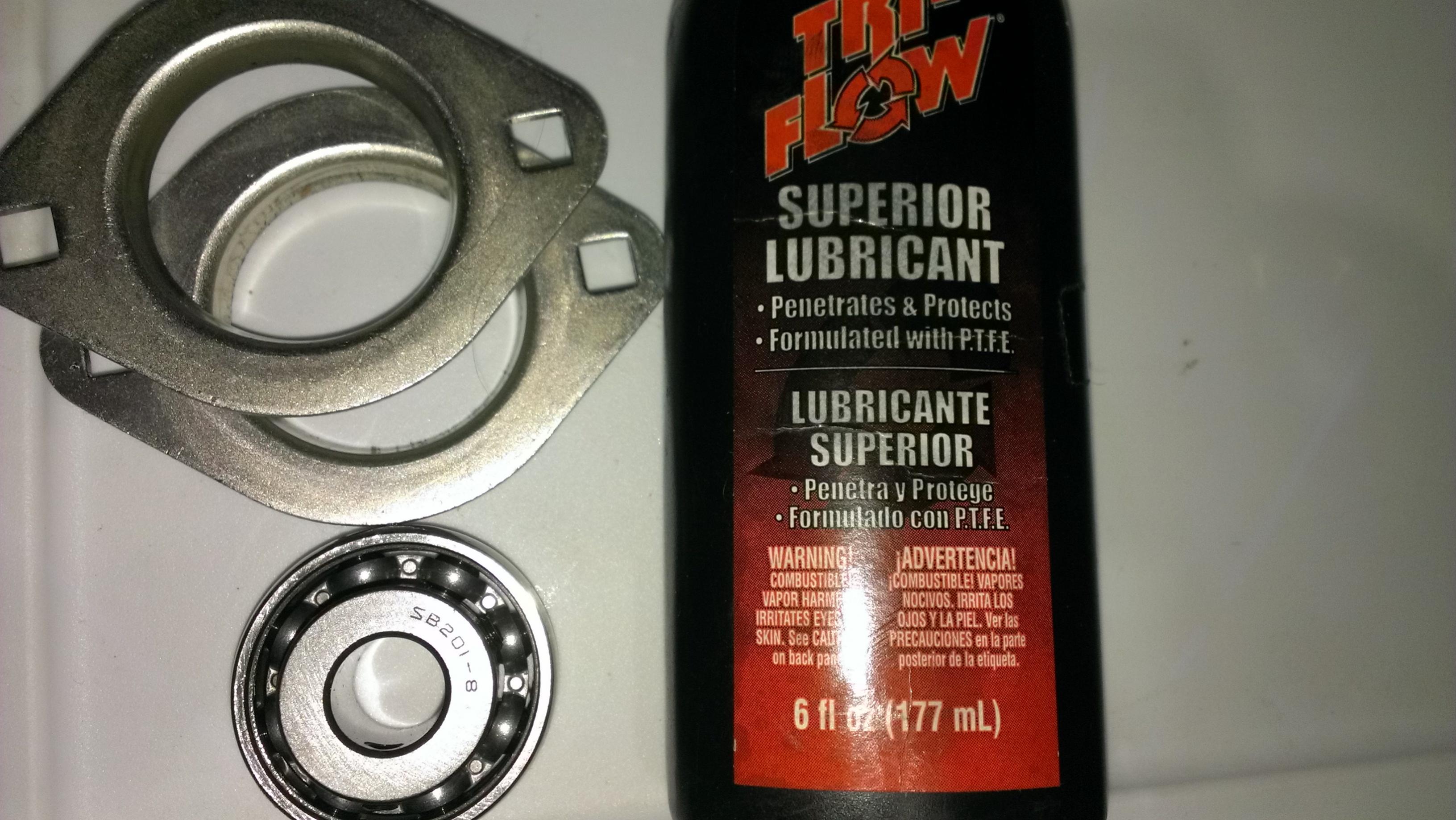

    I wanted to see what others are using for their drive systems these days, bearings, lube or shafts & mounting hardware, these types of things. A few years ago everyone was raving about Tri-flow and that is still what I use actually. I don't ask because I am unhappy with Tri-flow but I think everyone could benefit from a little cross talk on what they prefer.
    I have 1/2 inch axle's on my machines so I use big mounted bearings ( link below) These come packed with lithium grease and pressed on covers so the first thing I do is pull those off and clean all the grease out. Sometimes I use kerosene and other times I have used brake cleaner to get the grease out and then I lube them with Tri-Flow.
