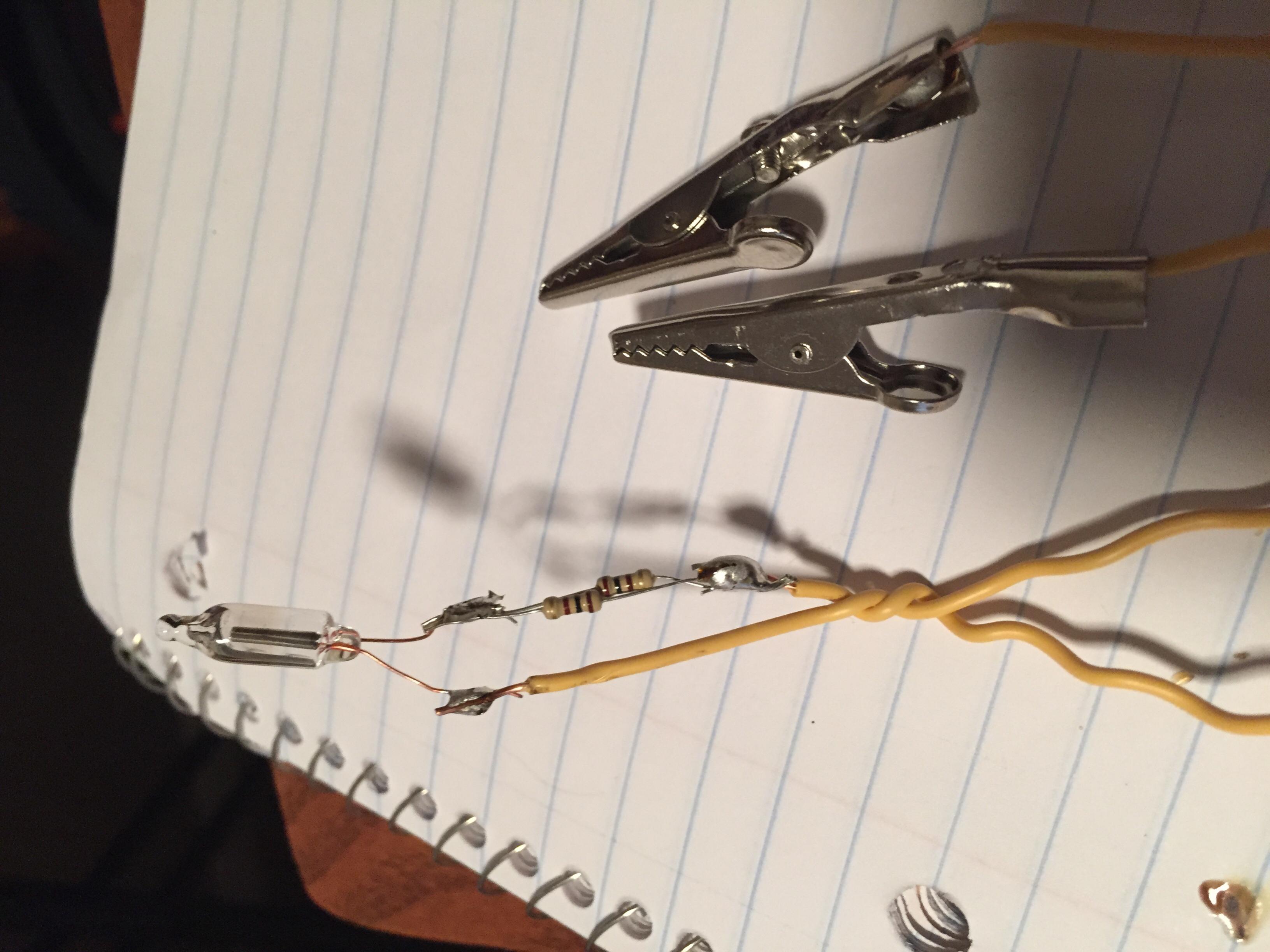

ok do I'm trying to make the timing light according to this post

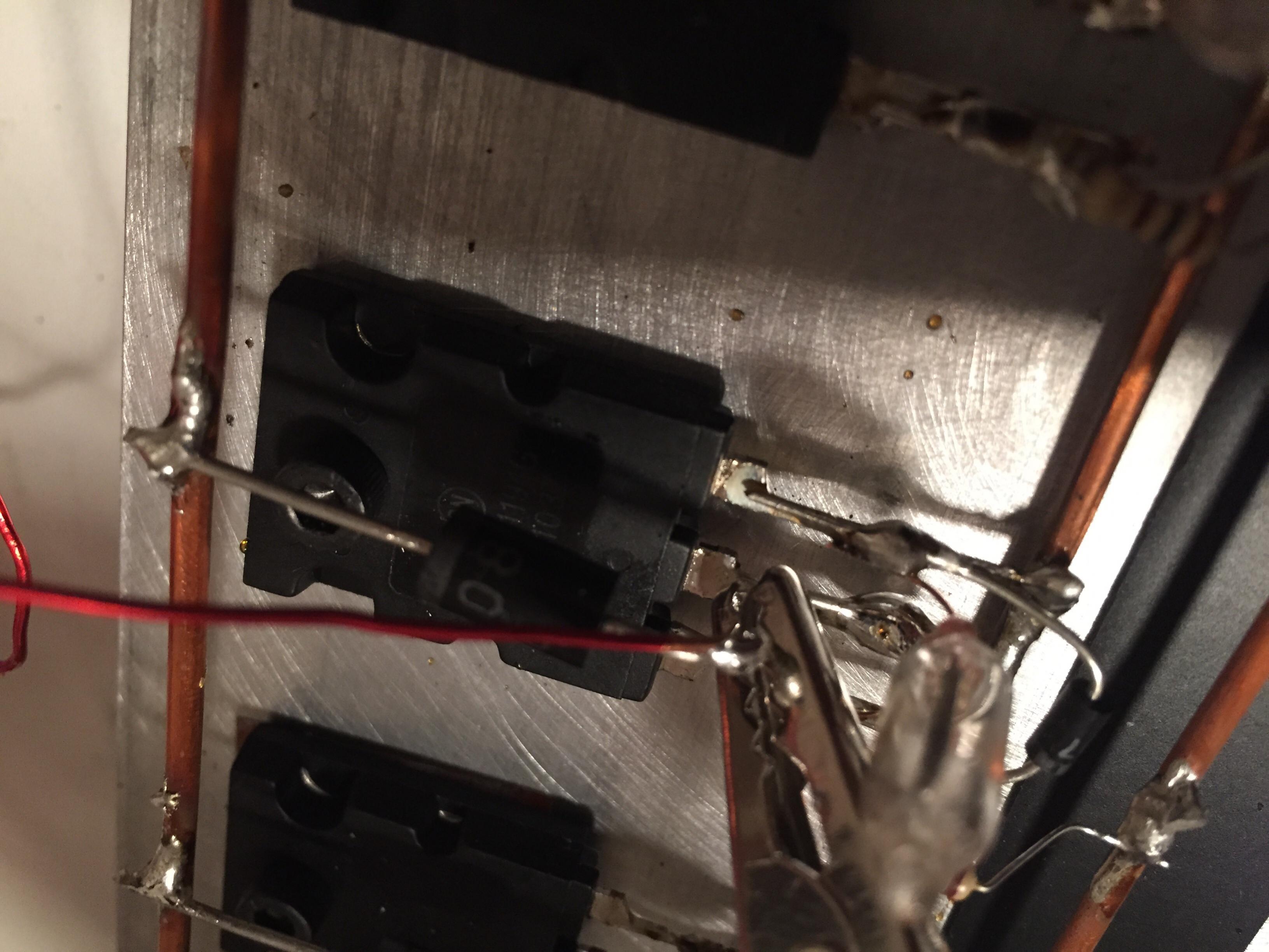

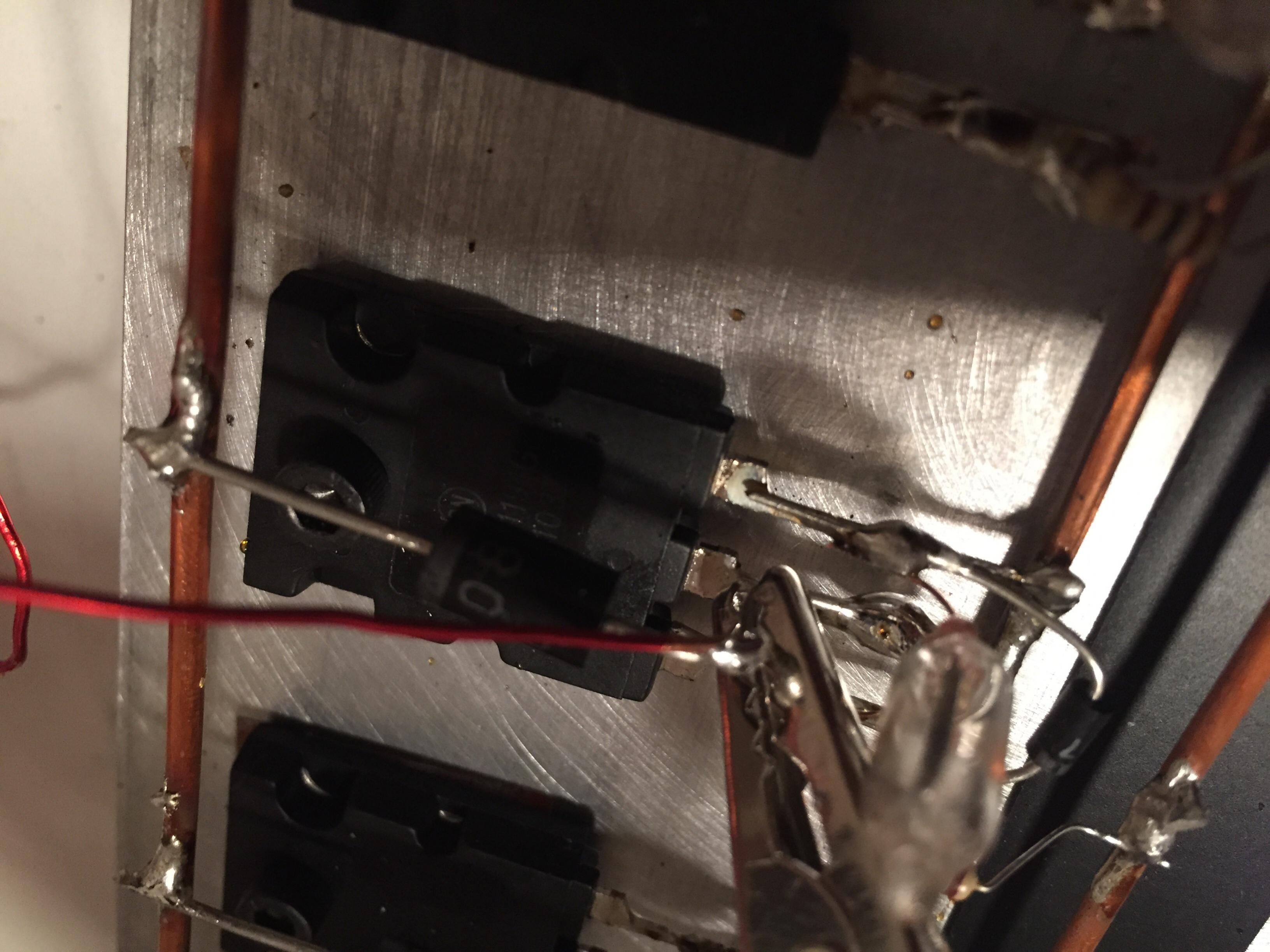

Get yourself an LED and connect a 300 Ohm resistor to one leg of it. Add some leads, gator clips work good for this. Connect one side to your primary positive and the other side to the junction where the power wind connects to the board which is at the output diode but not the rectified side of it. The output diode which is connected to the collector right where the coil end connects.
Put a white mark in the center of one of your magnets that you can point the LED at and this will be a simple timing light. Mount the LED on your coil in line with the center core. You will be watching when the coil is firing in relation to the core of your coil. When connected one way it will show you the ON period and if you switch the leads around it will show you the OFF period or the spike side so to say. As you adjust you will see more and less firings of the coil and the position where the mark shows up will change. Play around with that a bit and see what you can observe.

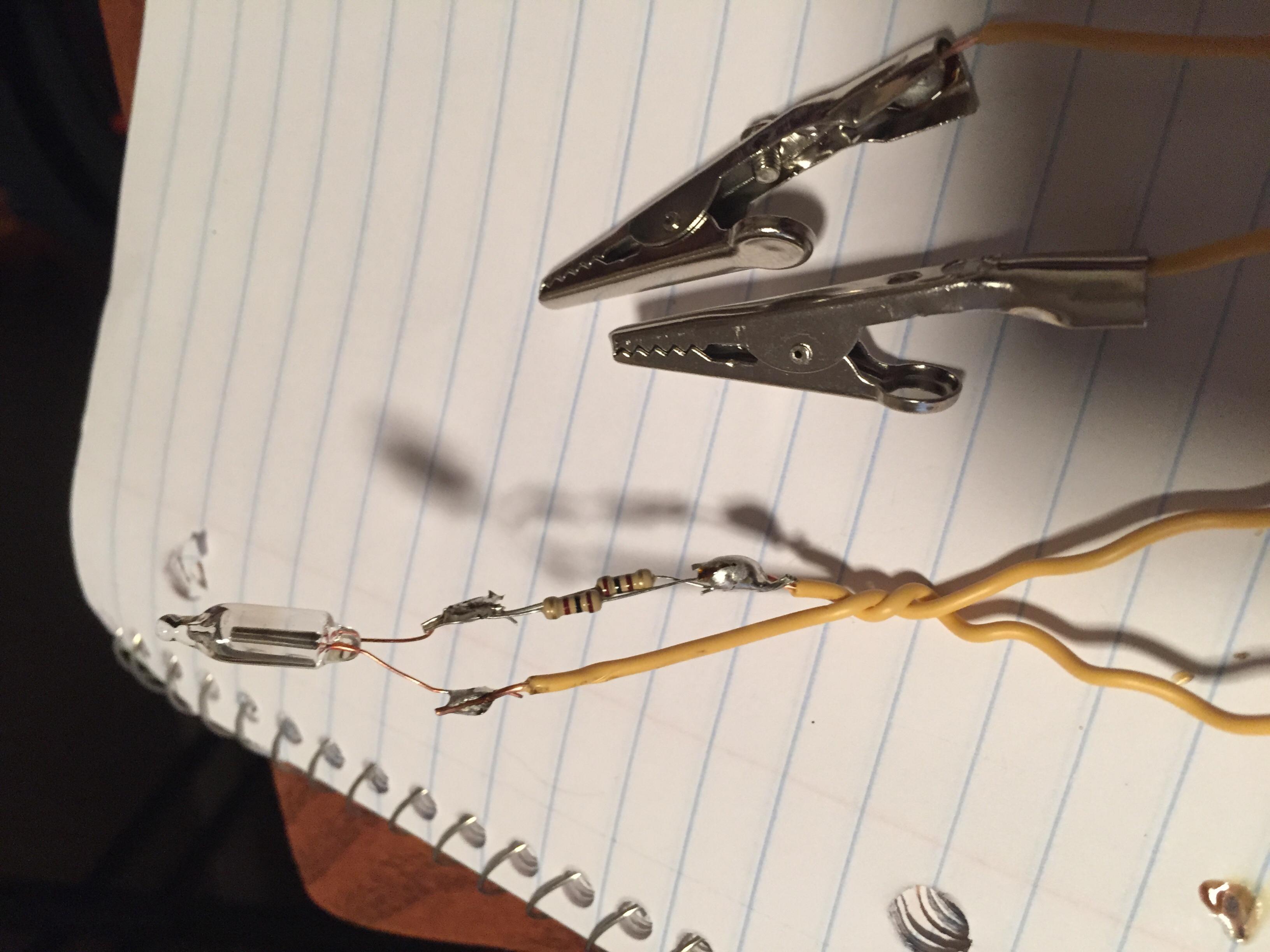

I used a 470 ohm resistor first and the LED wouldn't light so I tried three 100 ohm resistors and still nothing. The LED won't light even if I use no resistors and hold it straight onto a 12 volt battery. I may be exposing my ignorance here but what am I missing?
